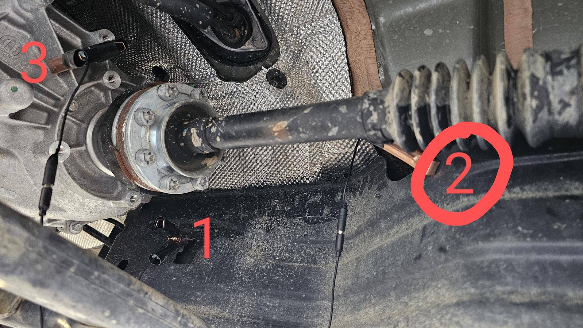

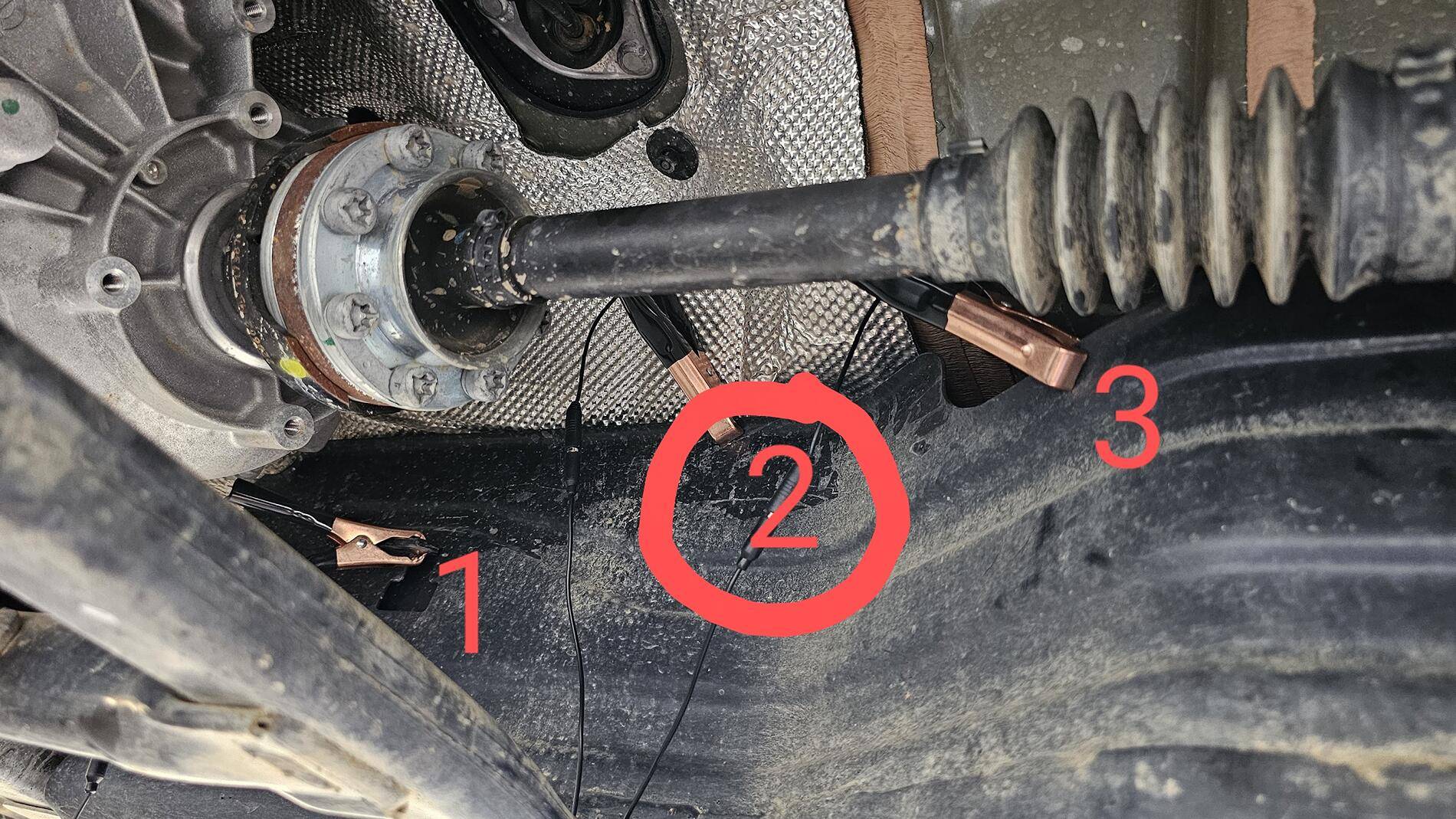

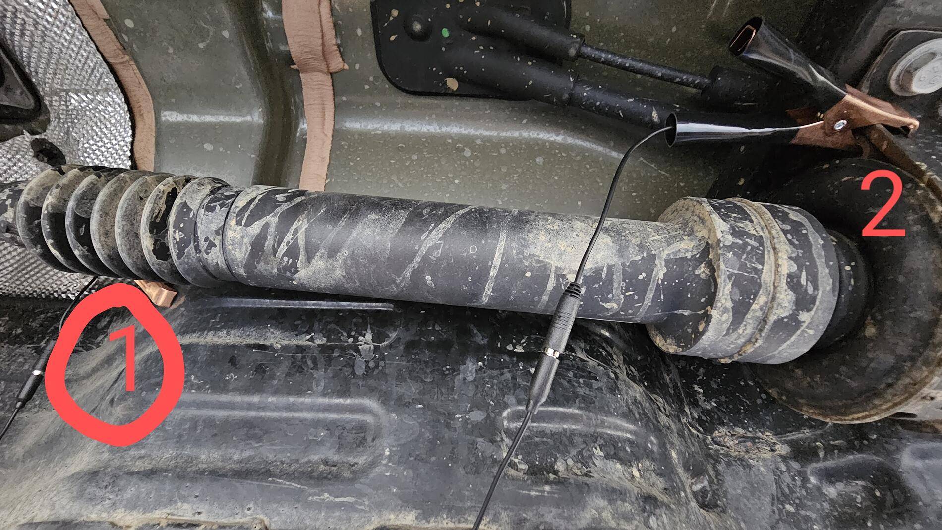

UPDATE - I took mine in for the clutch recall and let them know that the noise in the drivetrain was getting progressively worse and wanted that looked at, too. A couple of weeks ago I put some chassis ears all over the underside of my rig and quickly ruled out any suspension issues - ball joints, bushings, etc.
I was perplexed because I narrowed it down to this location (circled in red) in multiple configurations of the chassis ears:
Jeep Gladiator Yes, yet another grinding/clunking noise thread 1730418273145-qc
Jeep Gladiator Yes, yet another grinding/clunking noise thread 1730418244504-f6
Jeep Gladiator Yes, yet another grinding/clunking noise thread 1730418336968-60
Obviously you can't attach these ears directly to any moving parts, but I was convinced that something under that driveshaft boot was loose/playing although I could not for the life of me figure out how.
So, I spoke to the service manager and told him about the pics so I could help him diagnose and he kind of brushed me off which sort of pissed me off. Oh well, it's on them now.
I get a call last night that the clutch is done, but they can't remount the transmission crossmember because 2 of the washers for the bolts that hold the crossmember onto the frame are missing - like, gone - so they have to order the bolts/washers. Then I get a call later "Good news - those bolts are included in the kit from MOPAR for the clutch recall, so we can finish it tonight". I asked about the noise and they had no answer for me.
I get a text this AM - everything is fixed. I anticipated that the noise was unaddressed, but to my surprise, the noise was diagnosed as being caused by those missing washers and the tech noticed them before they even started the clutch work - the crossmember was just loose enough that it allowed play in the fuel tank skid plate against the frame. EXACTLY where my noisiest chassis ear is identified in the above pictures.

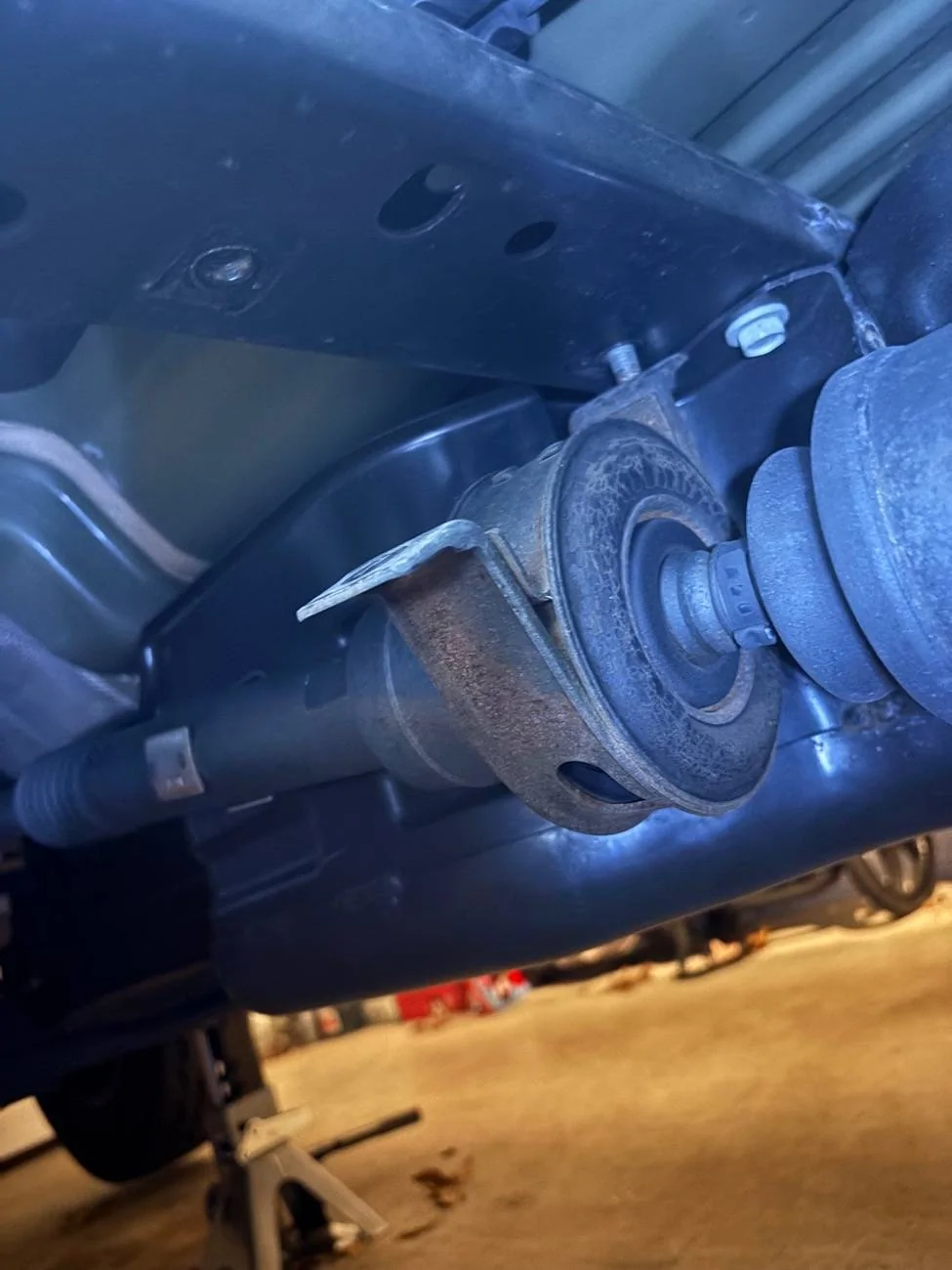

Had a very similar issue, the tech did not torque crossmember bolts to the spec after replacing the clutch. One fell out other was very loose. Started with a faint knocking noise which I figured was probably worn pads, then all out the sudden loud clank and grinding noise while driving back home yesterday evening… found some spare bolts in the tool box and retightened, all good now. Never will trust the dealer again 😤

That's your drive shaft carrier bearing, that could of been real bad at freeway speeds. Just imagine that coming completely loose and dropping down. Major carnage at the very least, not to mention the possibility of dismemberment or loss of life...scary shit for sure.
Glad you found it before it got worse.
