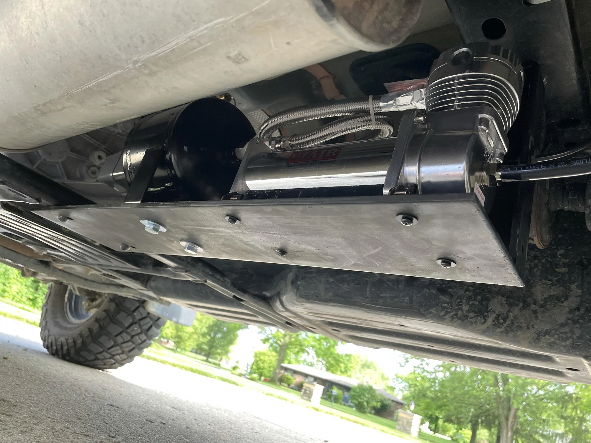

I built a skid/mount for my compressor and tank under the body. Drivers side, beside the muffler, between the exhaust and driveshaft. Mounts to the skid crossmember and then up to a open bolt hole in the frame. My setup only has a very small tank, as it also fits the compressor. With JUST the tank, I am sure a long/skinny 5-gallon would fit.

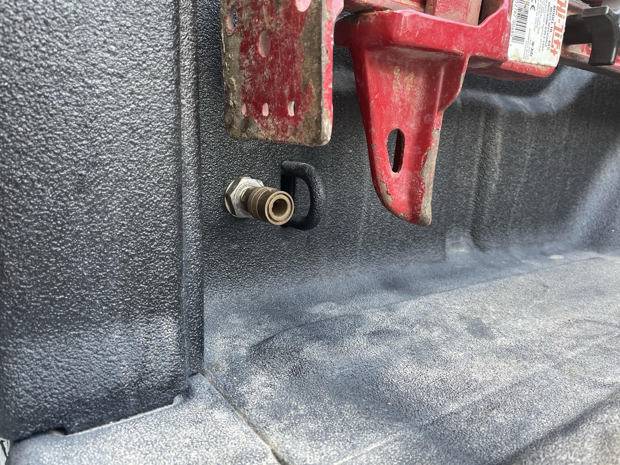

Air intake is routed up between the bedside panels just below the gas cap. Outlet is plumbed into a hole in the bed near the tailgate that was already the perfect size for the bulkhead fitting.

Nice! I've been looking at a set-up for air bags and inflation. That looks perfect. What's that plate, like 1/4x 6" 4"? What compressor are you running?

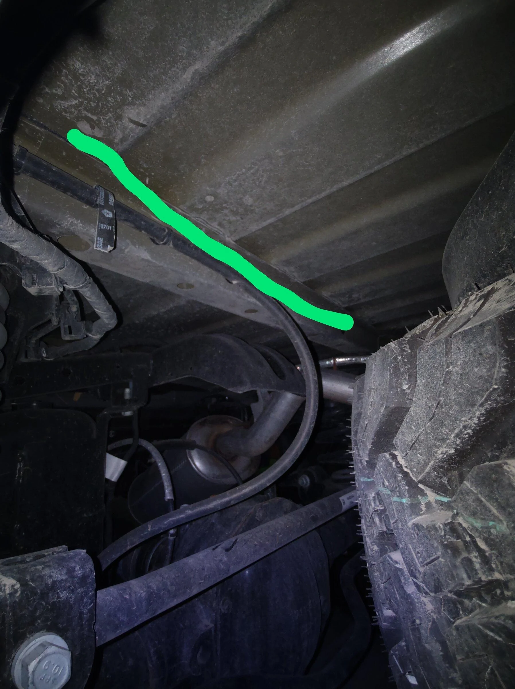

I had thought about here. Above the rear axle. I think I measured out a 8"X 32 or 24 inch spin aluminum tank. Up high. Out of the way. Shouldn't interfere with articulation. Totally protected.
That is a Viair of some sort. One of their 100% duty cycle versions. I watched deals a few places, and found this "previous year" kit on Amazon at a deep discount. Included a 5 gallon tank, but I gave up making it fit. Bought this 1/2 gallon, also from Amazon, pretty cheap. Used all of the hoses and fittings in the Viair kit.
Plate is 3/16" and roughly 6" wide and 24" long, give or take. Spans from just ahead of of the factory skid cross member, that happens to have two bolt holes in a nearly perfect spot, back to directly below another factory bolt hole in the frame towards the rear of the cab. I used a piece of angle to create the bracket from the plate to the frame. So, this is mounted at 3 points. I've smacked this into the ground and a few rocks. Other than scuffing the paint, no issues. Actually gives a little extra protection to the driveshaft and muffler.
Just used it today, actually. Low tire warning on my wife's JK, thanks to the cold weather. I didn't even have to open the garage.
