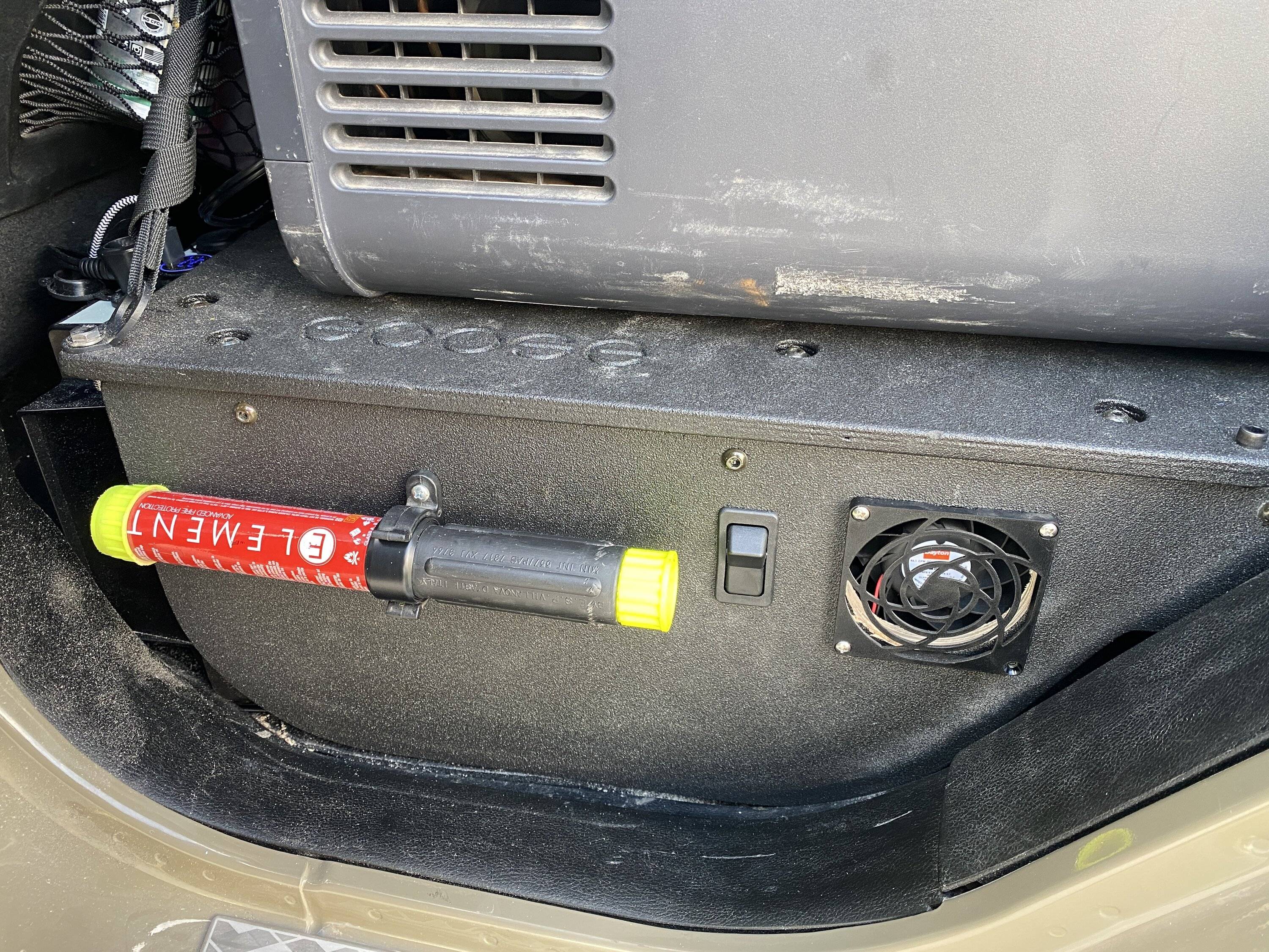

First, we added a fan to the side of our platform to evacuate hot air created by the dcdc and the 12v to 48v convertor when needed.

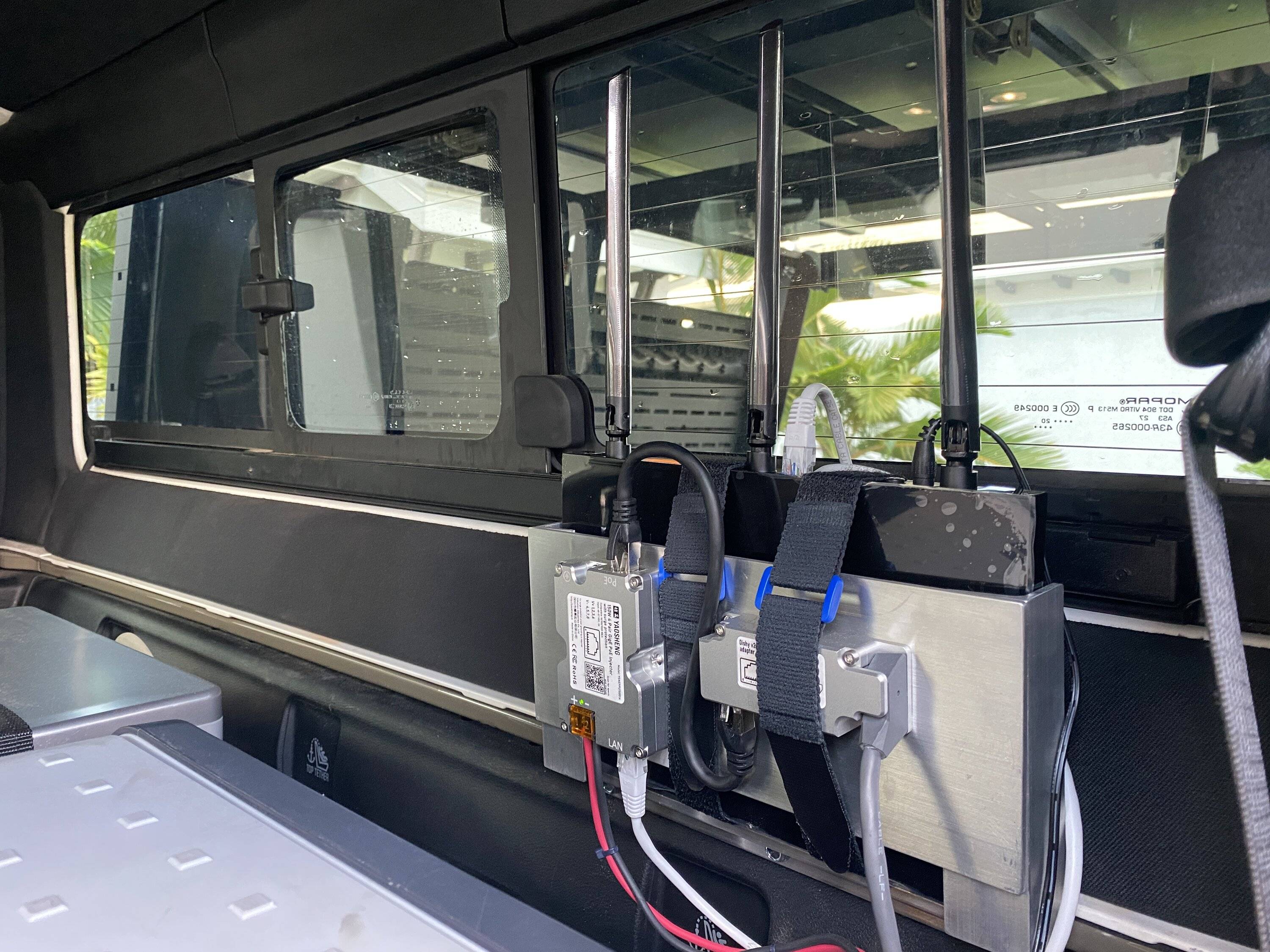

The cable adapter and poe injector with the router. The 12v to 48v convertor lives under the platform.

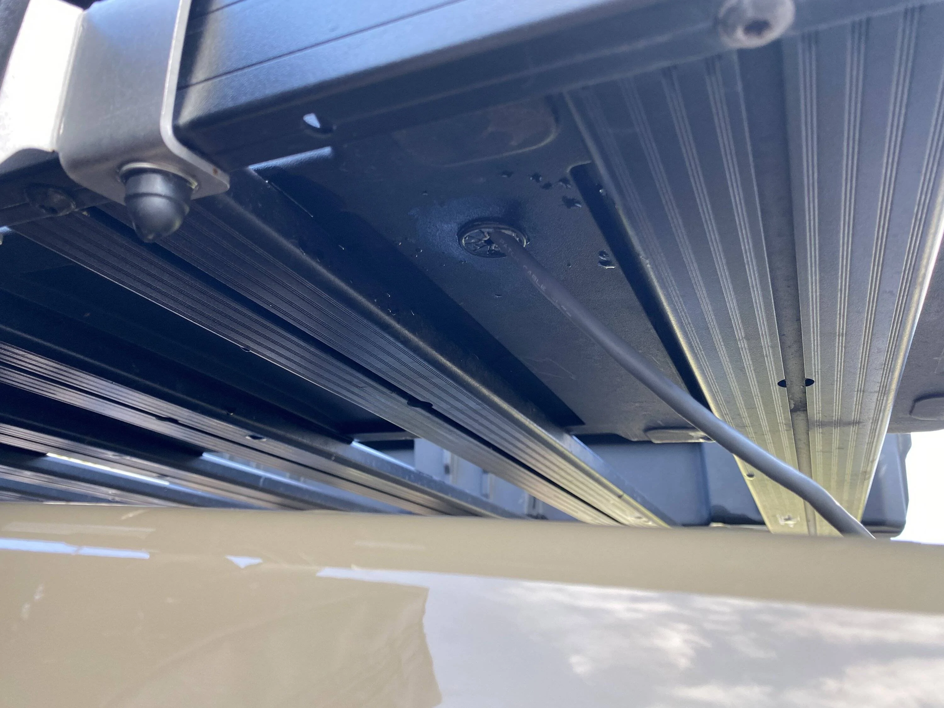

We drilled a hole in the floor and led the Starlink cable along the bed rack but had to run it over to the roof rack at one point.

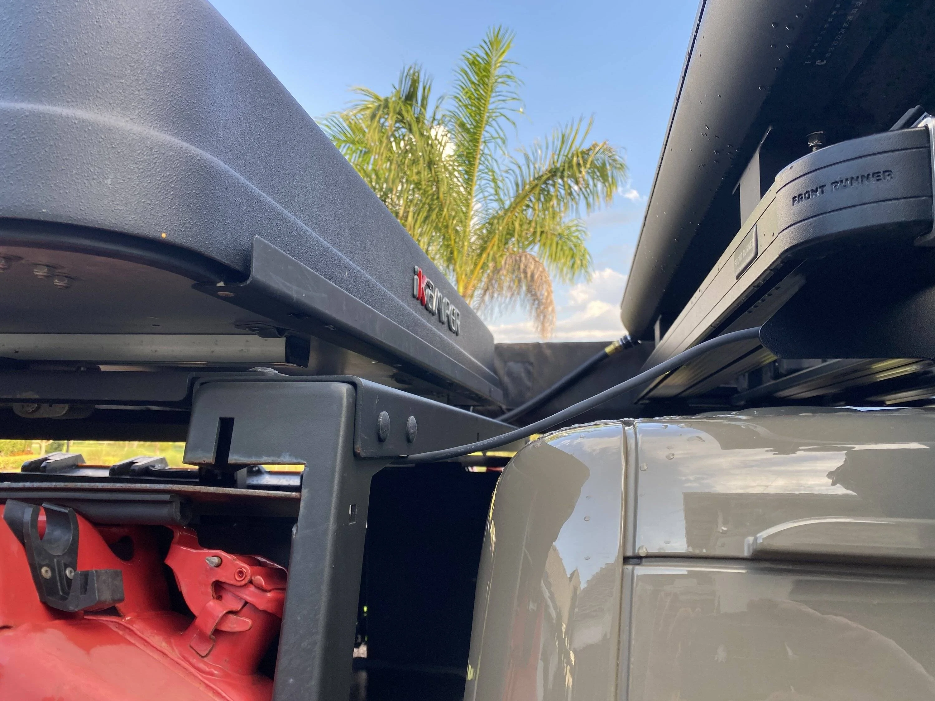

We drilled two holes in the box to allow the Starlink cable to enter and exit. The excess cable is stored in the box in case we need to move the Starlink away from the Jeep to get connectivity.

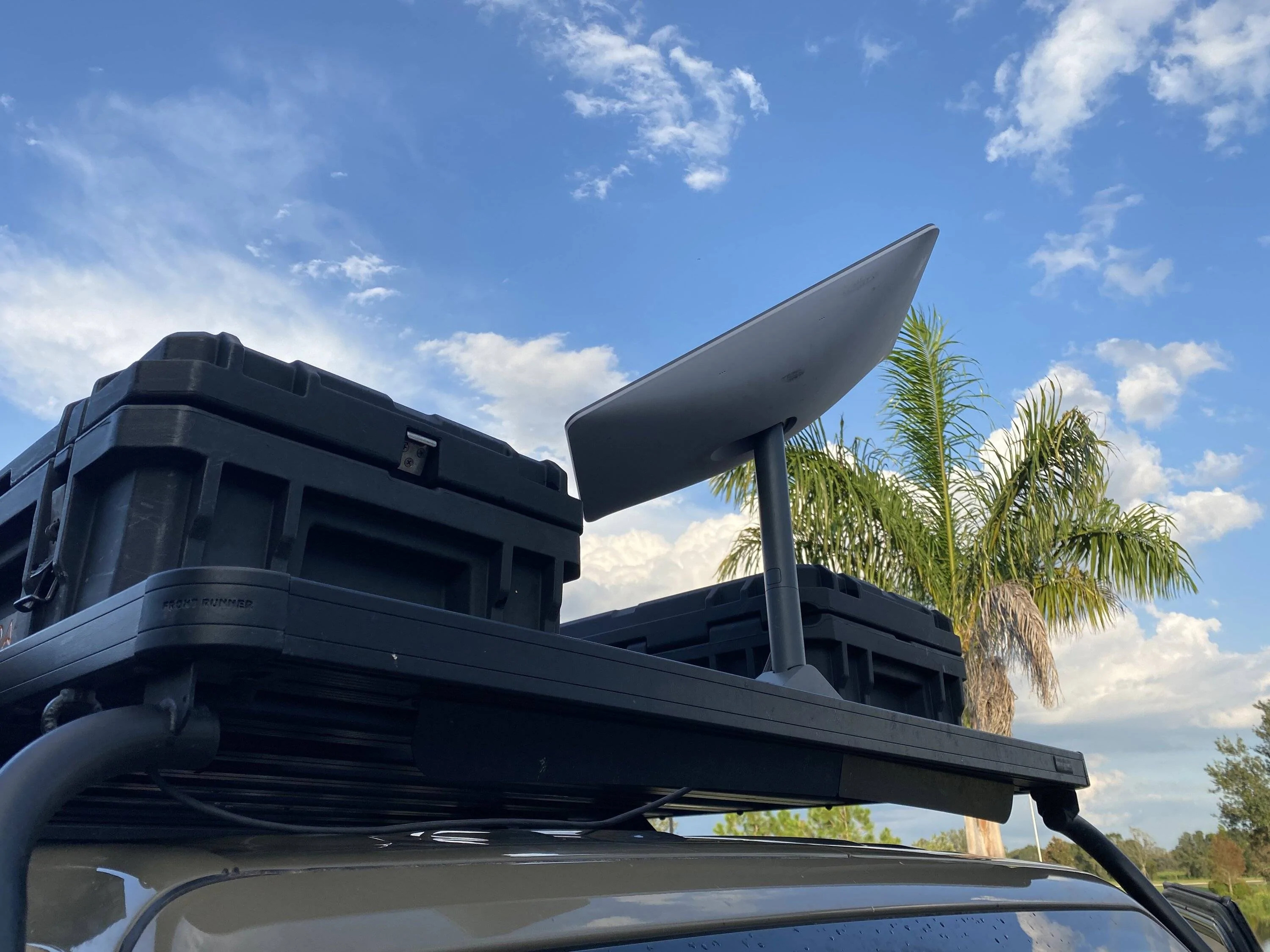

The Starlink dish lives in the box when traveling. I attach it to the mount on the roof rack if we are not obstructed. It has a stand and a pretty long cable to move it to a better area if needed.
