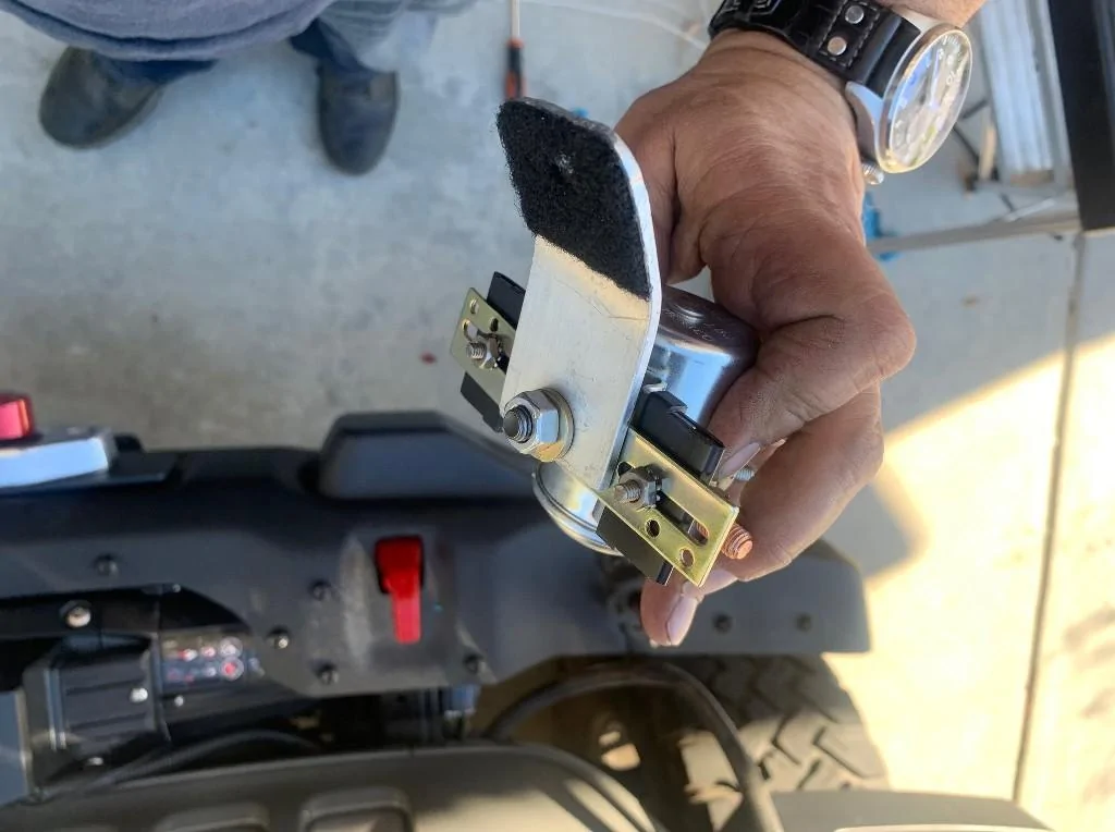

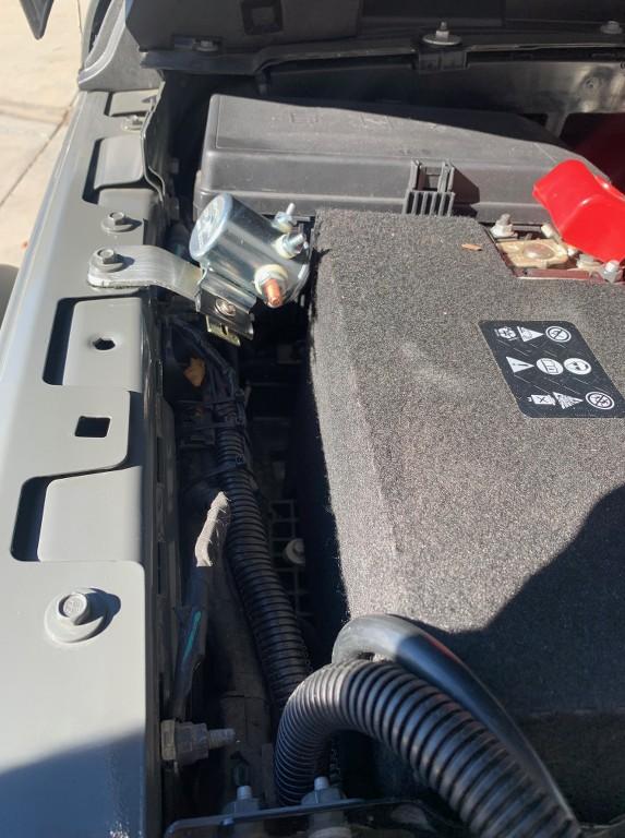

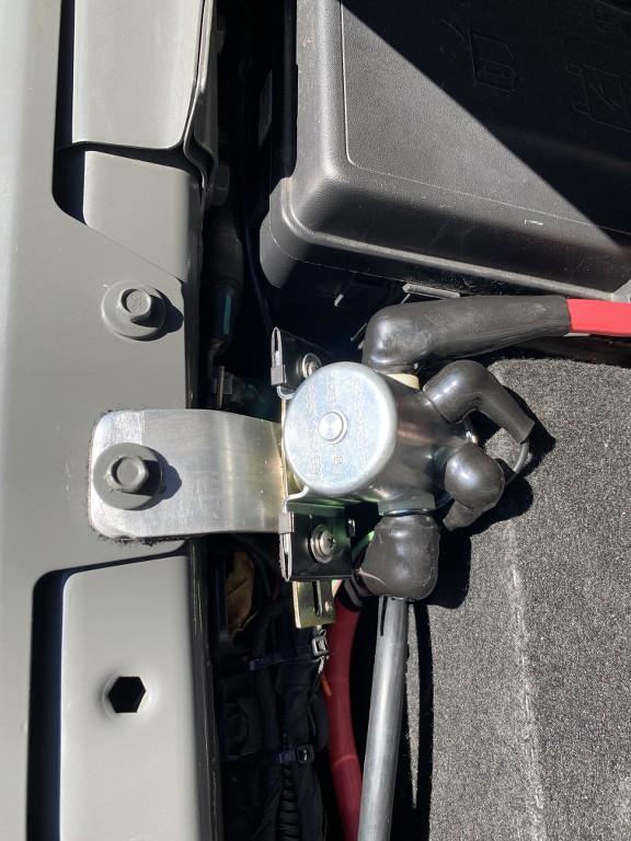

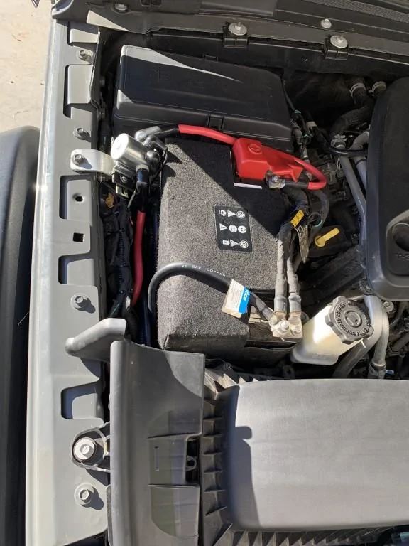

I did this with my warn winch, using the warn switch solenoid kit. I use the aux switch to route power when I need the winch, thus, avoiding all that power running down those huge cables all the time, ie. in case of an accident.... I only had to make my own bracket. Here are some pics:
