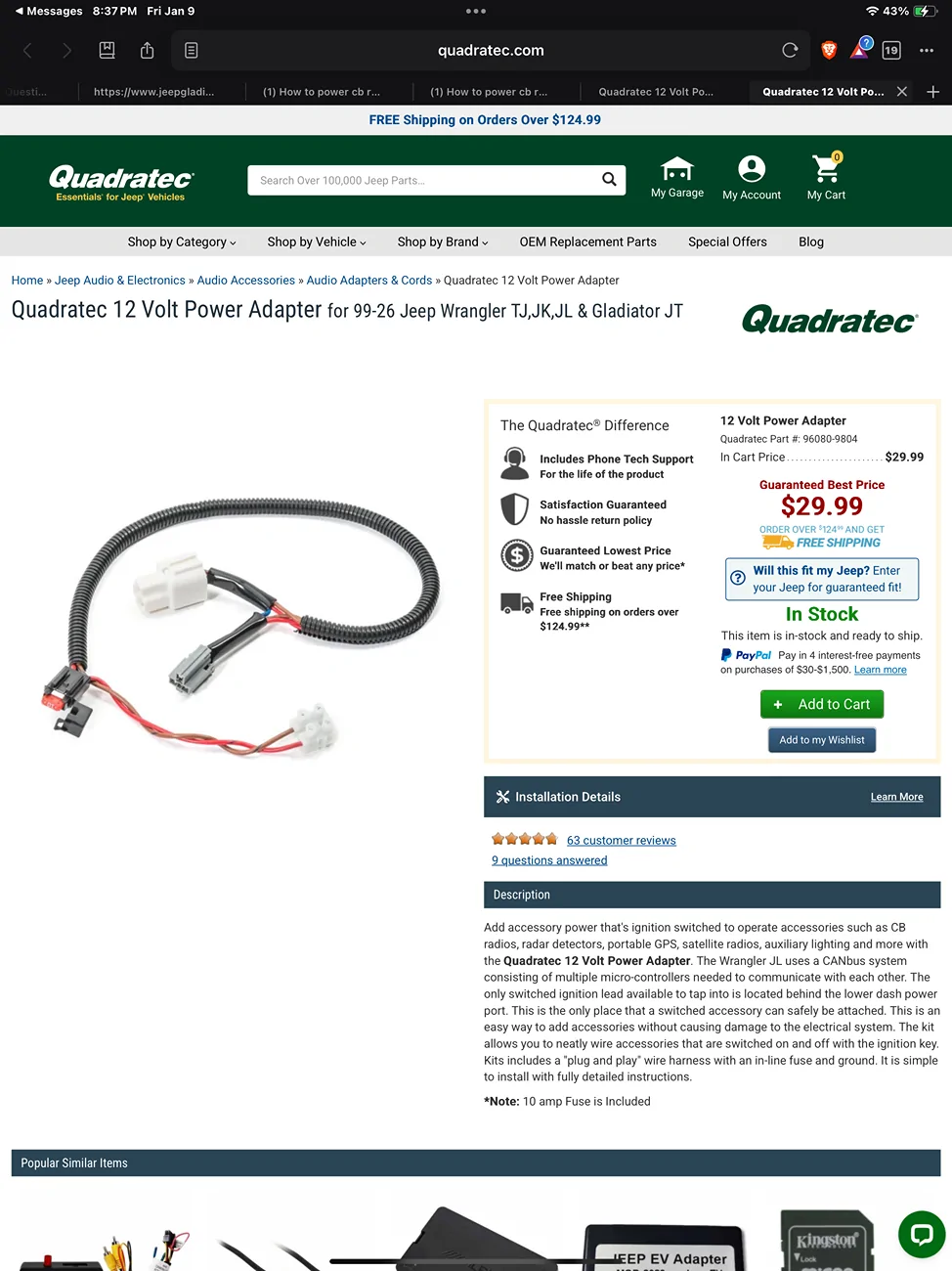

I was considering ordering this to wire the cb to the 12v outlet. Any ideas would be greatly appreciate.
Jeep Gladiator How to power CB radio without aux battery drain IMG_5170
Jeepmonster
Jun 1, 2020
494
1,516
Socal
2020 JTR, 1968 Chevy C10
That's what I use, and it works perfect for my Midland GMRS radio and dash cam. I tucked the terminal strip near the side of the glove box.

I use the cigarette port for my Midland 275. I can't hardwire it because it moves between 2 vehicles. Otherwise I would hardware to my AUX switch.

Ok first things first, I'm confused by what you state the dealer has told you. My assumption is they explained it poorly to you, and without getting into the details I'll just say you have a bad AUX battery and it needs to be replaced before you worry about your radio. It's probably not completely shot yet, but it's close. When you have a bad AUX battery it will drain your main battery which will either leave you stranded or cause all sorts of strange electrical issues, or both. So my first recommendation is replace the AUX battery as soon as you can because it's only a matter of time before you will start having issues again. Disabling ESS is only a band aid fix masking the real problem, a bad/dying AUX battery.
Secondly, the simple answer is yes you can use that harness.
A more involved answer for anyone interested, and a better option for those that have a lot of things you need ACC power for; The JT has very little room inside the dash and few ACC power locations especially if you don't have AUX buttons, so I ran a relay triggered lead from the fuse panel/main battery to a 6-fuse 12v accessory fuse panel inside the cab that I use for any inside cab ACC power needs. The power to this aux fuse panel comes straight from the main battery, but is controlled by a relay that is triggered by an ACC circuit. When the truck is powered on, the relay closes and power is supplied to the fuse panel, when the truck is shut off the relay is open and power is shut off to the fuse panel. I currently have my GMRS radio, Wolfbox mirror ACC power, and DC-DC charger trigger running off this panel, and have 3 more slots for future needs.
great advice! Greatly appreciated
