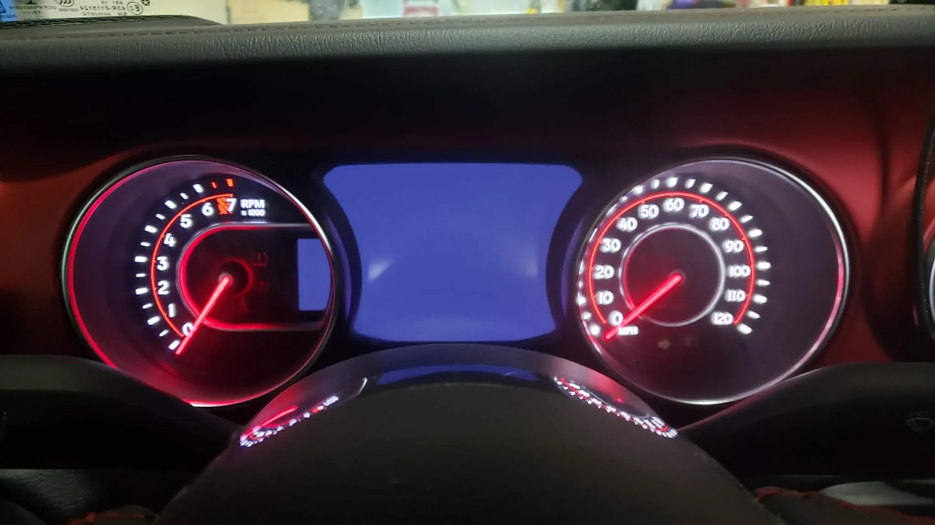

Any chance a "going dead" Aux Battery could cause the Center Instrument Cluster to go dark? About two months ago my Center Instrument Cluster (behind the steering wheel) went dark.
Now I am noticing the Auto Start Stop is not working. For example, my engine has not been shutting off when I'm at a stop light. My daily drive is only about 3 miles, yah 3 miles, and my errands around town are less that 20 minutes at a time... so I just figured the Aux Battery hasn't been getting charged by the alternator?
Fast forward to yesterday, when I drove my JT for 2 hours (nonstop on highway). I couldn't help but notice the Auto Start Stop is working again. Are these two symptoms connected?
Is my Center Instrument Cluster not working because the Aux Battery is going bad?

There is a thread here or the JL forum which shows via oscilloscope that the aux battery is kept connected to the main battery essentially all the time, except for a fraction of a second when ESS restarts the engine. For that small amount of time, the starter is pulling lots of "inrush current", so they disconnect the aux battery during this fraction of a second to prevent the starter from dragging down the electronics, then reconnect it after that power surge has passed. To avoid aux battery problems, those who disconnect the aux battery also disable the ESS system so the engine stays running. If the engine were allowed to stop and restart with the electronics directly connected to the main battery, the electronics may be glitched.
Yes the Aux battery can cause all kinds of chaos. If it is weak then the electronics get a brown out. When troubles appear, replace or bypass the aux battery, but don't leave it be or it will drain the main as well. An early symptom of failure is if it never does engine start/stop at the traffic light, even if you've driven for a while. If it DOES start/stop at a traffic light, the batteries are probably OK for now.
It does take a decent drive time to recharge everything. If you do lots of small drives with ESS active, it drains the main battery for each engine start, and loses the chance to recharge during the stopped time. Double hit. If you turn off ESS then the starter doesn't drain the battery at each stop light, and the batteries can continue to charge instead. If you really like the MPG benefits of engine start stop, then put the vehicle on a charger every week or so.
If you like the aux battery and engine ESS system for MPG benefits, you may want to look at the Genesis battery systems. One of their systems relocates the aux battery above the fuse box for easy replacement. Another uses two mid-sized batteries in the big battery tray, one for main and one for aux. The advantage there is that they are the same size and may last longer, but they are a size which is harder to find locally.
For a CB, GMRS, etc, use the power port, or the wire harness mentioned above, or use the AUX switch leads if available. If the radio does not come with a power port adapter then it may draw too much power for the power port (10A or 15A?), and will require one of the high current AUX lines or a direct relayed battery connection instead The AUX wires are programmable for always on vs ignition on. The AUX switches will be disabled by the computer if the aux battery is weak and needs charging.
