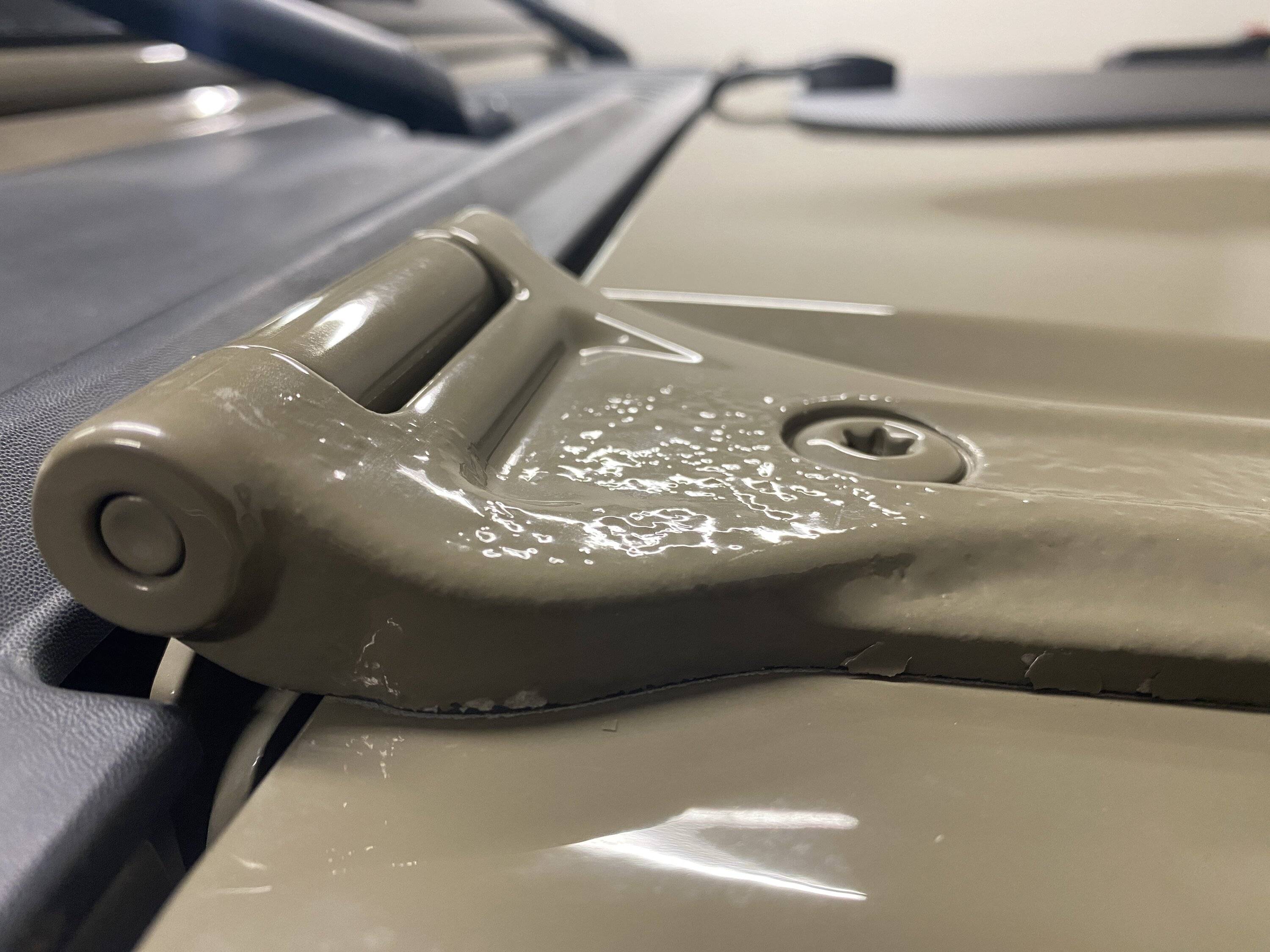

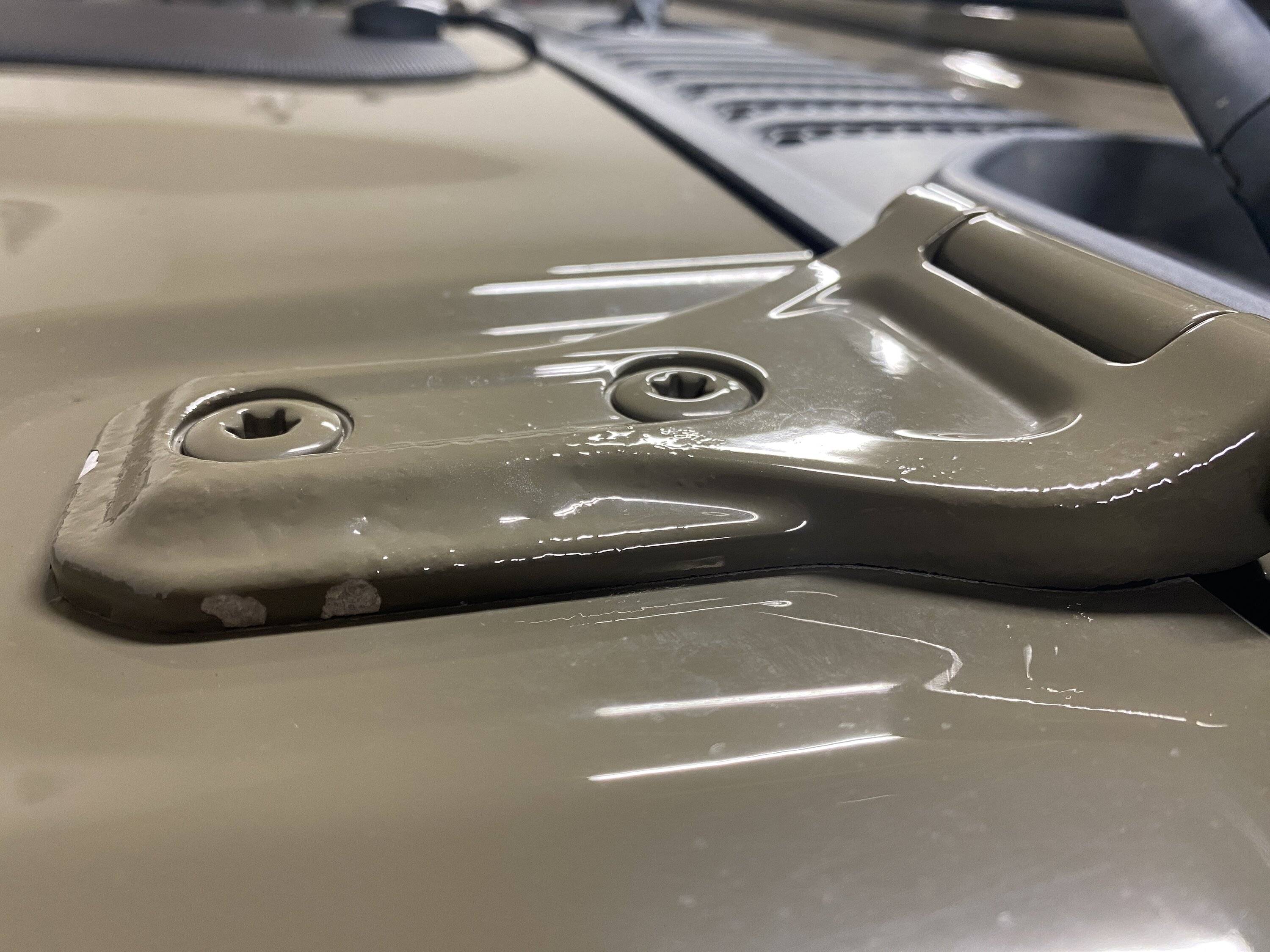

Anyone know if this falls under the 5 years, 100,000 miles rust warranty?
Jeep Gladiator Corrosion on hood hinges IMG_6603
Jeep Gladiator Corrosion on hood hinges IMG_6604

Yes It does. Just find a dealer with a decent body shop. Jeep bought back my 2020 JLUR for excessive corrosion (After a bit of a battle)

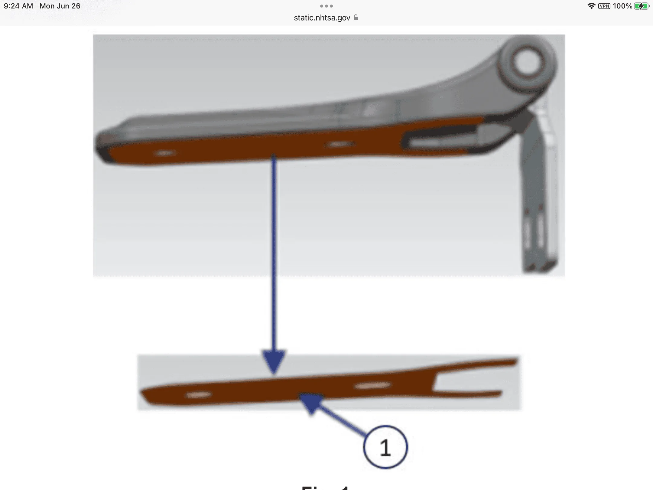

The latest hinge corrosion TSB includes the use of zinc shims behind the hinges which indicates that FCA sees this as a galvanic corrosion issue (or at least an issue with a galvanic corrosion fix).
Jeep Gladiator Corrosion on hood hinges img_1664-png

what years does this TSB cover? is it all MY's or is it just certain ones?
