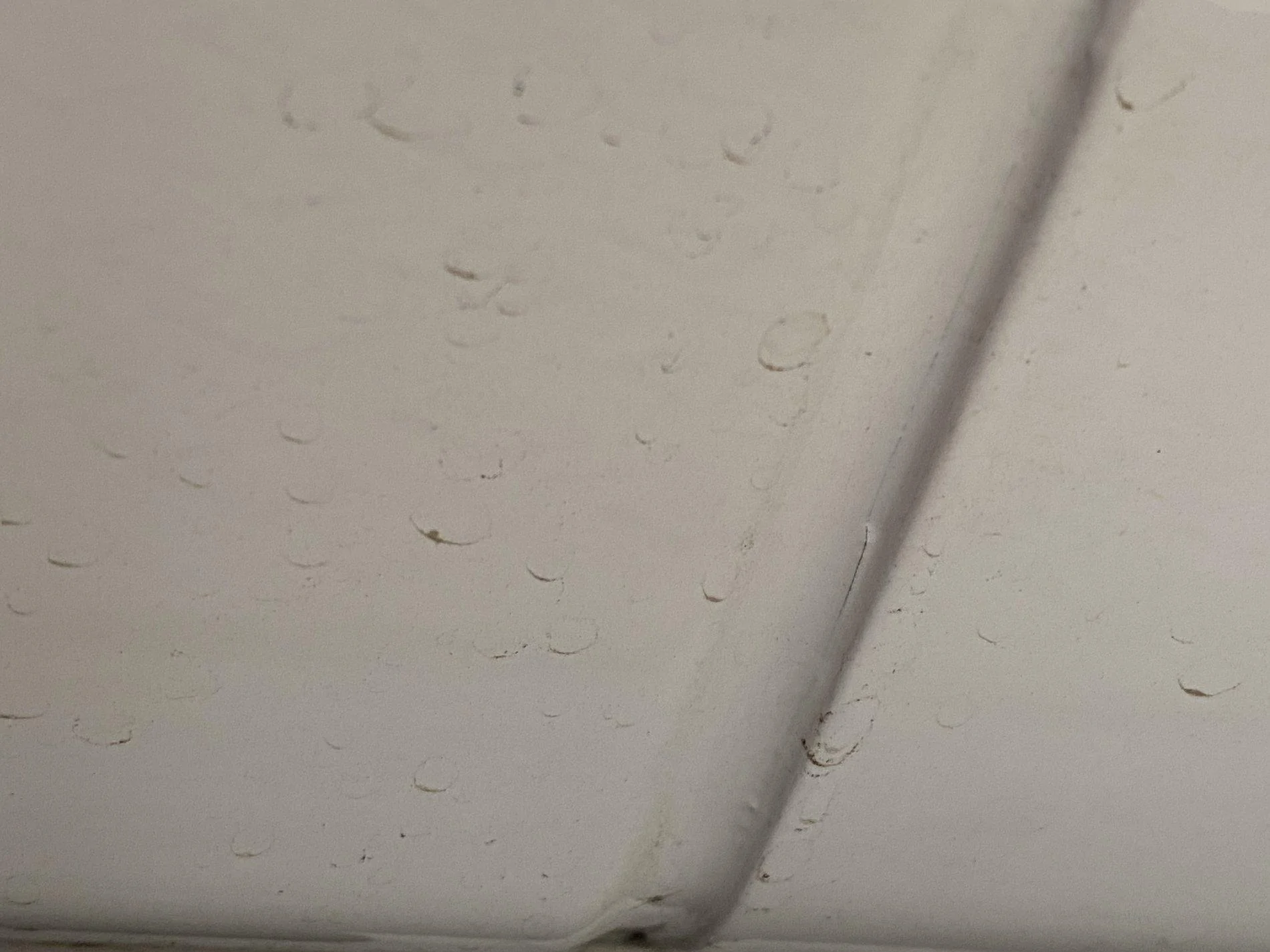

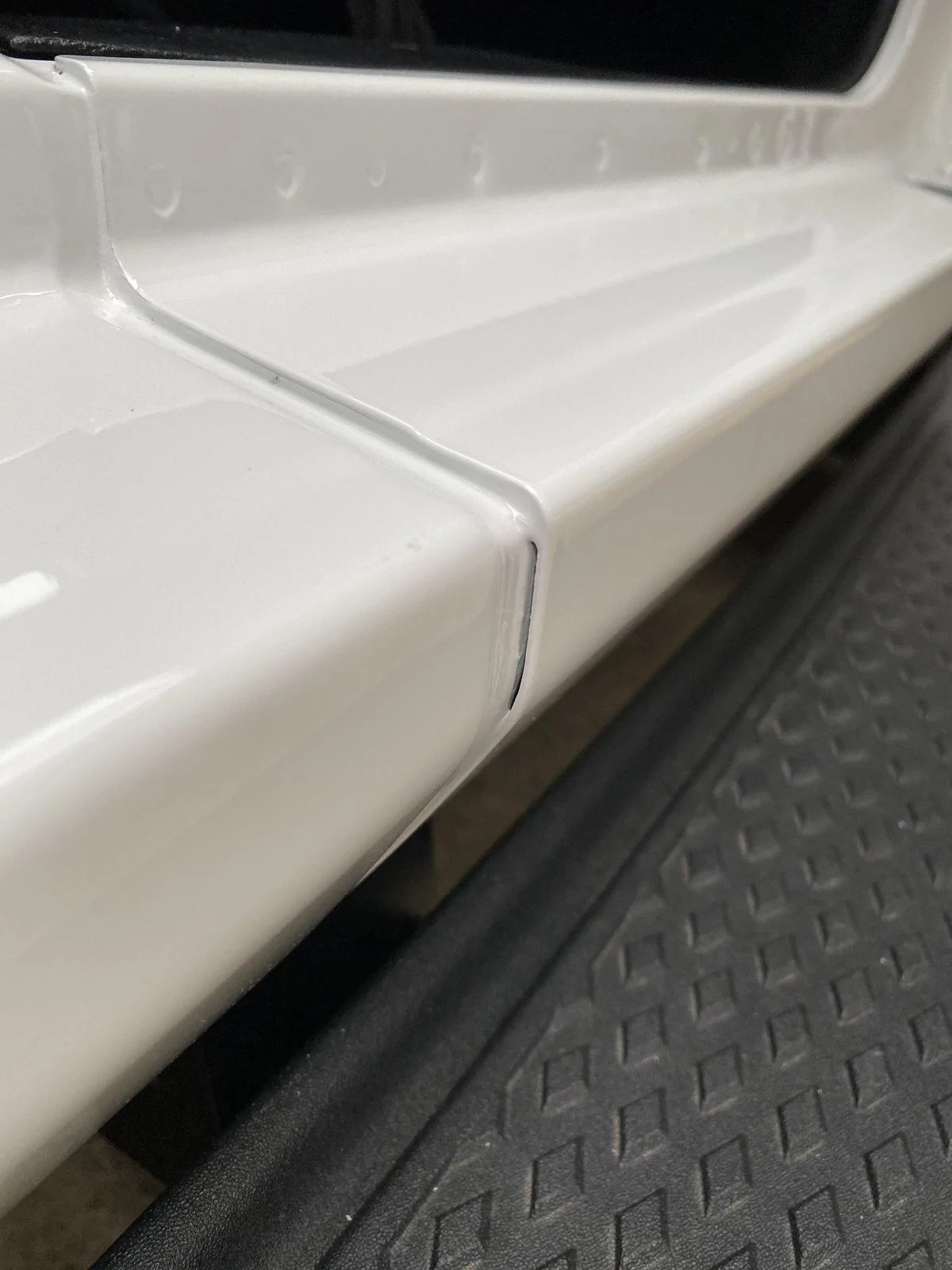

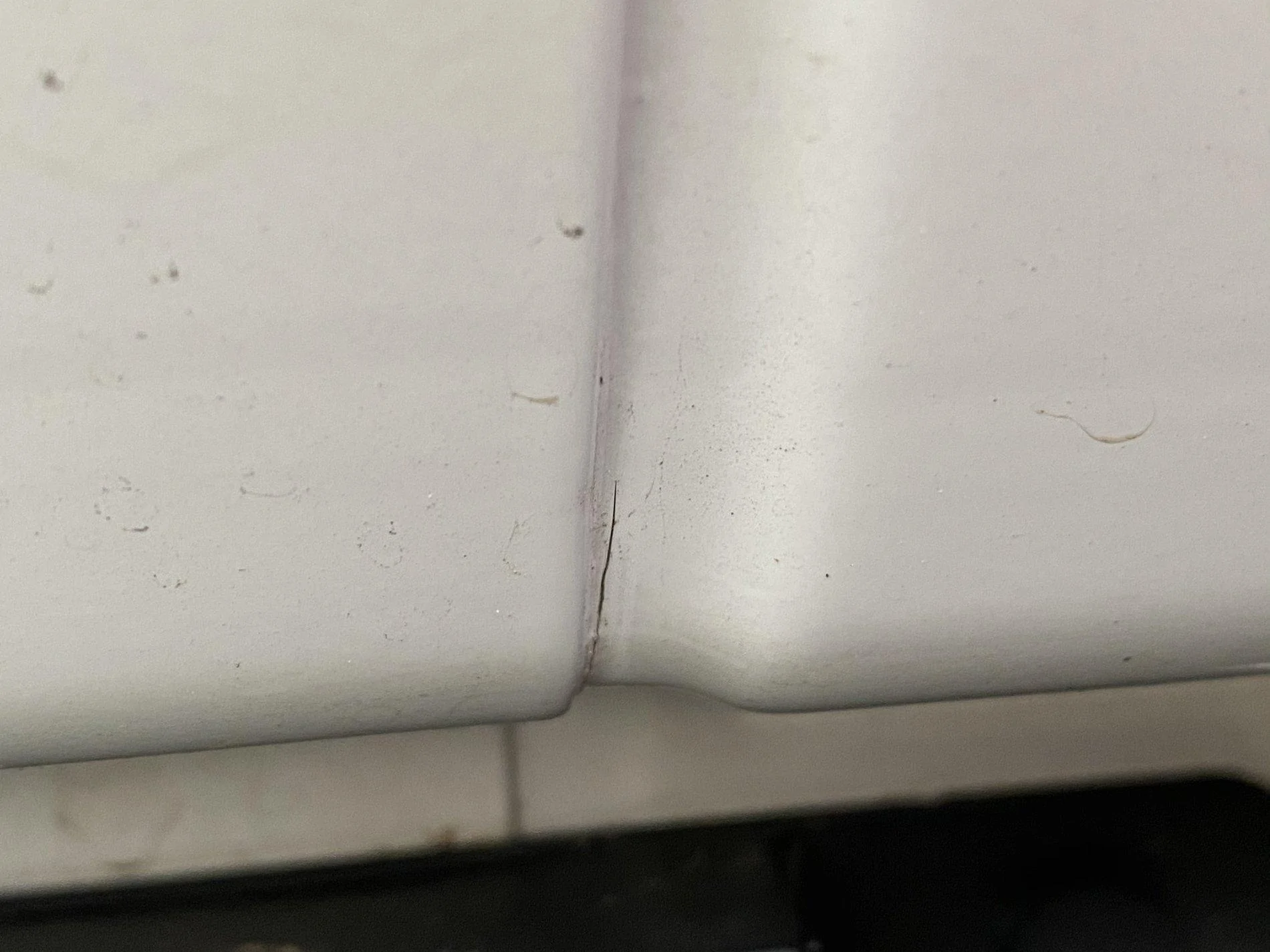

Gladiator is a month old and has these cracks and gaps in the paint. Is this normal or no?

Looks like faulty welds but I’m sure a body guy can chime in.

Looks like the seam sealer (panel bonder) robot was being a little lazy the day yours went through.

Doesn't look body metal related, all those seams are in joints that have paint seal applied after e-coat and before top-coat. Picture #2 looks like application defect, #1 and #3 look like hairline cracks that could be not enough sealer?
I would definitely take to the dealer and have them fix this under warranty. Any water intrusion in the floor sill area in those sealer cracks and you'll have corrosion issues later on. Luckily it doesn't appear to be weld integrity. But let the dealer tell you.

where is that first pic on the vehicle?
