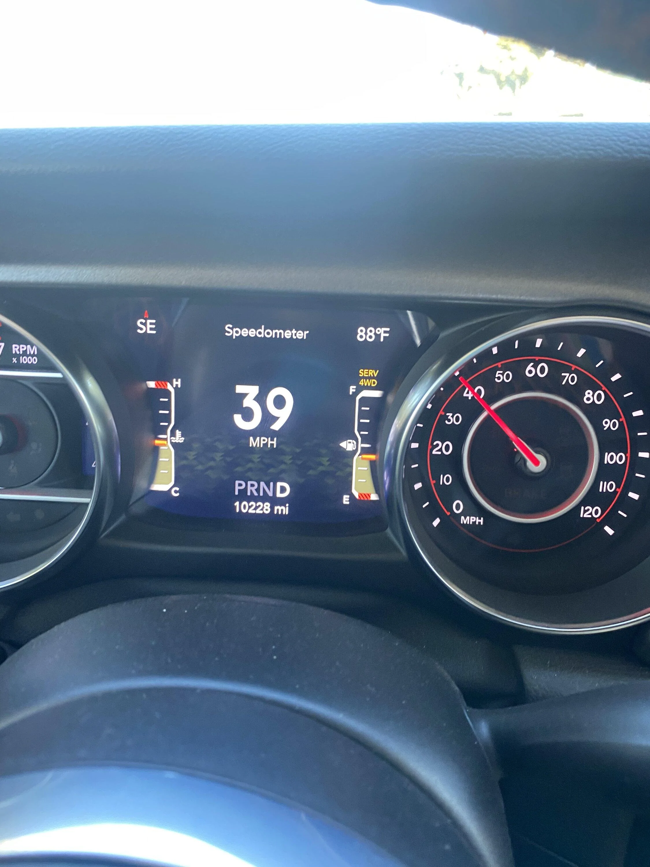

So I just picked up my JT after having Currie Extreme 60’s installed. I used @Superchips_Mrktg to make the following updates; tire size, gears, disabled all lockers, and disabled the FAD. The SERV 4WD light is still on. I made sure the module was up to date, and Rebel said they weren’t sure what else to do. Anyone come across this and have a recommendation?

I did. I unmarried and got ride of the Superchips programmer, replaced it with a Tazer from Z Automotive. Used the exact same settings with the Tazer, no issues. I hear this is pretty common for Superchips. The Tazer is the way to go.
