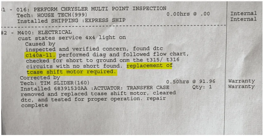

Does not surprise me the tech skipped the troubleshooting steps and went to the bottom and shotgun a part that was incorrect.
I suspected it on my second visit when the new control module didn't solve the problem.
The thing that gets me is that everybody loses when the Tech doesn't do their job properly. I was without my JT for 10 days without a loaner. The dealership had a bay completely tied up for 7 entire working days. The paperwork that they were submitting for warranty work only had a total of about $825, and that included both the new control module and new shift motor. Think of the money that the dealership could have made on paying jobs or even other warranty work being done properly. On top of that, they are giving me a new trim panel (list is like $350, so it must be costing them at least $150).

You have the part number they used? I'm having the same issue in my Rubicon that you were having. I'm not sure the part is shared? I've searched Mopar and the web in general for "2020 Gladiator Rubicon transfer case motor" and I'm getting nada.
Because Your light is intermittent, it may fall under Star Case S2008000084 :
https://static.nhtsa.gov/odi/tsbs/2020/MC-10177485-9999.pdf
You can use store.mopar.com to look up part numbers:
Jeep Gladiator SERV 4WD - Dealership Is Stumped 1675788219085
