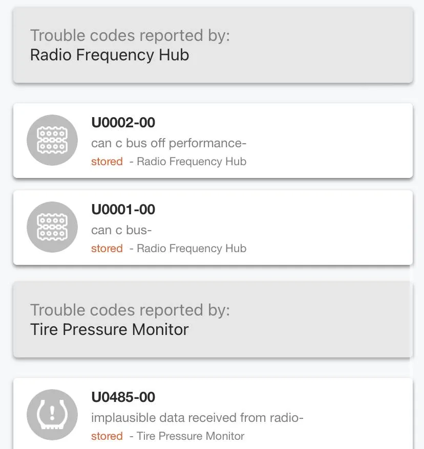

Just put in my new radio that has the climate control integrated into it. The dash display stays lit and so does the shifter light. You can hear the climate control click and then it turns them back on. The climate control is just one wire, so it wasn’t wired incorrectly. I got the red hood open symbol on the dash intermittently too (flashes once). I pulled the F32 fuse and nothing happened but I pulled the F105 (Integrated Center Stack (ICS)/Heat Ventilation Air Conditioning (IFVAC))and that stopped it. So now my climate control doesn’t work now (because I pulled F105) but I’m still able to start my jeep. Any solutions to get the display and shifter light off?

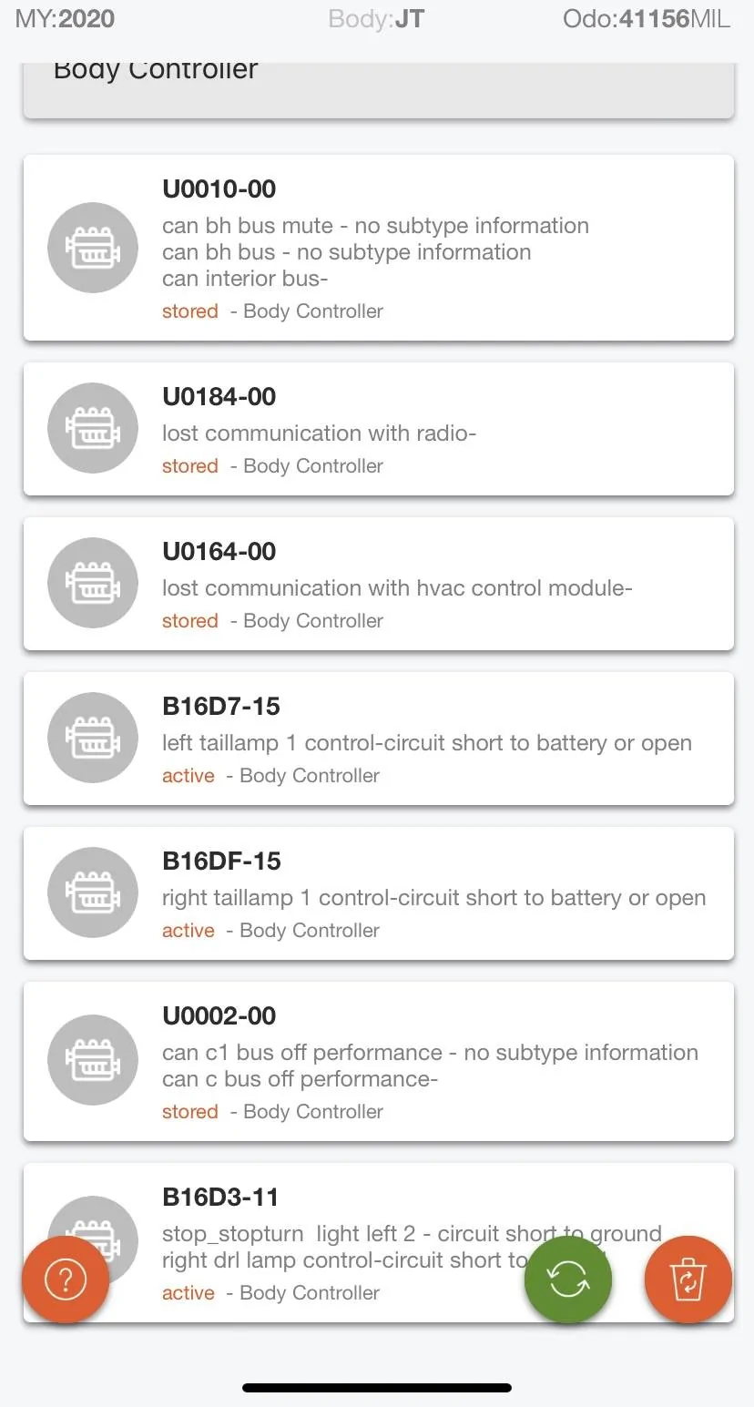

I ran diagnostics with my JScan and this is what I got:
Jeep Gladiator Dash display and shifter light staying on IMG_4515
Jeep Gladiator Dash display and shifter light staying on IMG_4514

Off the cuff, it appears the device is dragging the can bus down. With just a hardware change being the only variable, that just leaves the hardware assuming you did not hamfisted the install of the device. I would be surprised if any software or device input setting change will fix this.
