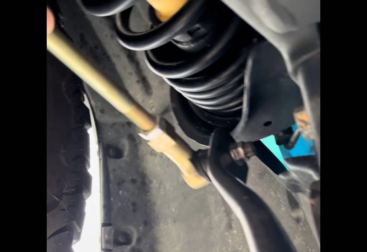

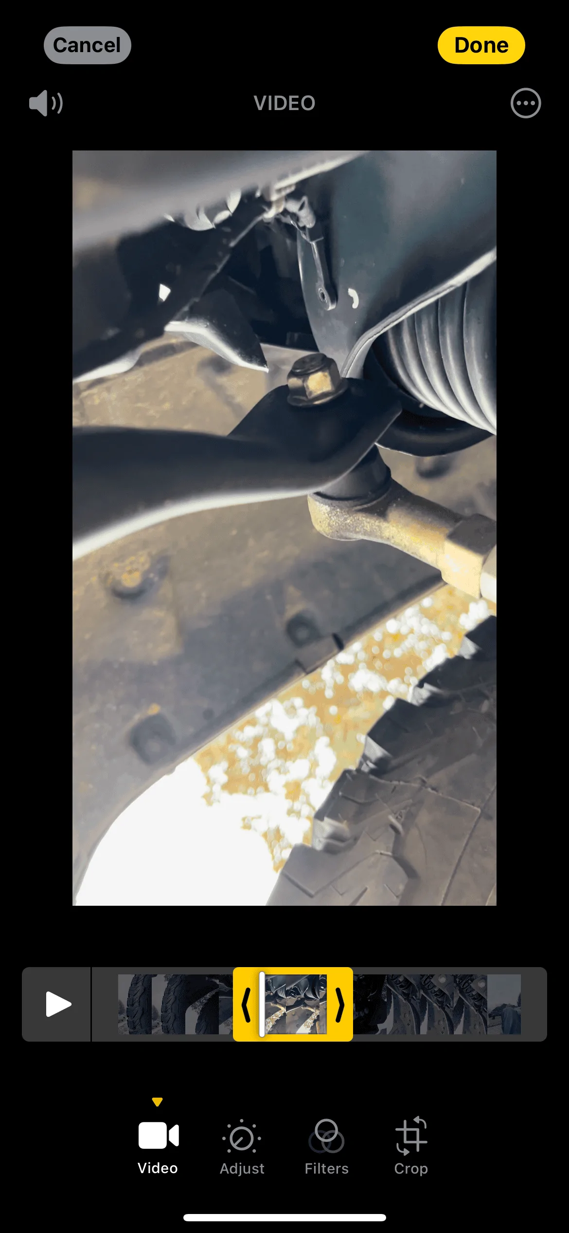

I found my problem. Loose sway bar link. Finger tight. Haven’t had an issue since. Rh side was loose. LH side shows what it should have been. 100% on me not checking after my last outing. Video was too large, but that sway bar was clanking it was so loose. Fml.
Are you saying a loose sway bar bolt was contributing to your death wobble? That's a new one for me.
I should have quoted my original response to this thread, i had 'shimy' not death wobble. ive seen what most people call death wobble is just as shimmy.
im saying that as soon as i tightened this back down, my side to side lateral steering wheel shimmy on uneven pavement has not been triggered since.
