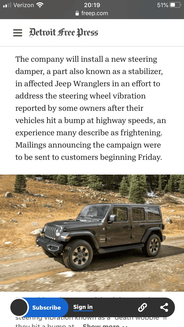

That is not true. I have ran my JT and my Jku without a stabilizer. Drove with a busted one for 6 months on my JKU. A stabilizer will never cause death wobble

Yeah guess what that didn't fix the problem. Remove a steering stabilizer from you jeep and drive it. If it's setup right then you want need it. I'm not got going to argue about something I know to be fact I don't car how many articles you post. I always remove my Steering stabilizer when I do a lift or news with suspension parts and drive my Jeeps for a few days without one to see what else need to be dialed in, learned that from some people who knows a lot more about lifting stuff than I do. All your stabilizer does is act as a damping shock for the steering,like shocks on your vehicle. Without a steering stabilizer you will feel more of the road in the steering but it's not going to cause wobble, if happens it's because there is another issue on going on with your jeep. What they will do is mask a existing problem that is going on with your jeep.

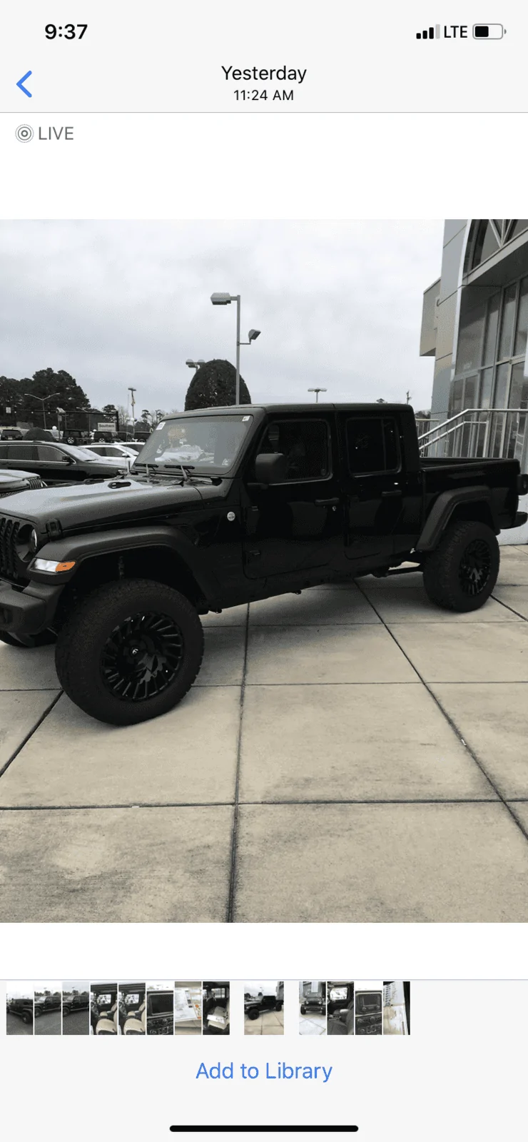

One more piece of death wobble investigation, those look like after-market wheels. Please make sure they are balanced properly. I have had issues with Jeeps with imbalanced wheels triggering this.
