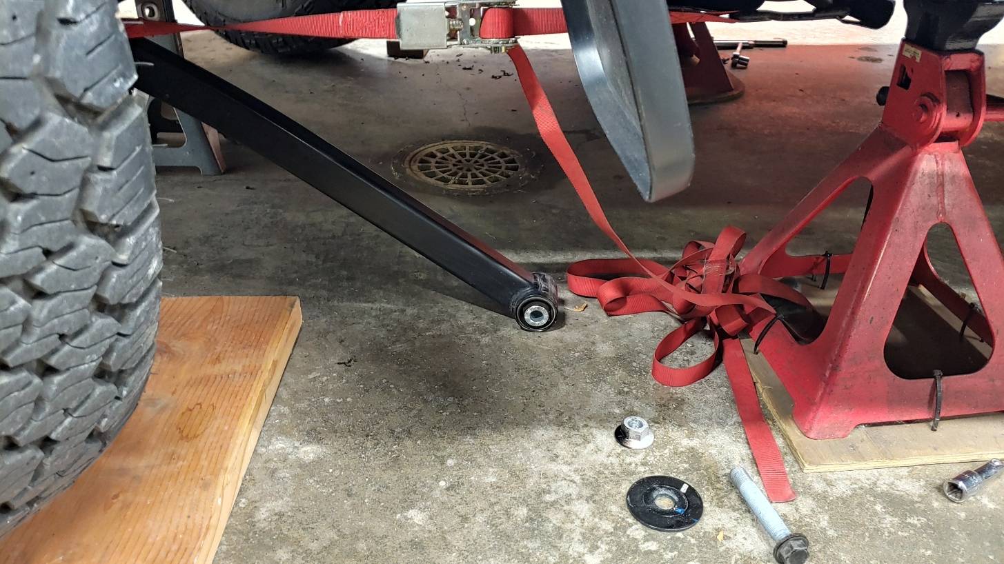

I didn't get pictures of the brackets last control arm swap - only the end of the arm, and showing something changed between 2020 and 2022 - they added a large washer on the inside of the bracket that goes on before the nut. I found that an interesting change.
I'd rip into it to measure sizes of things but shopping this morning showed me, much to my wife's dismay, that I'm still not up for full duty - I lifted 20 pounds this AM and it really pulled at some of the incision areas - supposedly I should be past that, but a week after the surgery, the guy said "nothing over 10 pounds for another 3 to 4 weeks" so I guess this is out for a few days. He said he really had to pull things open in there - so I'll feel it for a while.
Jeep Gladiator Death wobble 20220815_144240_HDR

I'm rather serious about suspension and steering - if the holes in the brackets on mine were loose around the bolts, even though I know things should not shift when tight - it would bug me to no end.
yeah that washer was my visible giveaway. its edge protruded past the edge of the bracket, and I thought that shouldn't be possible, the whole reason i went with non adjustable arms is because i didn't want to have to adjust them. ended up having to adjust them.
