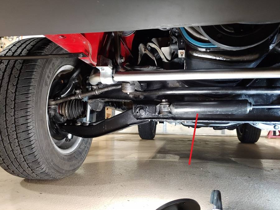

I could be wrong, but seems to me that AMC was the company that introduced the steering damper to Jeep, and to Eagle.
Working on Jeeps and Eagles around 1980 or so, I can't seem to recall them prior to that time period. But then, that was a long time ago.
Having been raped and pillaged and robbed of all cash by Renault, AMC had little cash left for R&D. ->
AMC did have a steering damper, I believe it was introduced then to keep that easy steer GM gear box from not feeling so smooth. I remember you could steer those things by almost breathing on the steering wheel it was so easy to turn. That was when 32.5s were monster tires to the world ;)
