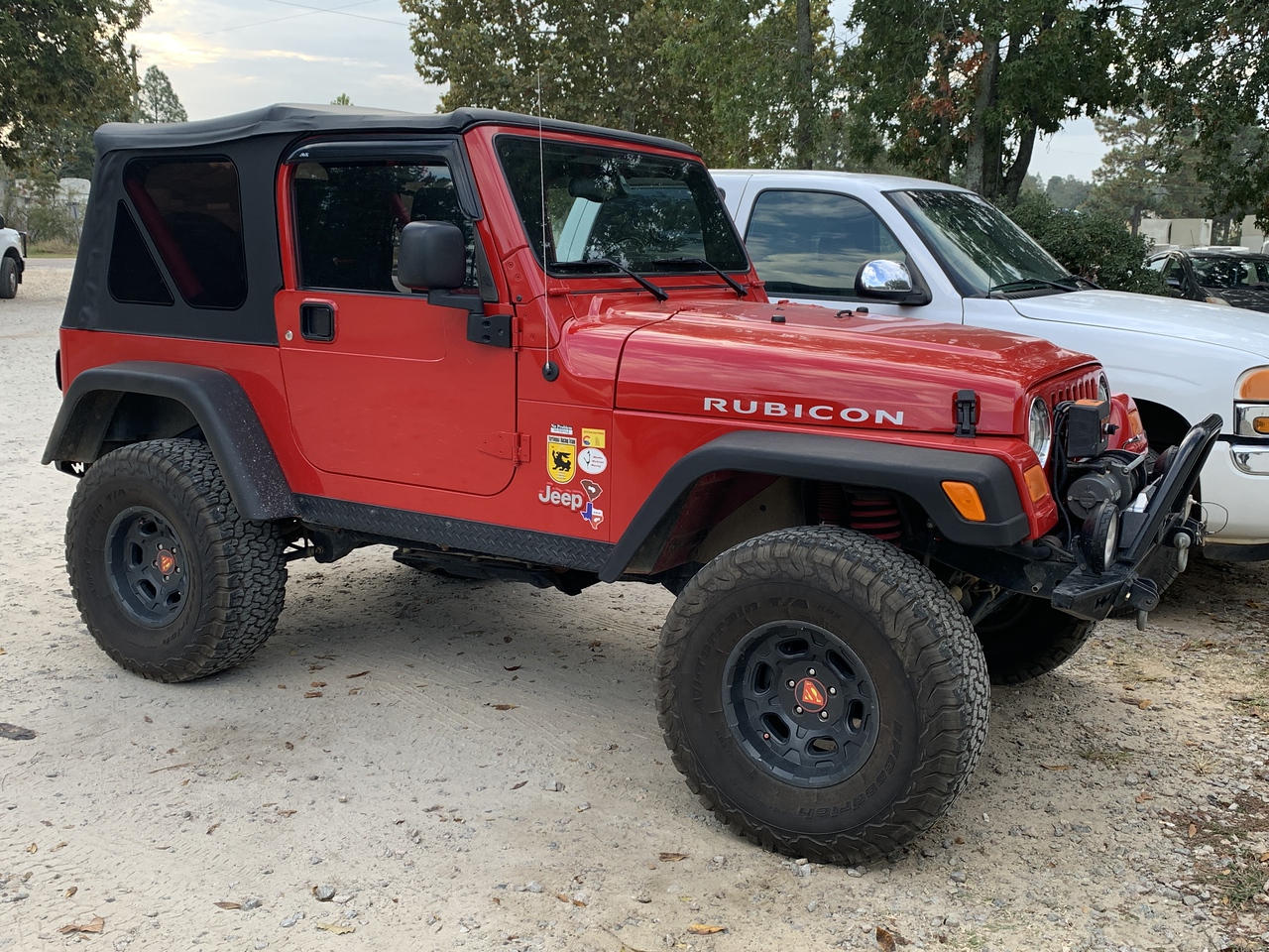

Whenever I see threads with a member having the wobbles after making changes to the suspension, my first thought is always the wheels. For the purposes of this discussion, wheels come in 2 flavors, hub centric and lug centric. Factory wheels are always (as far as I know) hub centric. The hole in the center of the wheel matches the diameter of the hub on the axle. The wheels center as soon as you mount them. Many aftermarket wheels are made for multiple vehicles. The holes in the center of the wheels are oversize and the wheel does NOT center until the lug nuts are installed. The problem with this is that you can mount a wheel off-center if you tighten the first lug nut enough to lock the wheel in place before installing the other lug nuts. There is a procedure for installing lug centric wheels.
Here is how you should mount your aftermarket rims, after a rotation, new rims or tires, or a good ol cleaning
1. Jack car up and secure it with a jackstand (Safety First :) )
2. Loosen all lug nuts and either put on rim, rotate or whatever the hell you need to do.
3. Thread on all the lug nuts, but DO NOT tighten to where you can not move em.
4. Rotate the tire/rim until one of the 5 lugs is at the 12 o clock position.
5. Tighten lug nut with thumb and forefinger to the point that you can not do it anymore.
6. Rotate the tire clockwise, skipping one lug nut.
7. After skipping the one nut, put the 3rd nut in the 12 o clock position. Tighten this one the same as Step 5
8. Skip one more nut, and repeat Step 5. This last nut will be right next to the first one.
9. Let the truck down to where the tires barely touch the ground. Use a wrench and tighten all bolts with about 25% of your strength. Just enough to grab.
10. I then let the truck down all the way and torqued the bolts to 90.
11. Repeat all steps above for the rest of the truck
Mt first Jeep (2005 TJ) with American Racing wheels was great until I changed the tires. Then I got the wobbles. I struggled with the wobbles until I changed tire jockeys. My new tire guy showed me how one wheel was off-center. Once I learned the right way to install the wheels, it was smooth sailing after that.
