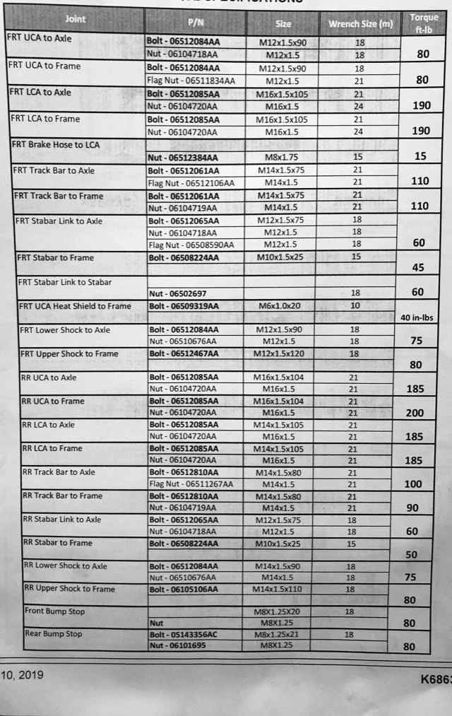

New (to me) 2020 JT Rubicon 3.6L w/17k mi. owner here as of last night and couldn't be happier, but it wanders like a drunken Stevie Wonder. It's also got 20" wheels and Nitto Ridge Grapplers on it, don't judge me, that's how it sat :) Long story how I arrived at a JT, but nevertheless here I am. I had done a lot of research on lifts with JLUs and heard of "the wobbles" and many have had it solved using the AEV stabilizer, but I know there's more to the entire equation. It seems it's been documented on my truck before, but not sure if anything was ever done about it, just could see the complaints doing the VIN search and info from the NHSTA.
My main question is where can I get the torque specs to check EVERYTHING first before I run off and try to find a dealer to have look at it and address the wandering? This is my first solid axle truck and coming from Toyota/Lexus IFS and hydraulic KDSS, something more simple to work on is a relief. Is there an online FSM or spec sheet? I know there's a TSB out on it, and an outstanding recall that it needs done as well, but I just want to have my ducks in a row prior to showing up to the service dept. TIA.

Here you go:
Jeep Gladiator 2021 gladiator death wobble 3495E30E-9D5B-4606-A341-4C2D6265931C

Here you go:
Where is that out of? Is that the FSM or anywhere as a .pdf by chance? I ask since I'm new to Jeeps/SFA, and trying to learn what the components are now compared to coming from Toyotas and IFS, the UCA is not the same thing lol!

Upper control arm goes from the frame on each side to the top of the axle tube on each side.
Lower control arm goes from the frame on each side to the bottom of the axle tube on each side.
Track bar goes from frame on the left or driver side over to the right and connects to the right axle tube. That keeps the front axle "centered" under the truck. Because it swings in an arc as the vehicle lifts up on a bounce the axle will shift left a bit and when you hit bottom it will center again, perhaps slightly to the right and then when the vehicle settles back to curb height, the front axle is pretty much centered under the truck again by the track bar.
The control arms set the caster. Caster is not adjustable without replacing the control arms either with longer lower arms for more positive caster, or with adjustable lower control arms. It gets into more depth and detail with lifts but that's the gist generically speaking for an unlifted of slightly lifted Jeep, etc.
Camber cannot be adjusted without replacing parts. Camber is very seldom a concern as it's set at the factory when the steering knuckles are put in place and parts welded into the ends of the axle tube.
Toe is set very similar to IFS/independent front suspension except you have a drag link from the pitman arm all the way over to the right knuckle and then a single tie rod from the right knuckle over to the left knuckle. Set toe with the tie rod, center the steering wheel with the drag link.
