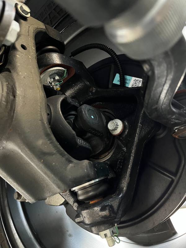

UPDATE !!! Guys I can’t thank all of y’all enough for all your help ! So I had a set of American Iron ball joint deletes on order. Replaced the factory ball joints and my death wobble is GONE !!! I can go back to enjoying my gladiator as I should once again and it’s such a relief. If anyone has the same issues with death wobble and your suspension and steering feels tight...trust me and replace your ball joints and with something high quality !!! There was absolutely no physical or visual indication that mine would be bad but they were ! And I can’t thank Josh from American Iron ??enough as he personally took all my phone calls even on his way out to King of the Hammers !! Josh is an amazing young man and has exceptional customer service ! Here’s a picture of my gladiator for y’all before all the steering upgrades chasing this ghost !

Tell him to 100 % change his ball joints first and replace them with something high quality ! The Eco may have a little heavier ball joint from stock due to the added weight.

Glad yours is fixed! But this makes my fears as a tech true. Either I say new Knuckles and steering for everyone thats comes in with anything more then the small shimmy. Or I play the painful game of one part at a time
I’d play 4 ball joints at a time if everything else is checking out and nothing visually worn. The factory lowers I like to never got out of the knuckles. But when I did there was a significant difference in feel of them. The top felt like a normal ball joint but yet upper or lower seemed to feel worn out. But the lowers were filled with a sort of white liquid and the whole thing felt like it was floating in jello...no joke. You could not feel the socket like you normally can feel the ball rolling in the socket of a normal ball joint. I’d say ball joints just in my opinion would fix more than half of all death wobble cases if everything else seems good. Also....my Rubicon has the aluminum outer knuckles. And I did not change them I left them.
