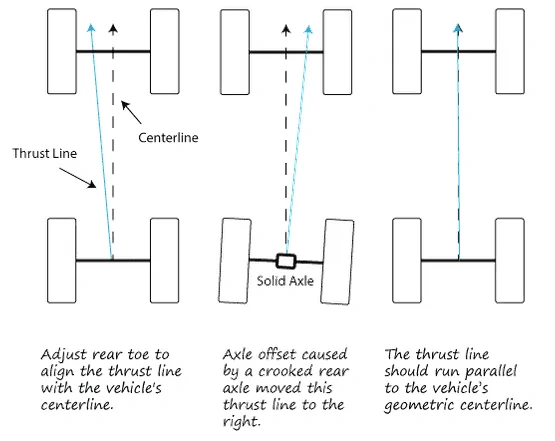

Check your thirst angle. If the rear and front axles are not centered with each other you can get DW
250
40,612
54,288
That's not quite the definition of thrust angle. It's more concerned with the drive axle being centered and a line perpendicular to the rear or drive axle runs straight up the center of the vehicle and that the rear wheels are parallel to that line
The thrust angle is an imaginary line drawn perpendicular to the rear axle’s centerline.
It compares the direction that the rear axle is aimed with the centerline of the vehicle. It also confirms if the rear axle is parallel to its front axle.
Thrust is more concerned with the individual "toe" of the rear wheels and that the rear or drive axle is perfectly perpendicular with the center of the vehicle.
That's why rear "toe" is checked and the rear axle checked for "Square" with the vehicle.
It usually causes a pull, or the steering wheel being off-centered when driving but ok with the front wheel toe being centered.
(One definition from a book - A thrust condition exists when the rear individual toe is not equal.)
Far better than what I wrote. I only brought up 2 different points without clearly delineating between the two.
