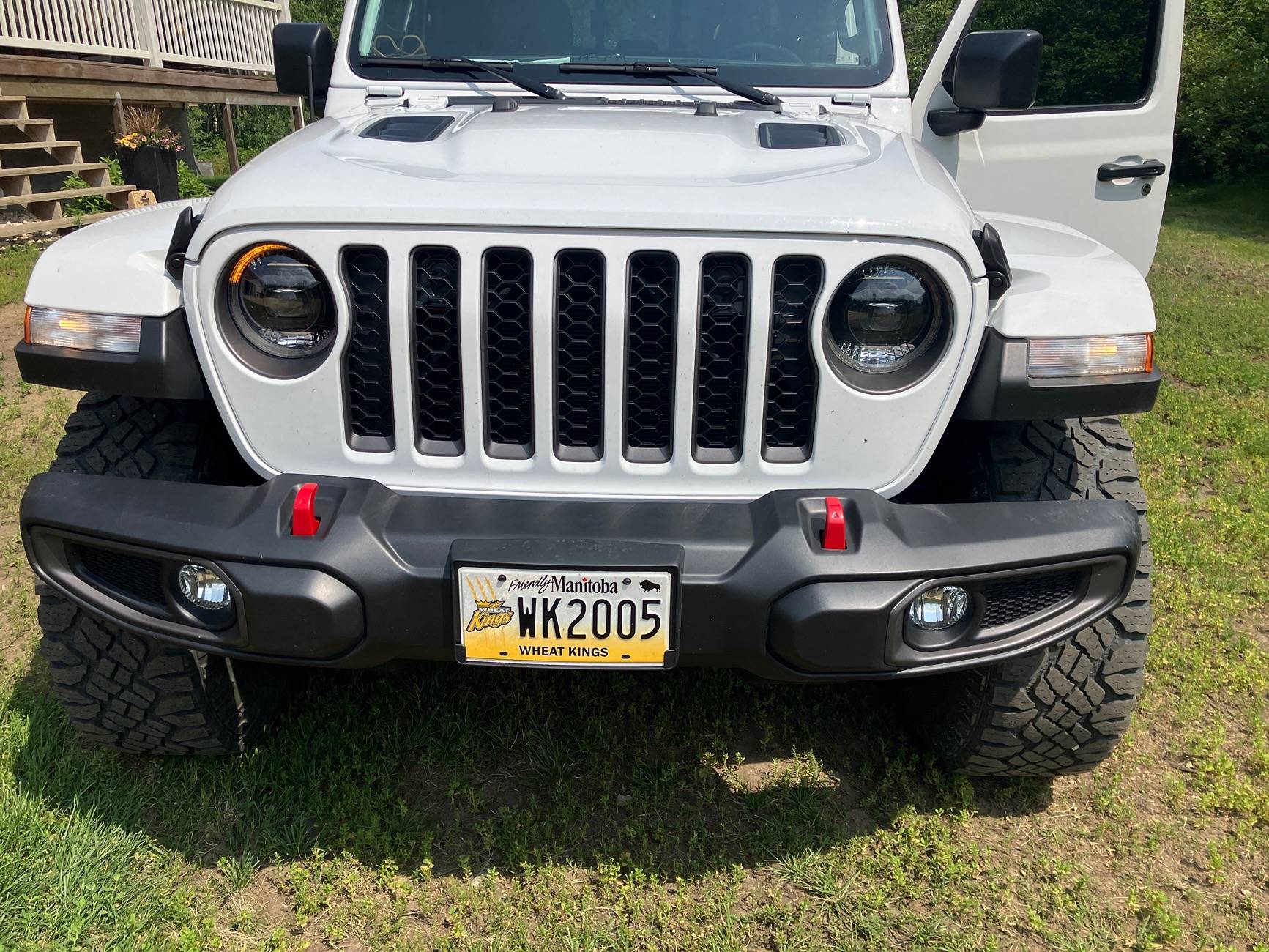

I installed the lights around February of this year, and all was fine. As soon as I started the truck after the install the halo lights were white. The auto headlights did not come on as it was sunny out. I then jumped in to use the JSCAN to set the lights as LED lights. After that, I looked and they were amber. And they blink with my turn signals. All good.
So that was all fine till about May. Then I noticed in a reflection that my drivers side amber was out. But when I used the signal, it still worked. It’s out in this picture. Notice the other one is only partly lit. That’s the camera on my phone doing that.
Jeep Gladiator Diode dynamics headlights acting strange… IMG_3678
I played around with the JSCAN settings, but nothing changed. I got fed up and drove it like that for awhile. Afterwards I also noticed that the little white LED backlight on the drivers was out. Weird.

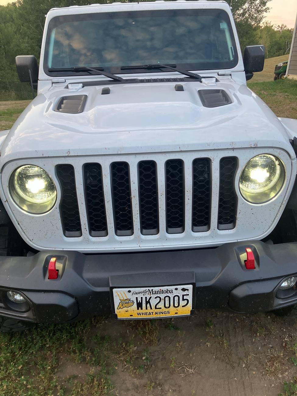

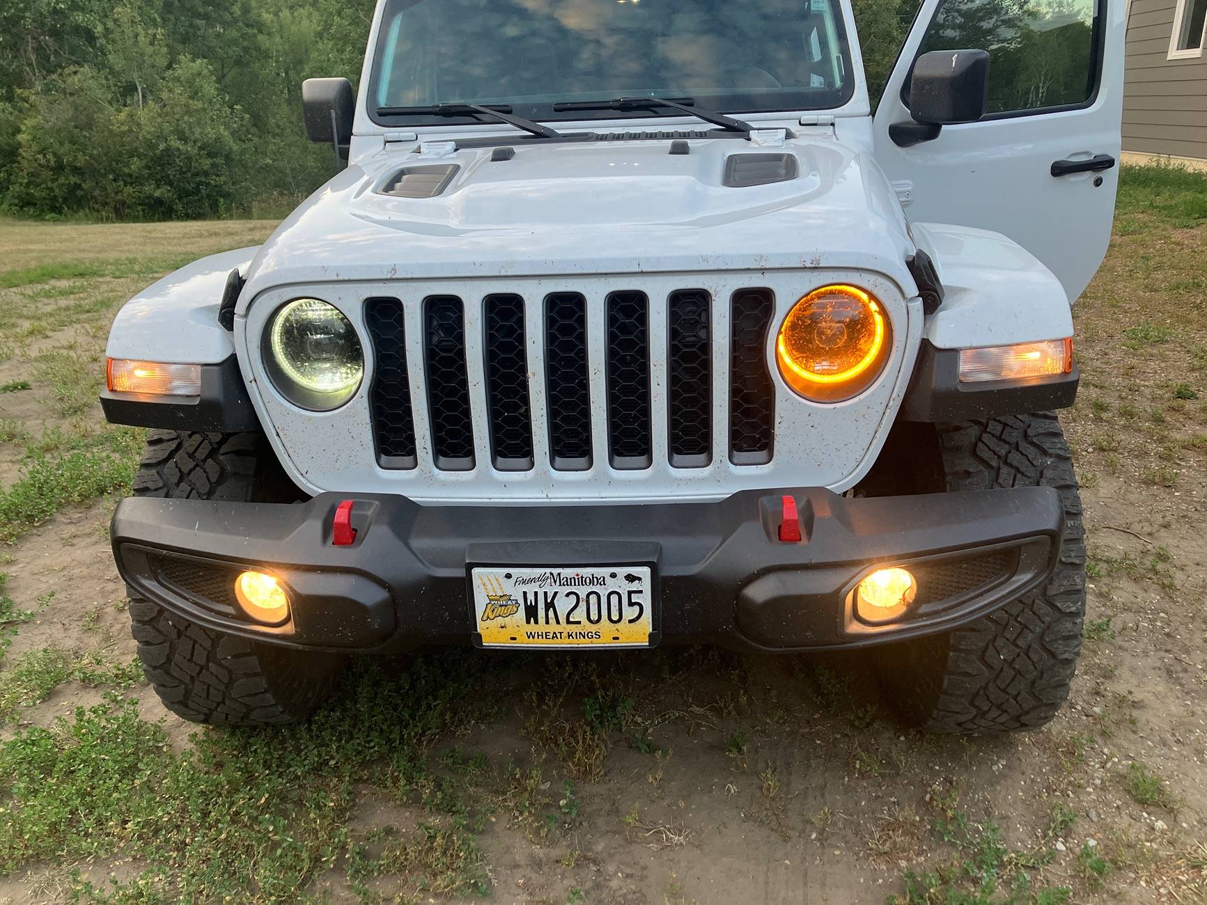

So that brings us to today. Still the same. But I also noticed when I start it from my app, everything works as it should, until I press the button and it goes back to the way it is now.
Here is a picture of the headlights on, and I was testing the drivers turn signal. And it worked.

Here is a picture of after I command started it from the fob.
