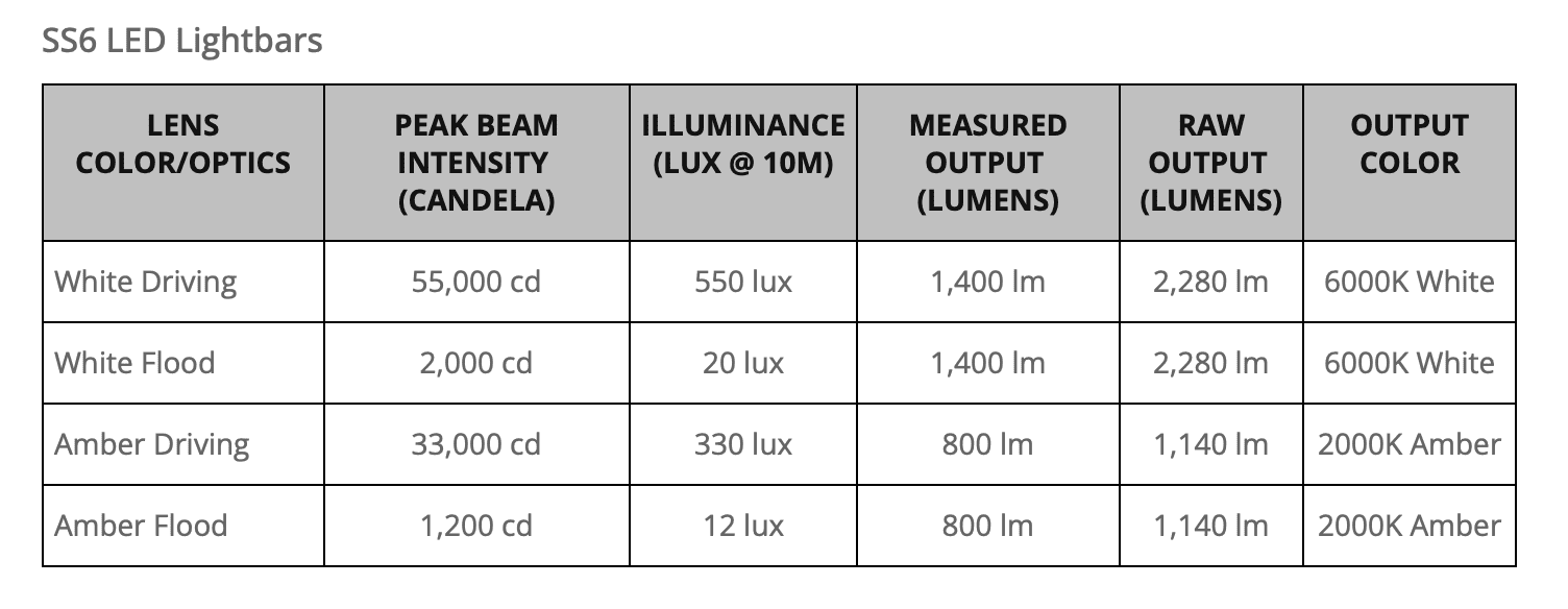

I've used Rigid pods on my Wranglers and really liked them, but these seem sleeker and the claimed light output is very good (especially the lux @ 10M output). I think any company that simply cites lumens rather a measurement at a fixed distance can say almost anything they want. On a related note, I've measured output on some of the cheaper units out there and have been disappointed.

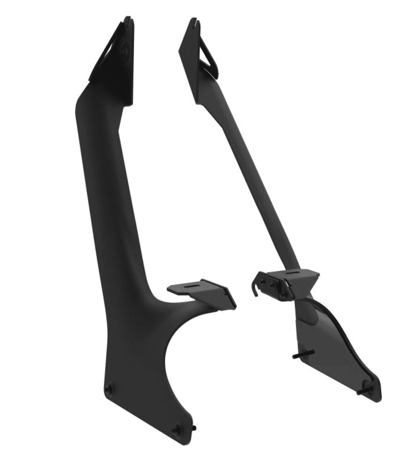

If you have a mojave, the cowl mounts will not fit.
Fitment
NOTE: This kit is compatible with all Sport, Sport S, Overland, and Rubicon trim levels. This kit IS NOT compatible with the Mojave trim level.

Oh no, I was not aware of that. Any sense of what is needed to make those brackets fit? Are we just talking about the brackets? Maybe there's an easy modification?

Thanks for reaching out! The Mojave and the 392 have different cowl that is just slightly different. We have found that the hardware and the mount itself do not line up and you cannot get them screwed in. If you would like, I can set your order up for return and get you a return label, or you can try to make them work by modifying them. If you have any other questions, please let us know!

Quick update:
The regular Gladiator (non-Mojave) Diode Dynamics bracket is too far off to use with minor modifications. You'd have to be willing to remove the bottom triangulating portion or similar. So, I'll be sending it back...
...but the provided powder-coated bracket that is intended to mount on the "main bracket" may be okay. I've done a test fit with a 20mm delrin spacer and a 75mm M6x1 bolt. The top Mojave bolts use a T40 head with a shoulder and is 55mm long.
Since the six inch light bar is pretty light, it may suffice. I'll give it a go for a bit and see what happens...

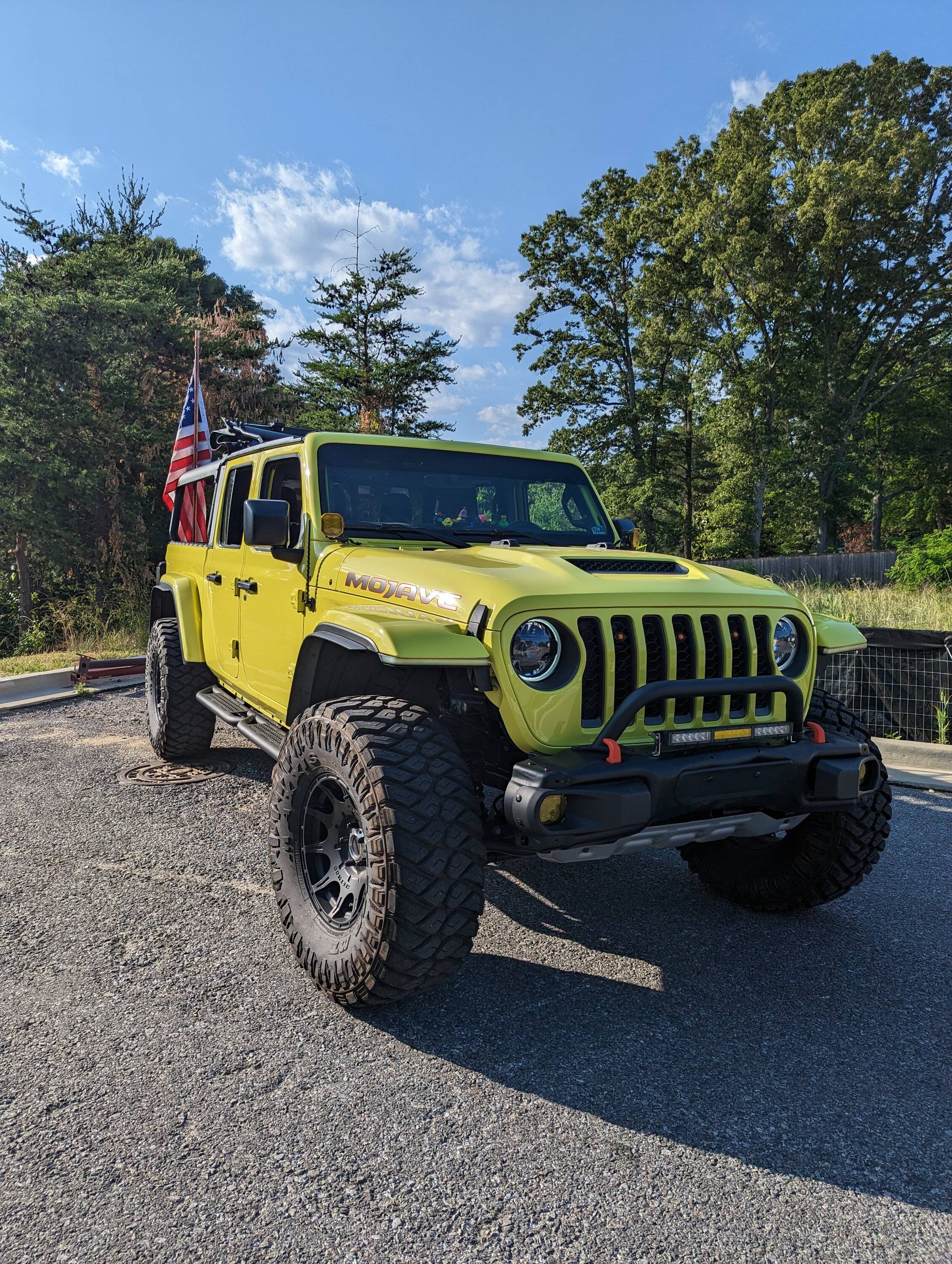

So, they are mounted...I need to aim them tonight, but generally happy with how it turned out. It has a very minimalist look, which I prefer.
I really don't see it being an issue with just a single bolt on the 20mm delrin spacers...but gonna go bouncing around a bit and will report back. ;)
Oh, and I decided on the AUX 3 position. It's one of two lower draw switches, and felt easier to reach. The way this particular setup is wired, it doesn't matter if the draw is higher -- it's setup to draw directly from the battery.
