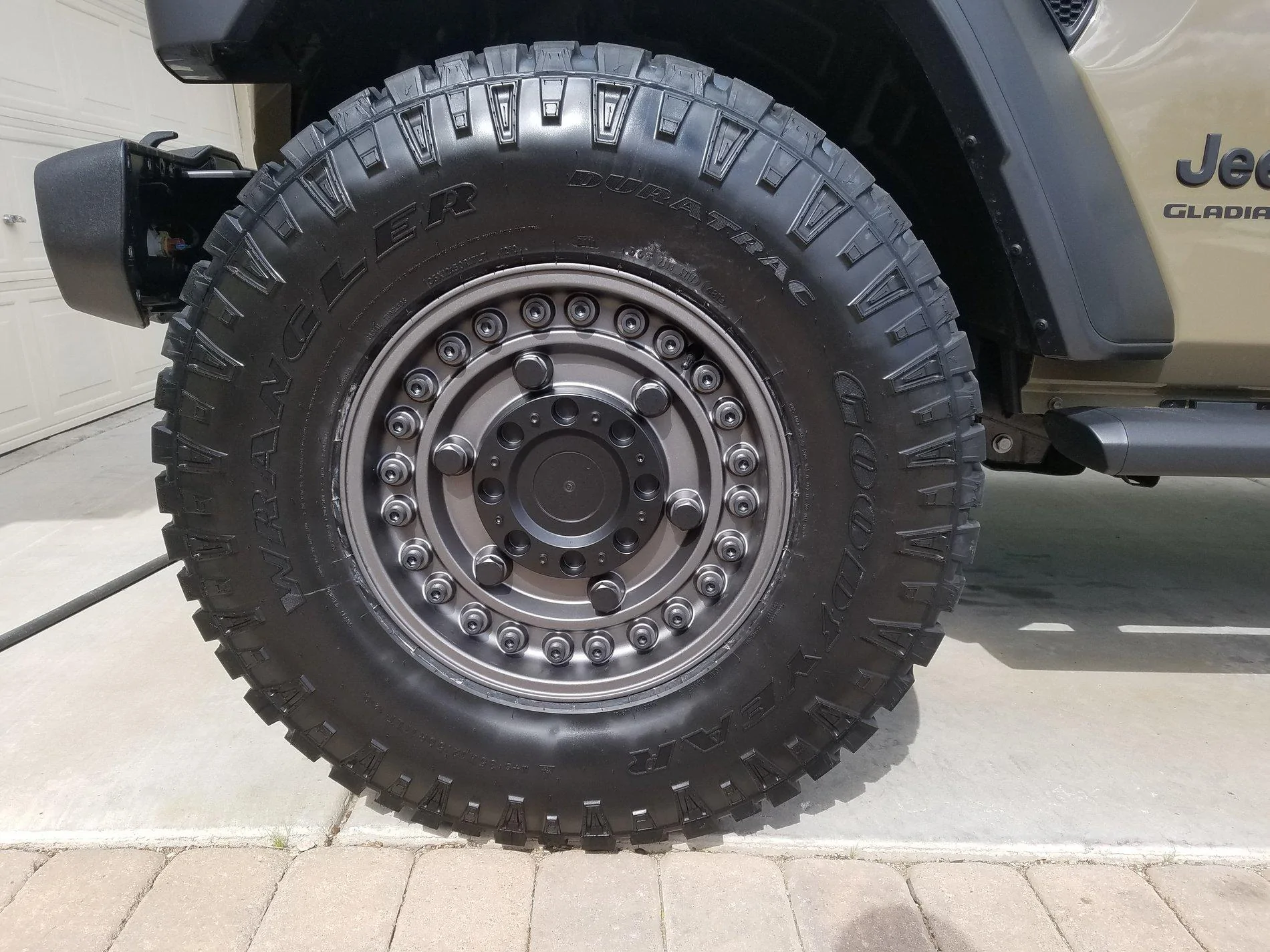

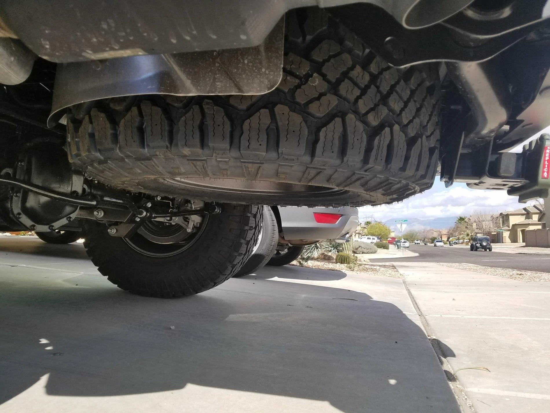

I took some pics of my 35s after I put them on, looks like the storage area is almost maxed out.
Jeep Gladiator Do you buy a spare? Where do you keep it? 20200223_130258
Jeep Gladiator Do you buy a spare? Where do you keep it? 20200223_114330
