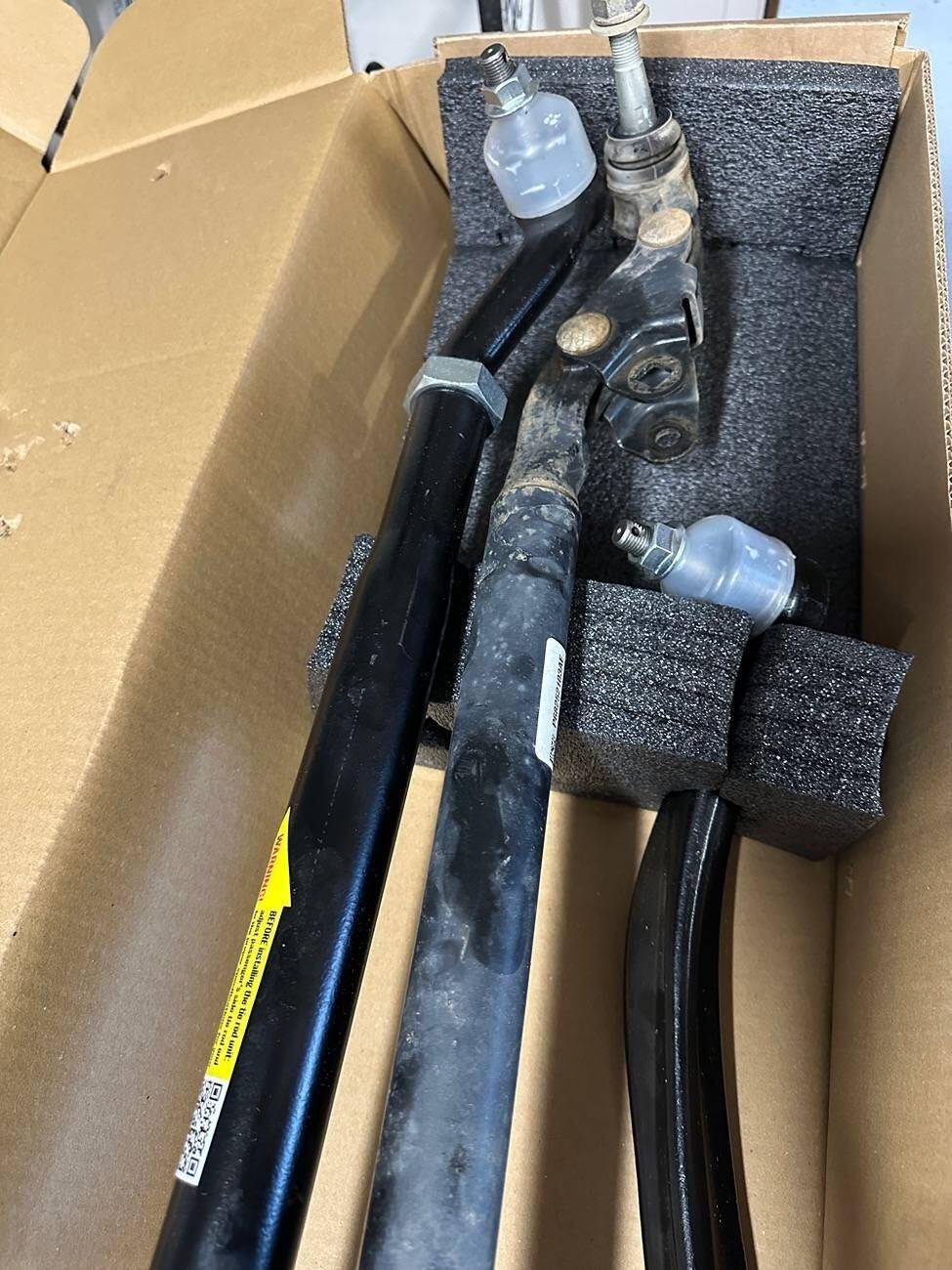

Stock Tie rods side by side...
Jeep Gladiator Drag Link at 22k? 1745866802939-v3
