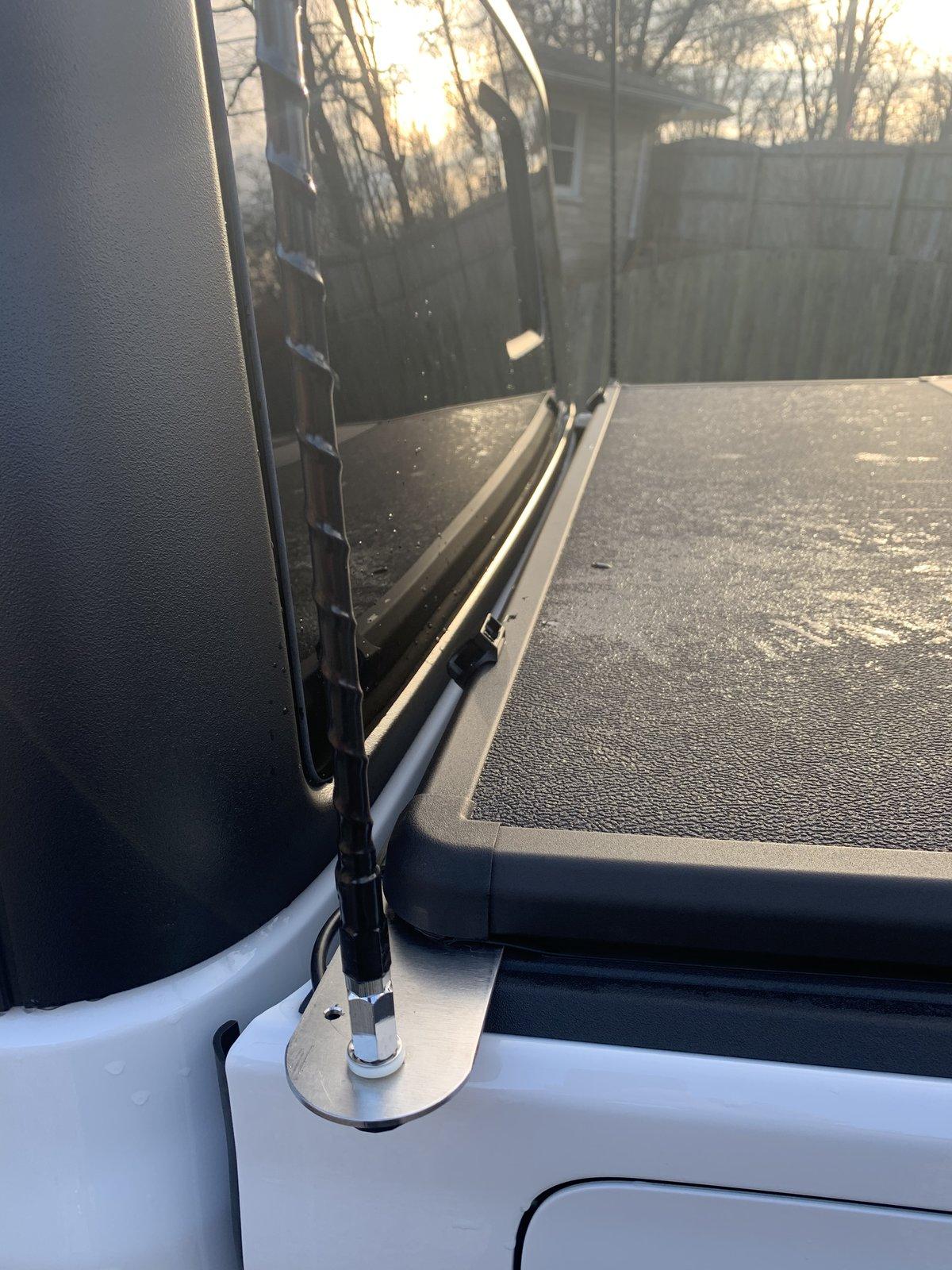

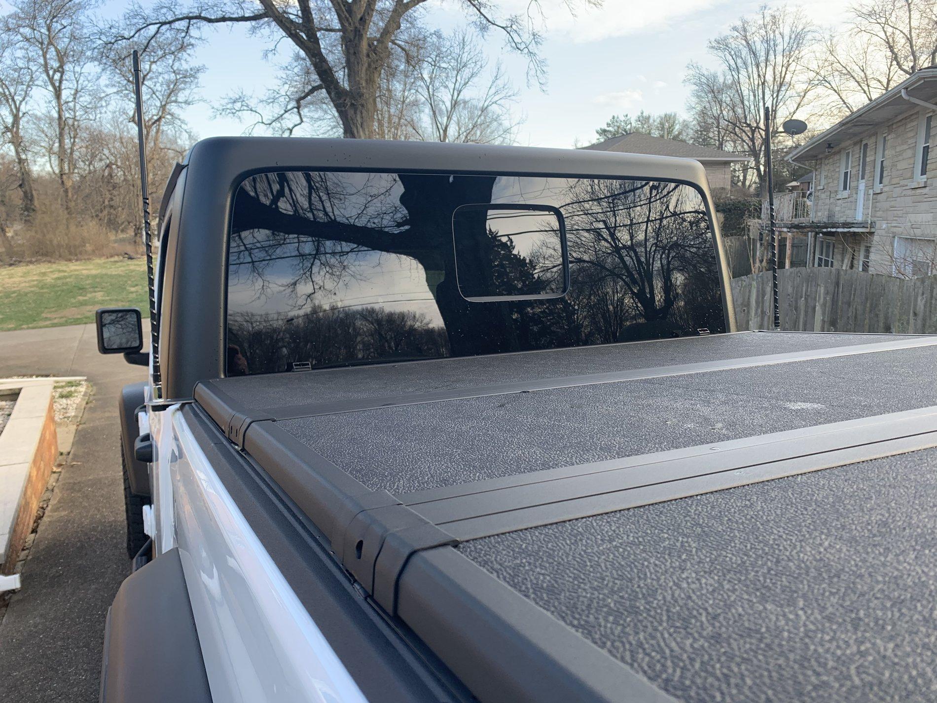

So, still haven’t found an answer, so i made one. Used the existing bed storage mounting holes on the head board. Bought a piece of drop stainless cut it to an L and bent it over. Measure twice, cut once
Jeep Gladiator Dual bed-mounted cb antenna for bed cover F849AE3B-C231-4A4C-86A7-14918F924F92
Jeep Gladiator Dual bed-mounted cb antenna for bed cover A4A44D6F-2821-4A1E-8A79-7988C621242B

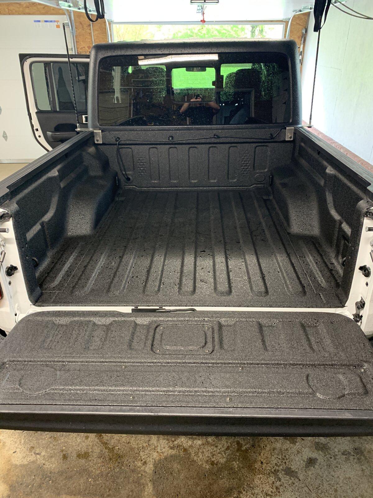

Do you have a picture of it unmounted? Looking to do the same thing.
I think this is the only shot of the bed w/o the cap on.. You can see how they bend and mount.. I used cardboard for the template to measure then cut the steel from there.

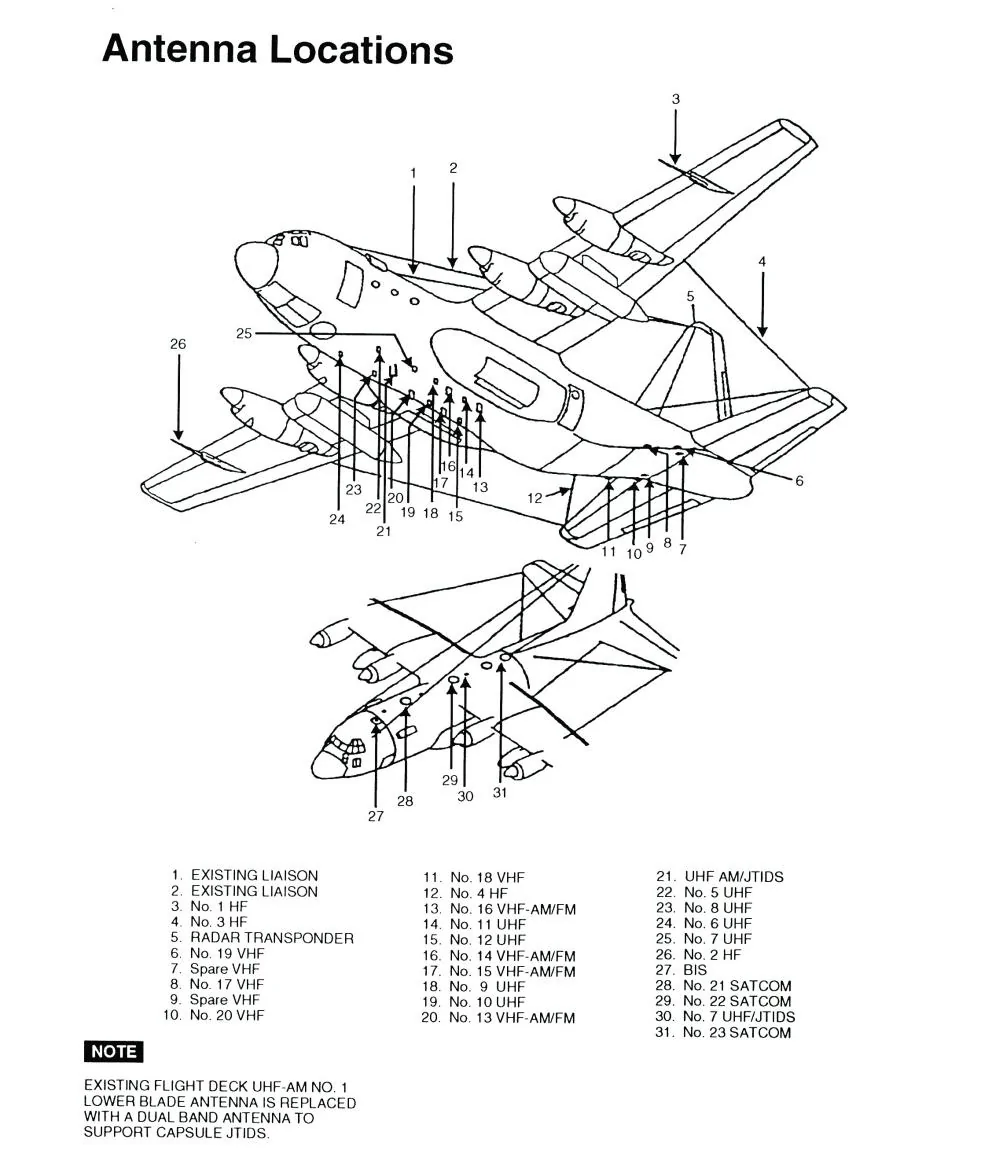

My bonafides: Thirty years maintaining and flying on (Over 4,000 hours, including in Vietnam War, Desert Storm and Bosnia Conflict) and working with contractors to upgrade the EC-130E/Airborne Battlefield Command and Control Center avionics systems. This included six HF radios, ten UHF radios, four VHF-FM radios, six VHF-AM radios, three SATCOM radios, two data link systems (Joint Tactical Information Distribution System and Battlefield Intel System), and GPS and other nav-aids. It was also necessary for us to set up antenna systems for ground operation of the ABCCC capsule for local training missions.
Jeep Gladiator Dual bed-mounted cb antenna for bed cover Antenna Locations, EC-130E ( with JTIDS)
