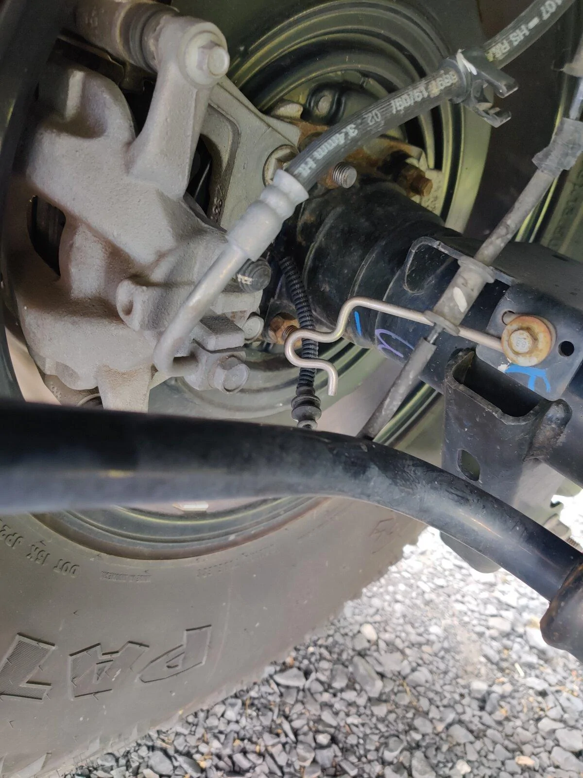

I can't seem to find that thread in the search. I noticed this today and put it back on. :swear:

I believe that is the wheel speed sensor wire. Did the ebrake cables look okay?
