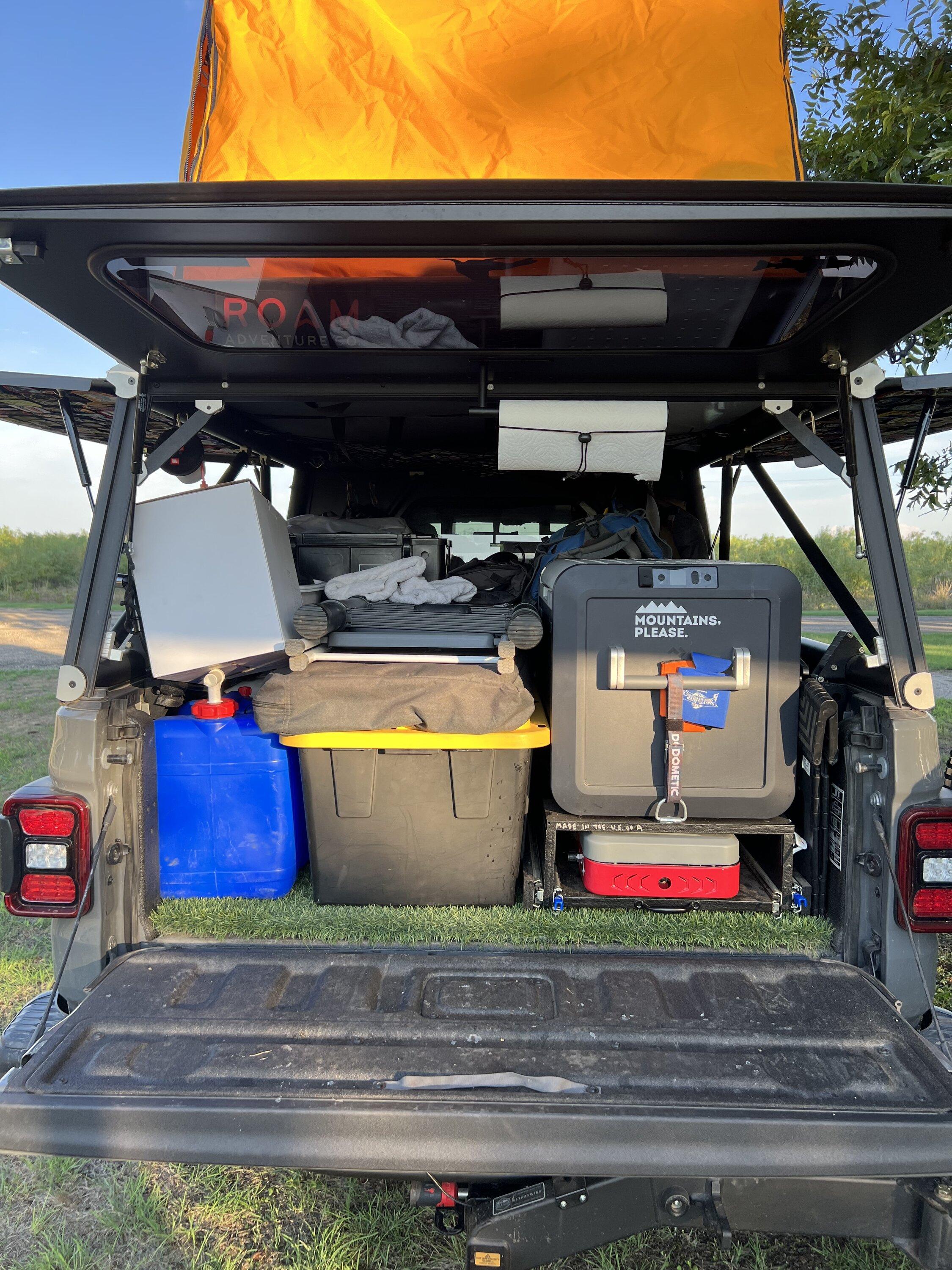

Also, I should note, airflow in the back is relatively minimal. The gfc gets pretty hot with the black panels and since we’re cross countrying we have a decent amount of stuff loaded up. That being said, the battery and fridge fan outlets are free from obstructions.
