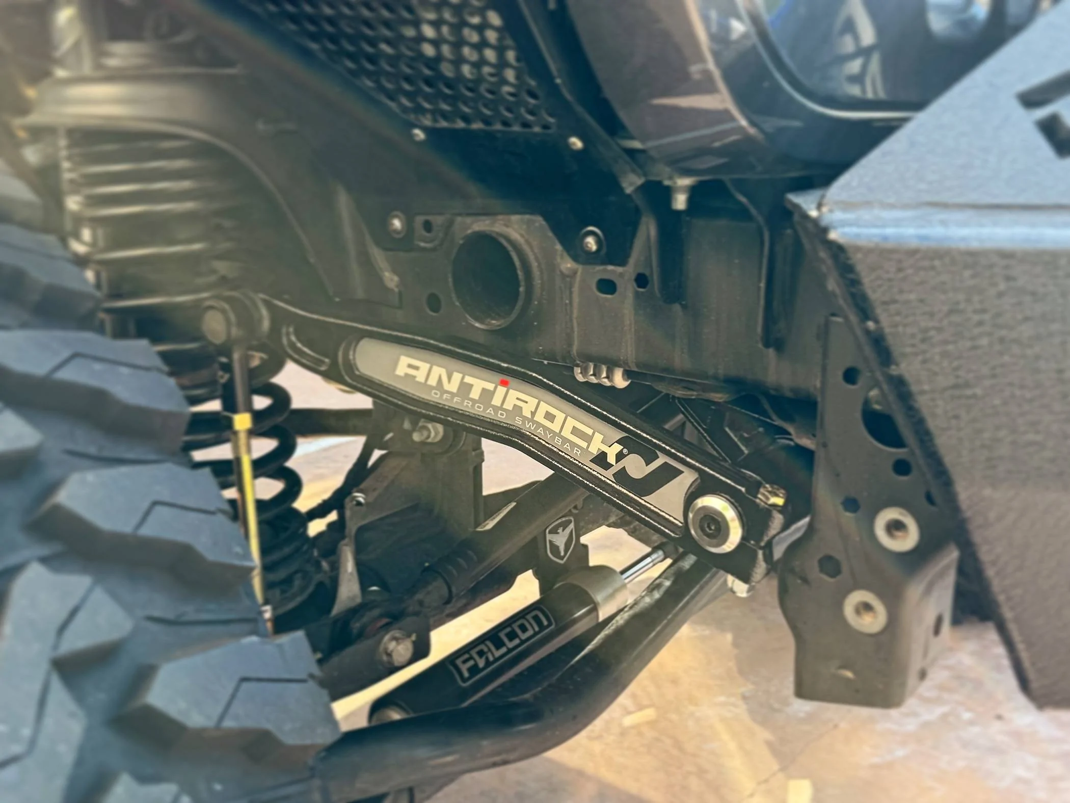

I did away with my electronic sway bar and added the Anti Rock from Rock Jock. Needless to say, I love the upgrade however what I don't love is the flashing light on the sway bar button & dash.
Any device I can plug into the connector to defeat the flashing light? My searches have come up with nothing but I'm sure they make a module of some sort to defeat the dash/button light.
Thanks

I went with the EVO manual disconnect, I used a Tazer JL Mini, https://www.zautomotive.com/product...jpVyKvB2Jgnint5OnywLYaAsf0EALw_wcB#camera-kit. No more flashing lights or Service 4WD messages. It does a lot of other cool stuff as well.
Thank you. It looks like this is the option. I knew about the Tazer I was just wondering if they made a standalone plug-in that was like $50 or so. I guess I will just bite the bullet and get the Tazer. It has other functionality too I guess.

Yes the Taser is pricey. Be sure to avoid the Chinese knock offs of the EVO disconnect. Many aren't well made.
