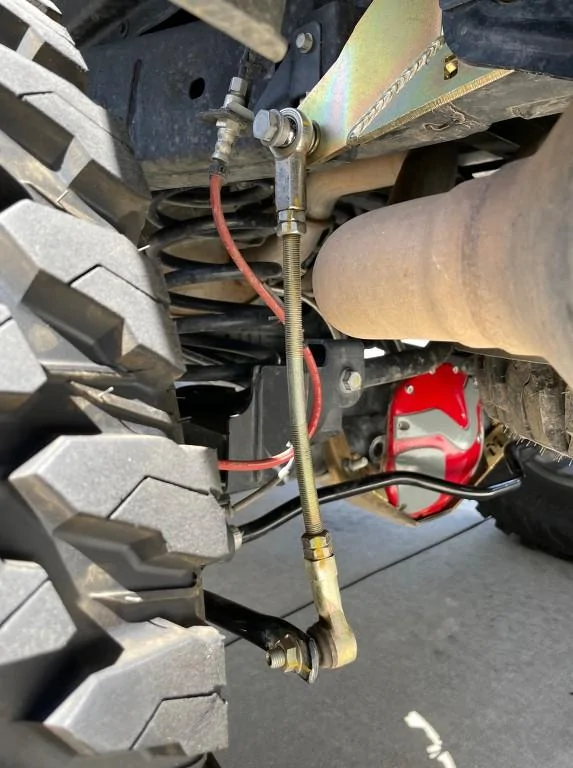

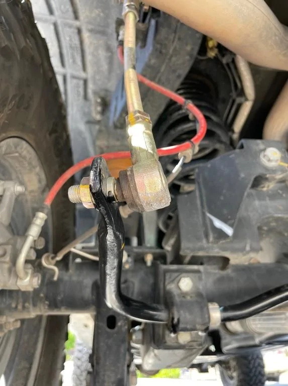

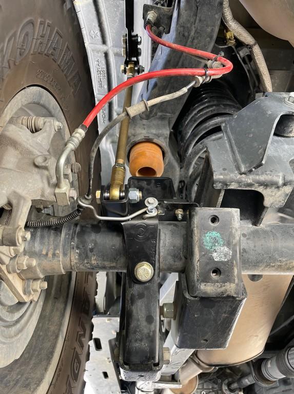

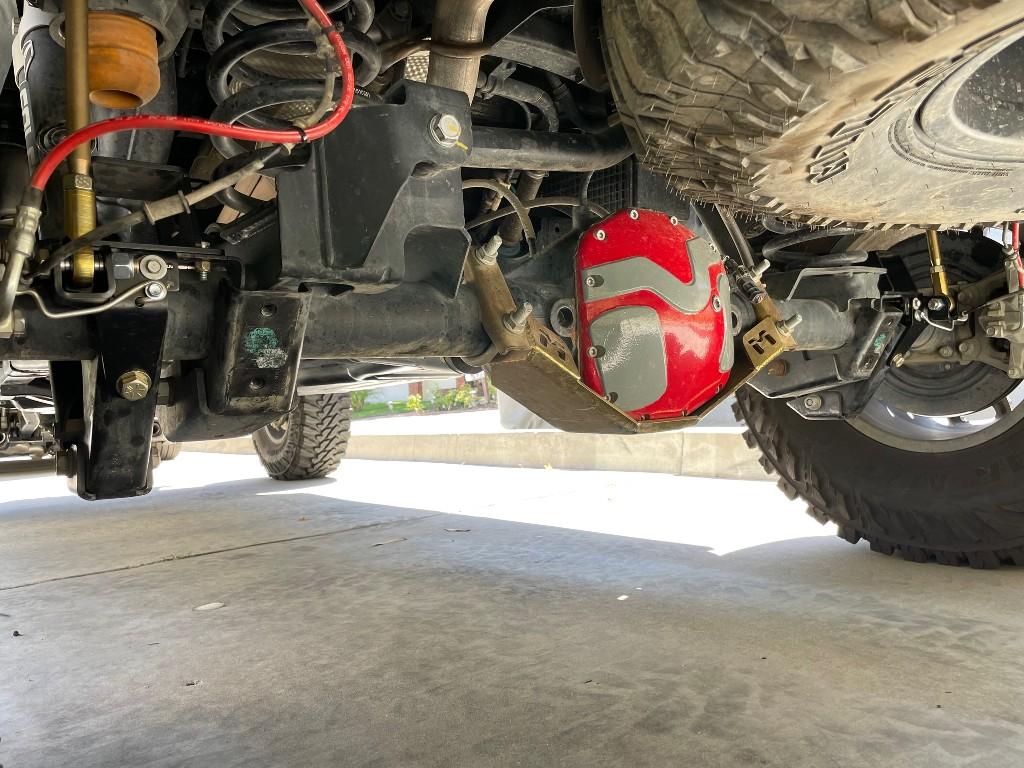

If you 4wheel a lot, expecially out west with all the rocks and boulders, the sway bar end links get constantly bent. Really not a good design for 4 wheeling. After fixing my bent end links many times, I went with the Rock Jock anti-rock torsion bar. I love how it works with my Clayton lift kit. Here are some pics.
Bent end links and sway bar tabs....

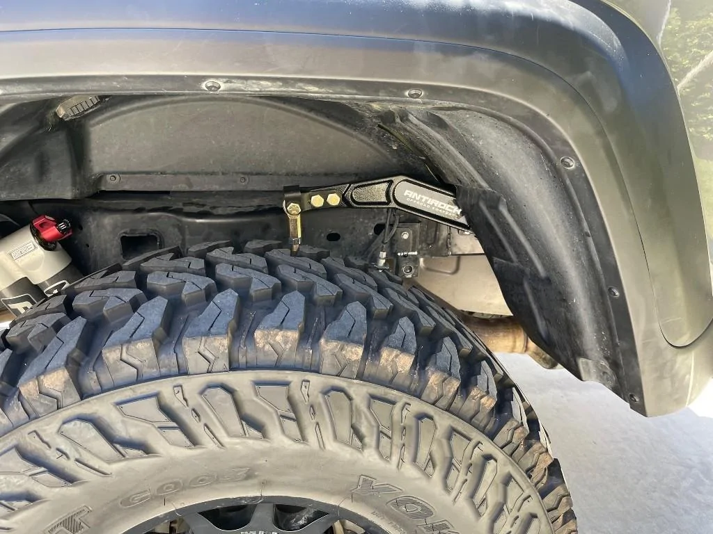

RockJock anti-rock torsion bar above the frame
Thanks. I like the RockJock, but I’m hesitant to drop that much dough on just the rear, and to ditch the rubicon front. But I’ll do what I need to do if it makes the difference. See my more recent response about my weekend and feeling scared on a cliff.

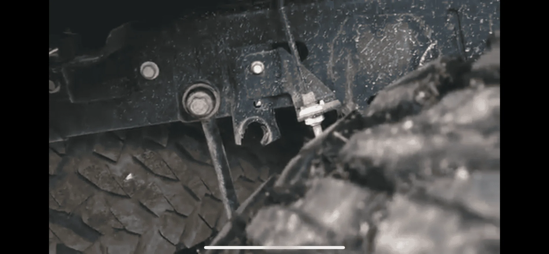

I had to run with my rear sway bar disconnected due to the brackets ripping off the frame. I reinstalled it with the Metalcloak brackets but while it was disconnected, I didn't feel any real difference while wheeling. And just slightly more body roll on the highway.
Yeah, I had a couple of friends rip their brackets, and mine got bent a few times. It seems to me most of the damage to the rear sway bar end links happens at full compression. This is when the end links really hang down and can drag over boulders and rocks. With air-downed tires, full compression, you are basically lowering the endlinds at least 4 inches from level, so, you can see how they drag on the rocks/boulders.. I really like the Rock Jock anti-Rock and the Teraflex copy of the anit-rock is half the price and I believe the Teraflex bar may be stiffer, less roll, not sure, but, my friend has the Teraflex anti-rock with more of an overlanding rig and he really likes it also.
