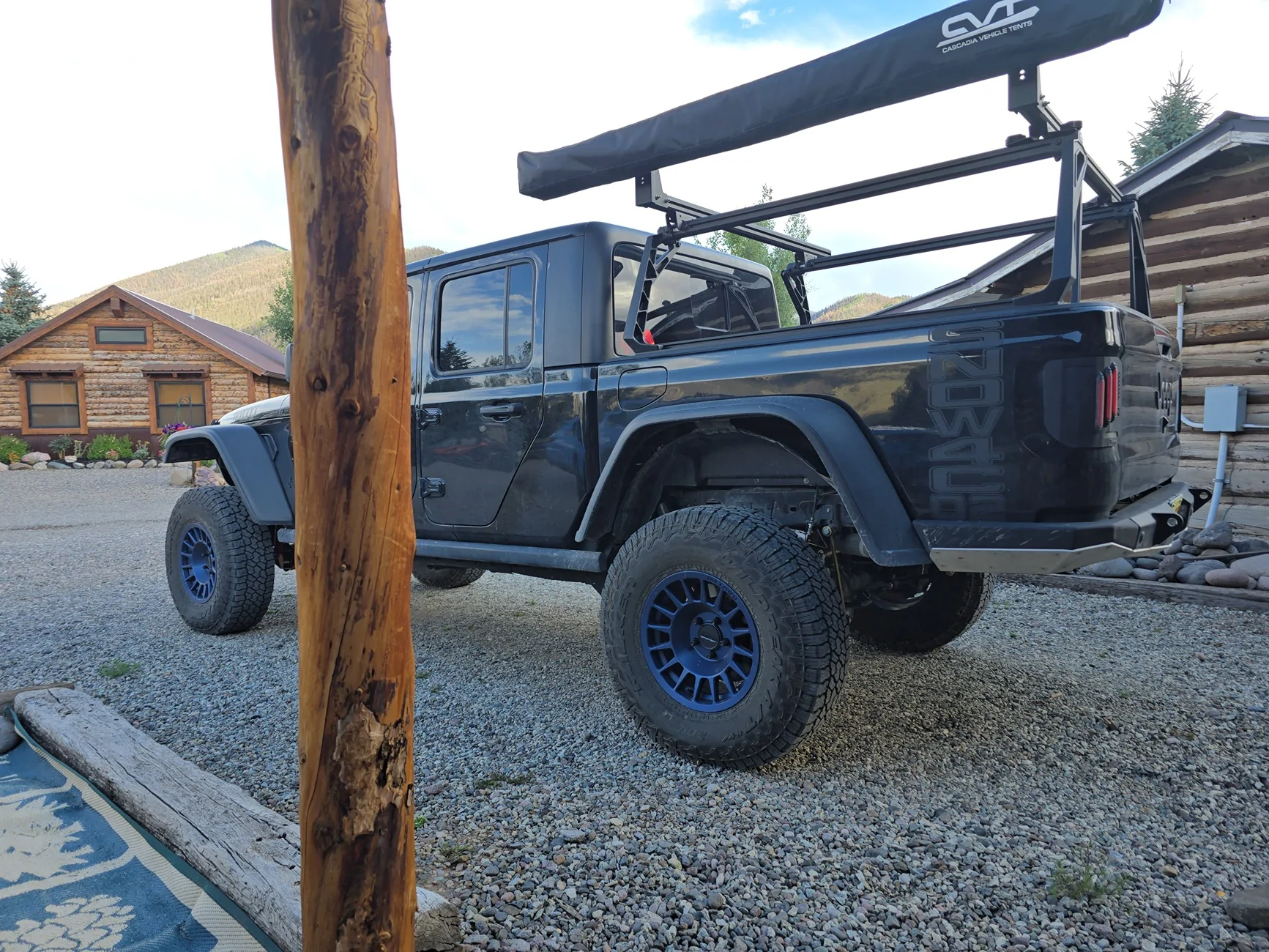

So as the title states. I was cruising with the family in the San Juans this last week and a strange phenomenon happens. When I am in 4lo going slow and the vehicle shifts I can hear a flutter noise as the rpm drops (awe exhaust). In 4lo it shifts so much it wants to be in 6th gear doing 10mph and the rpms are super low. It almost feels like it either bogs or over-revs. I try to keep it in drive in 4lo because below 2nd gear at around 3mph idling downhill it lulls and revs up and lulls back down. This flutter does not happen in 4hi or 2hi.
With 35s and 4.88s the gearing is low enough I usually stay in 4hi and hold it in 2nd gear at 10mph.
Vehicle: 2022 Jeep Gladiator Willys.
I bought it stock with 20k miles on in less than two years ago.
Current setup:
Metal cloak game changer 3.5 kit with driveshafts. Rocksport reds. Sway disconnects.
4.88 gears
35x11.5 falkien wildpeaks on method wheels.
Awe trail tuck exhaust.
Afe snorkel, filter and intake pipe.
Amsoil oil changed at 50% since I bought it.
Artec front and rear bumpers
Lietner rack.
Any input would be helpful.
