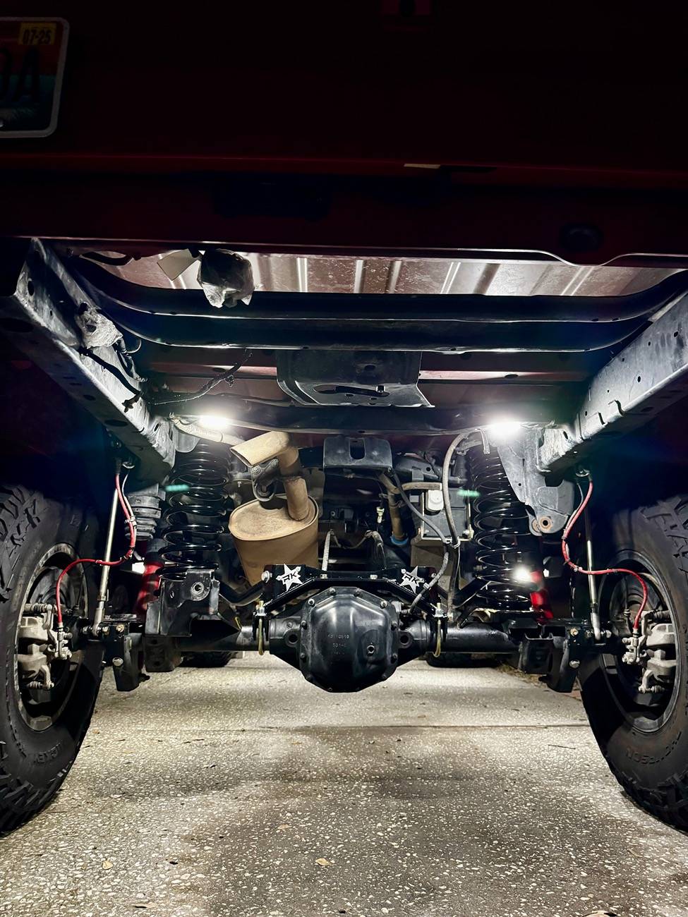

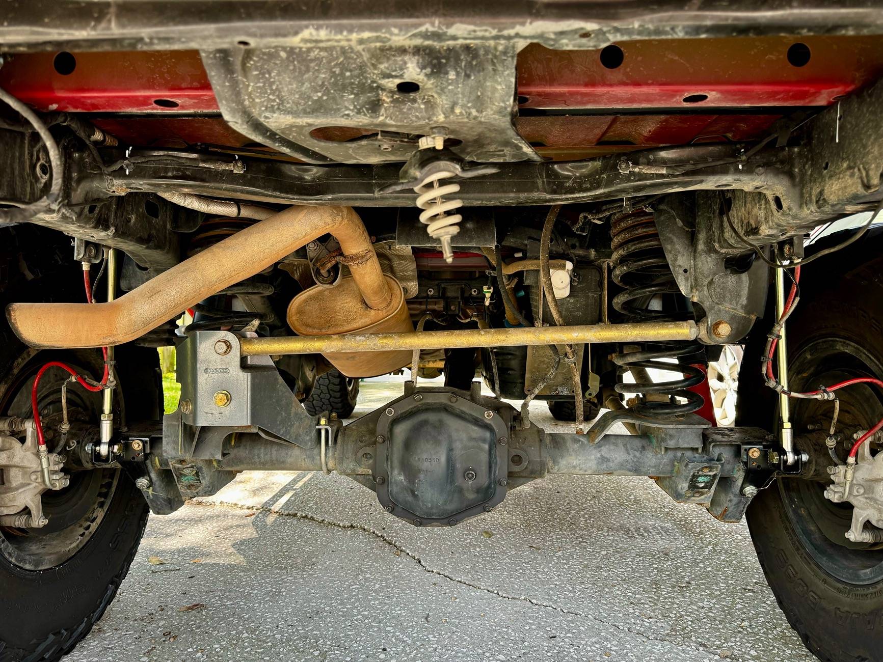

I chopped mine off about a year ago after the Rubicon smashed it up pretty good.
Zero regrets.
I started by leaving a side dump of sorts and left it just past the turn away from the spare about even with the frame rail.
Since then, I've removed my spare from underneath so decided to chop it even higher up.
I don't think the shorted length would be an issue with the spare as long as you leave the heat shield in place but just something to visualize while you're deciding on your angles (or add a tip to direct it away from the spare).
There is a hanger directly on the rearward side of the suitcase muffler so there isn't a ton of weight that isn't supported by a hanger. Was zero issue in either config.
First chop:

Higher clearance chop:
