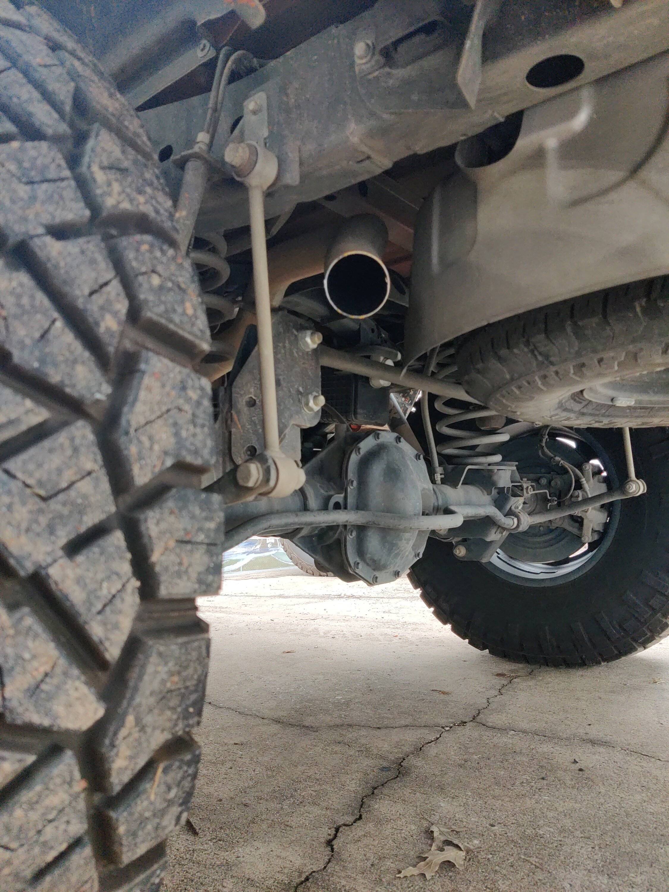

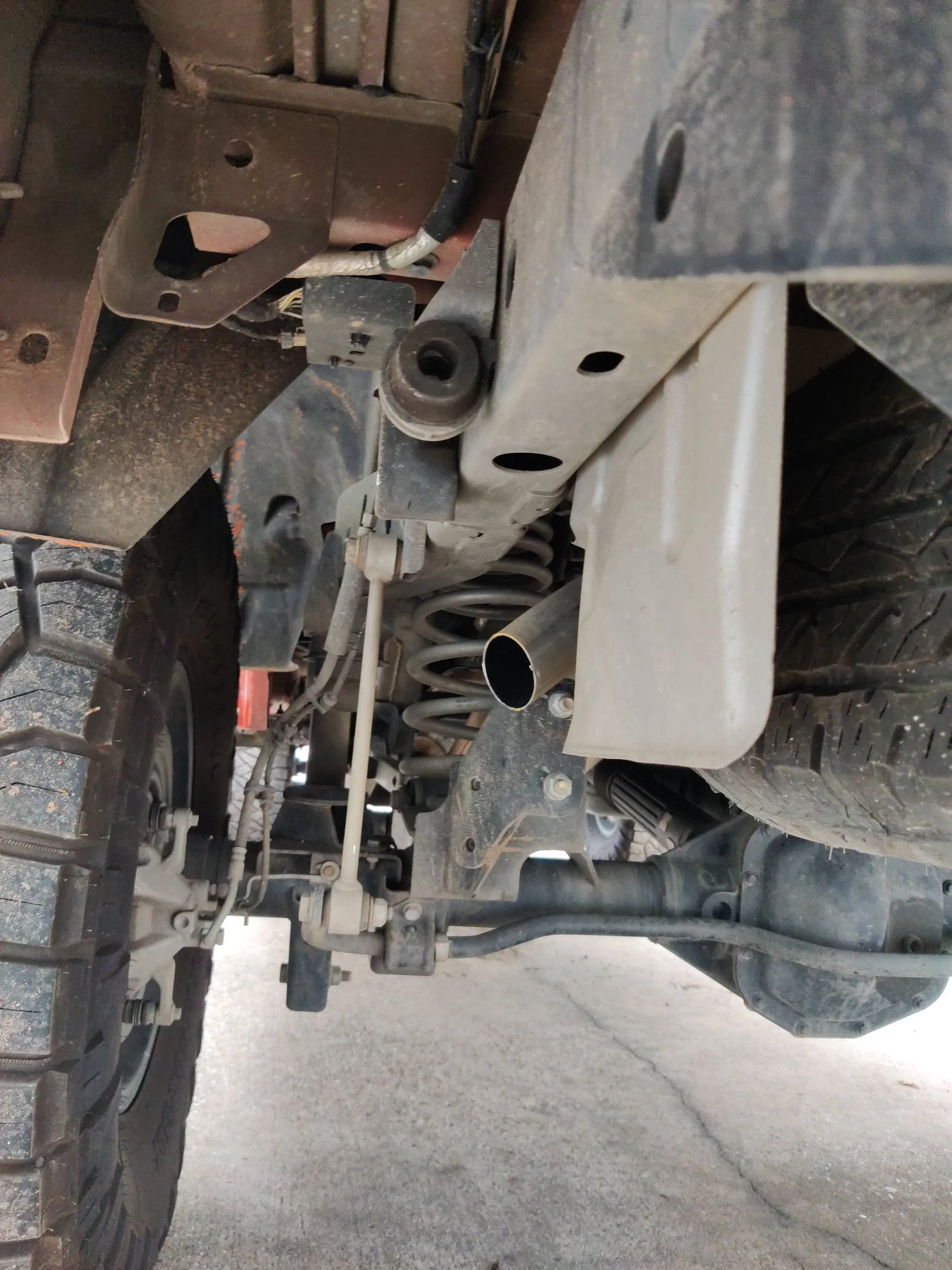

Exhaust cut. Done.

I did this about a year ago. The exhaust volume went up so slightly it was barely noticeable. The clearance and aesthetics are better in my opinion.

I'm interested to hear the suitcase and rear resonator cut out together.
I've heard removing the suitcase is a negligible sound difference, but curious to hear both removed. From everything Ive heard, the front res has to stay to reduce drone.
I think Magnaflow has a system that does this. But it would be cheaper to do it to the stock exhaust, assuming it doesn’t sound like a 1997 civic hatchback...
Any ECU issues?

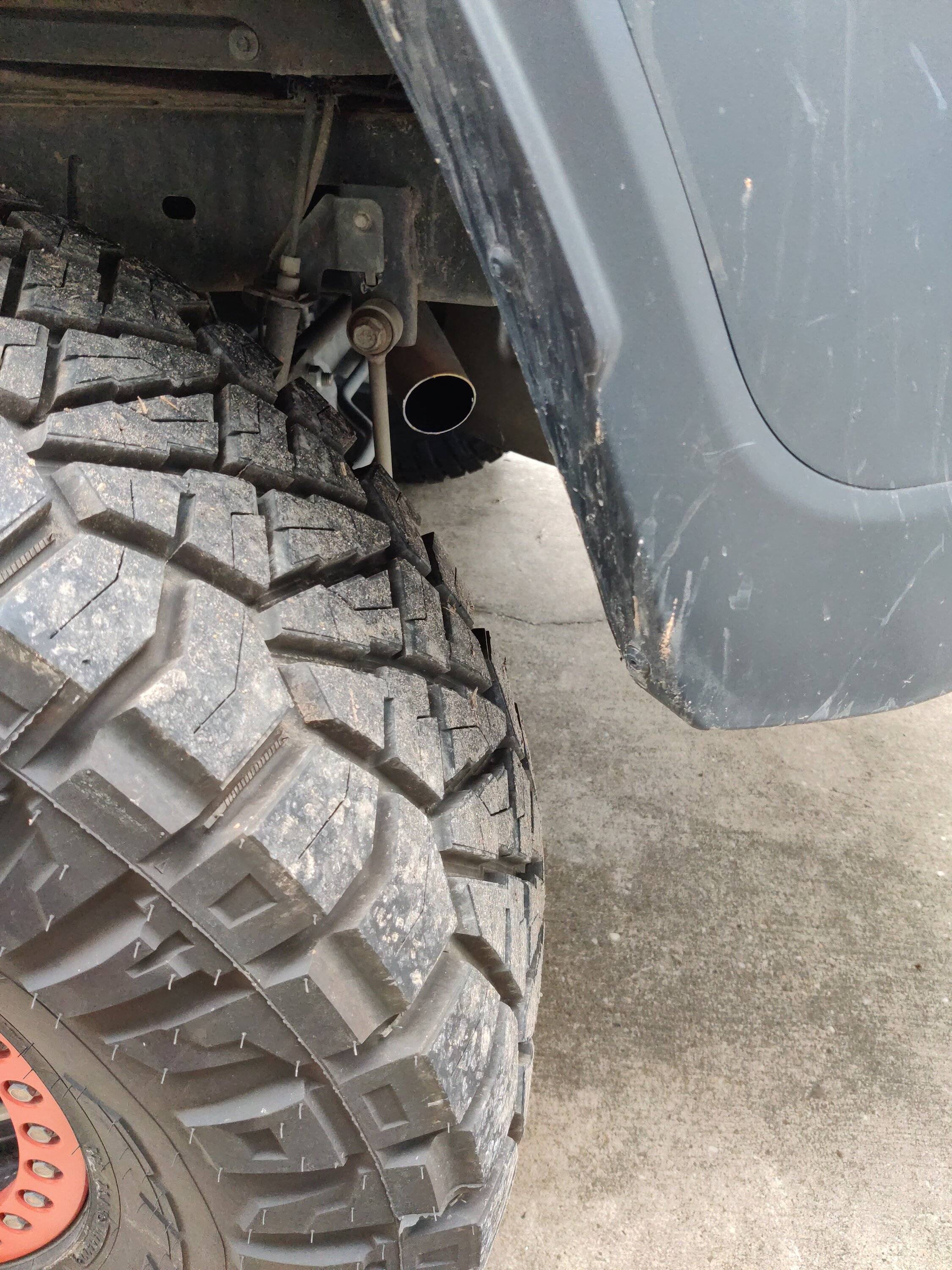

I cut everything off after the resonator. Added a 12in long tail pipe to the resonator with turn down. It's a little louder when past 50% throttle which is fine. Cruising on the highway at 75 there's minimal increase in volume.
