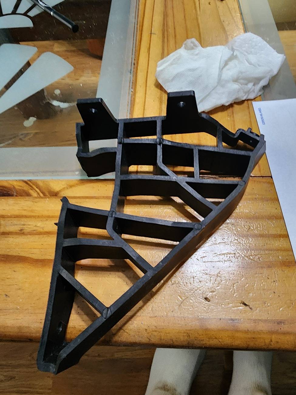

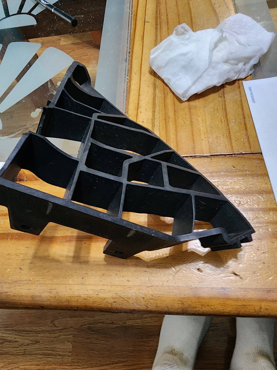

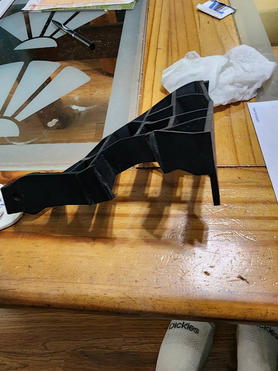

I need some help I took my driver's side fender off on my 2024 Rubicon and broke this lower plastic piece on the bottom part of the fender does anybody have one that could get
Jeep Gladiator Fender flare removal 20240801_175959
Jeep Gladiator Fender flare removal 20240801_180004
Jeep Gladiator Fender flare removal 20240801_180009

Mine aren't connected to the body, but still on the flare. (I'm running aluminum inner fenders) No issues that I can see... this would be your worst case scenario...

get some super glue, and some quick accelerator to glue it back together. Then take a big soldering iron and some metal screen mesh and use the iron to melt the mesh into the plastic infusing it with the plastic. Use the mesh to reinforce the areas around the crack.
It wouldn't be pretty but should hold up.

You can't buy that part without buying a new flare.
So, either try to glue it back together or run without it.
