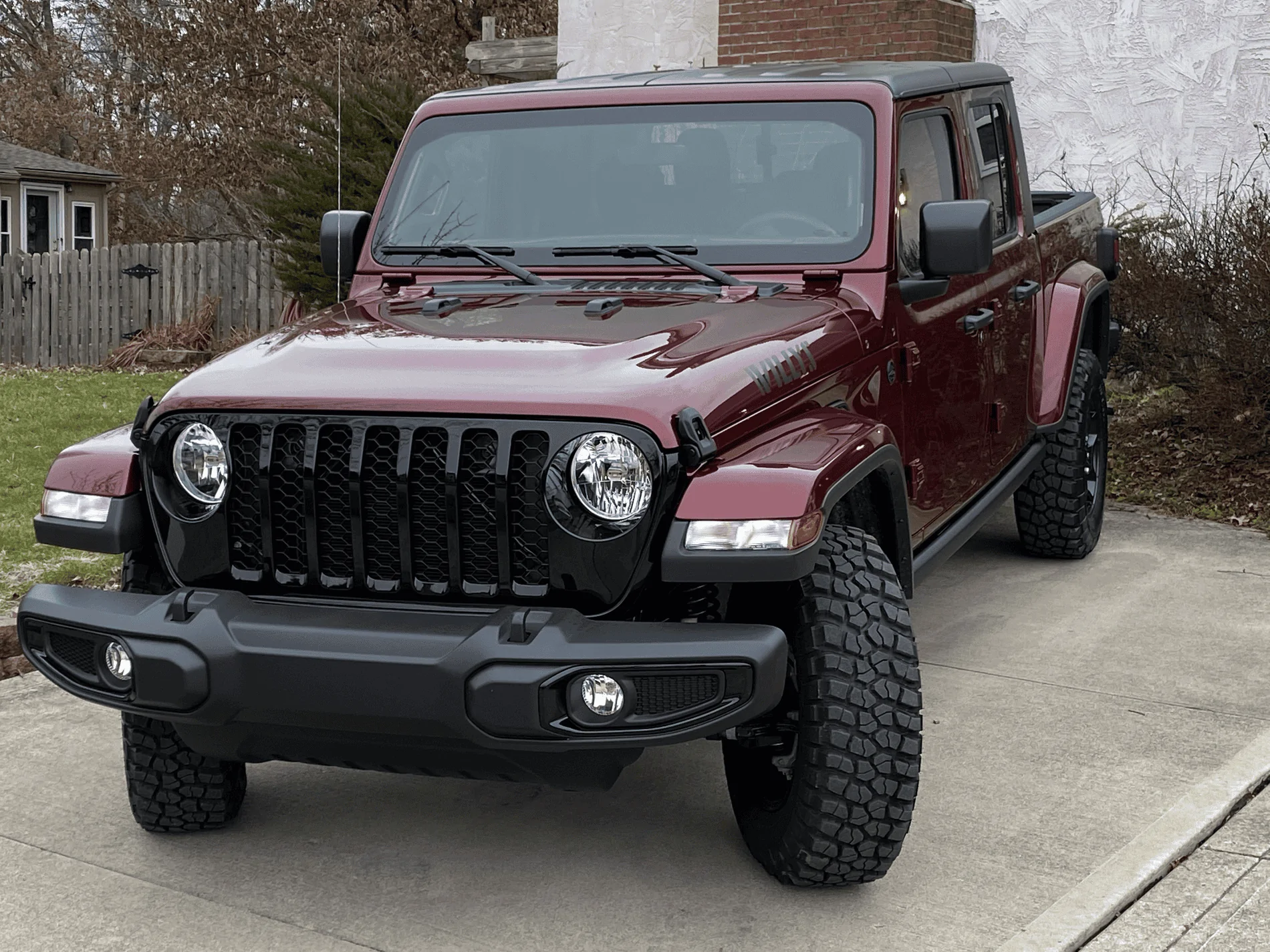

As the title says, the fog lights work when the parking lights are on or when the headlight are on low beam, but if I switch over to Automatic mode, the fogs do not work. Is there any reason for this or is it just a "feature?"
Thanks.

It's a 2021 Willys. Factory
Jeep Gladiator Fog Lights Don't Work In Auto Mode tempImagehivXYh
Halogen lamps. Maybe I'll give the dealer a call.

When in Auto mode, the fog lights won't work until the auto circuit turns the headlights on. It's tied to the light sensor on the dash.
Damn, that may be it! Okay, mystery solved. User error...
