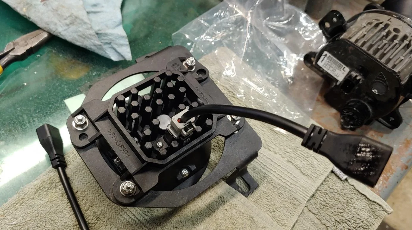

Here's Overland (Rubicon with plastic bumper is the same), 4 mounting ears.
I am mounting one in an adapter bracket that allows them to work in Rubicon steel bumper -
Jeep Gladiator Fog lights in steel bumper 20211231_104719

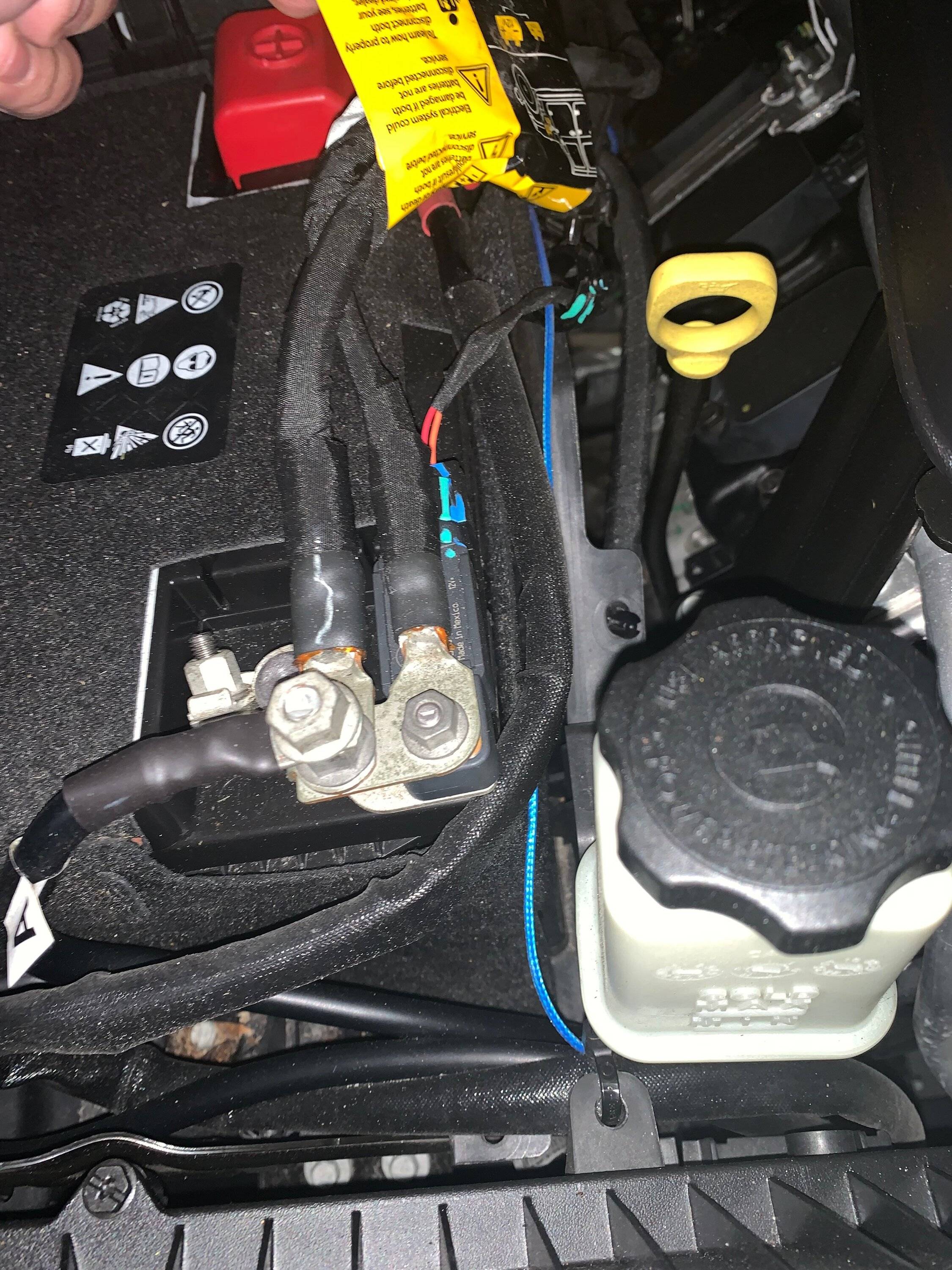

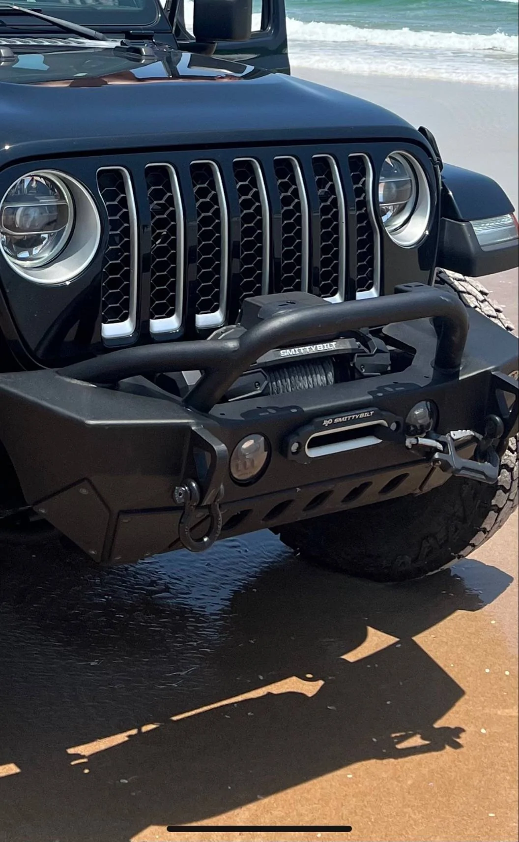

Bought this used, first time jeep owner. Do you know how I can turn on the fog lights based on this set up? I tried messing with the light setting on the driver side corner panel, but nothing seems to activate it. How could it be powered? I thought maybe from the winch battery above?
Jeep Gladiator Fog lights in steel bumper Image (1)

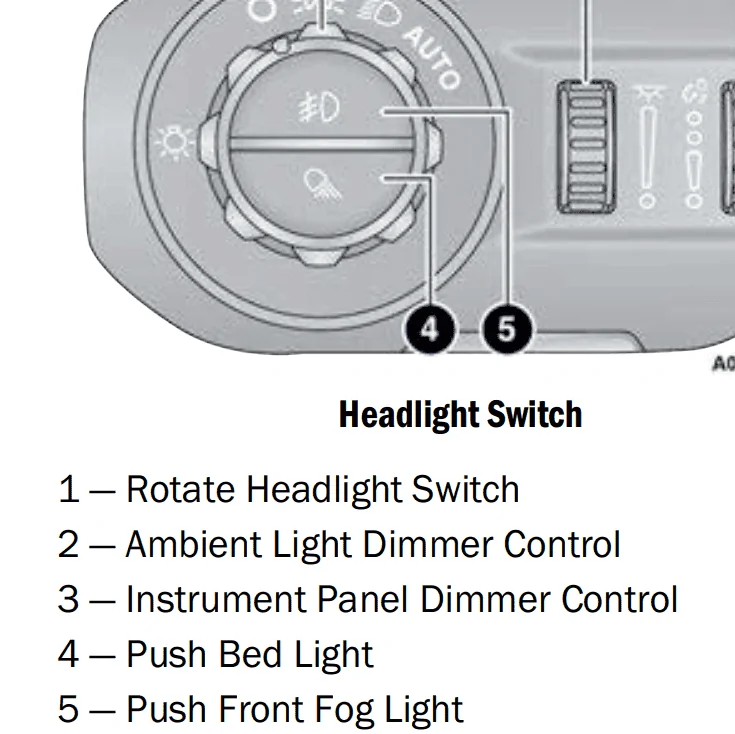

The fog light switch should be part of the headlight switch knob...
Figures but doesn’t work, must be connection then. Just wanted to double check there wasn’t another route…
40,440
53,853
Yes, the top half of this light switch setup. Marked #5 in the manual - sort of shows a fog symbol.
The bed light is more tricky - it shows a downward-pointing light, not a bed.

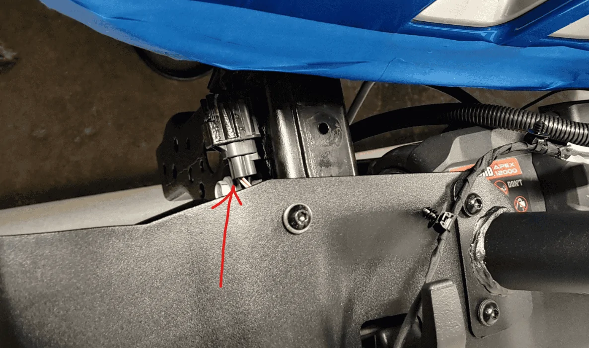

The factory fog light connector is on the right side of the right frame rail right behind the bumper.
Jeep Gladiator Fog lights in steel bumper 1700108077596
