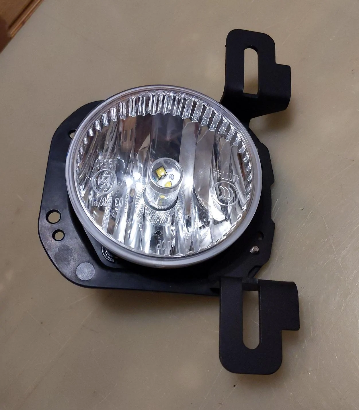

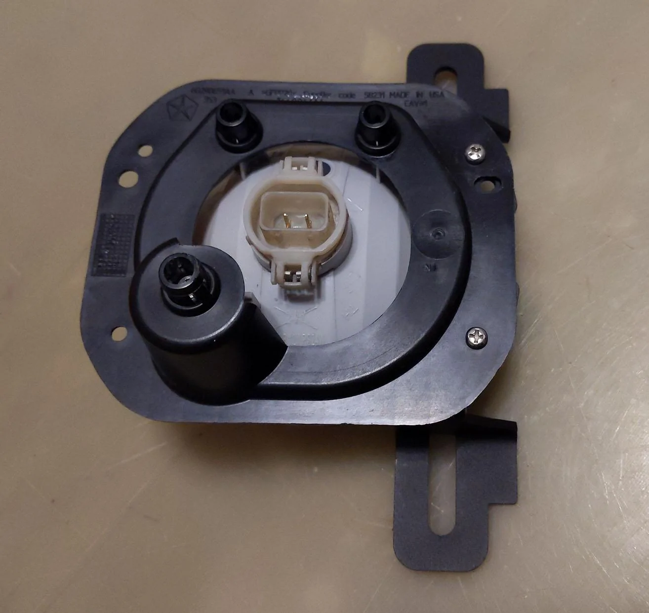

I could be wrong, but I think these halogen lights match your plastic bumper LEDs and the adapter is what you need to install them in a steel bumper. These adapters say they are for a JK and I don't think I test fit them, so you may want to get some designated for the JL/JT.

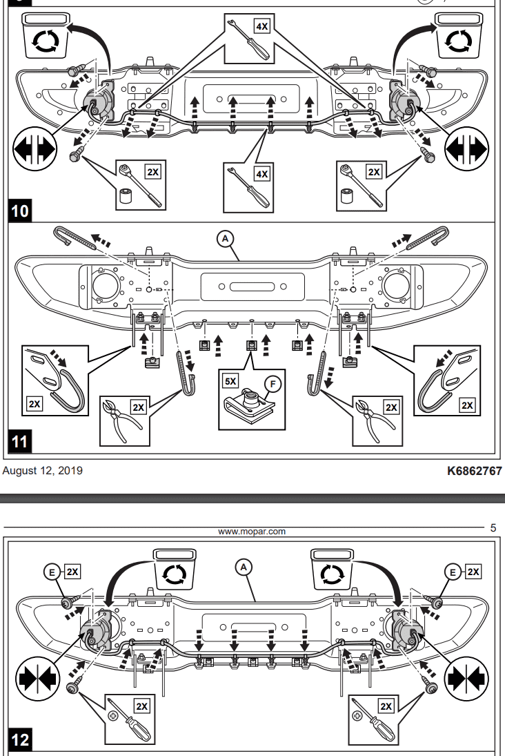

From the instructions, it looks like the bits, including the lights, from the factory steel bumper work on this one and those adapters should work. Here's the link to the ones I bought, but they are specified for the JK. https://www.amazon.com/gp/product/B07SNSHVFK/ref=ppx_yo_dt_b_asin_title_o09_s00?ie=UTF8&psc=1

To be clear, the steel bumper when bought as a part comes with the correct lights installed (LED). There are various other bits and pieces needed, that are all cataloged in a multi page thread from a year or more ago.

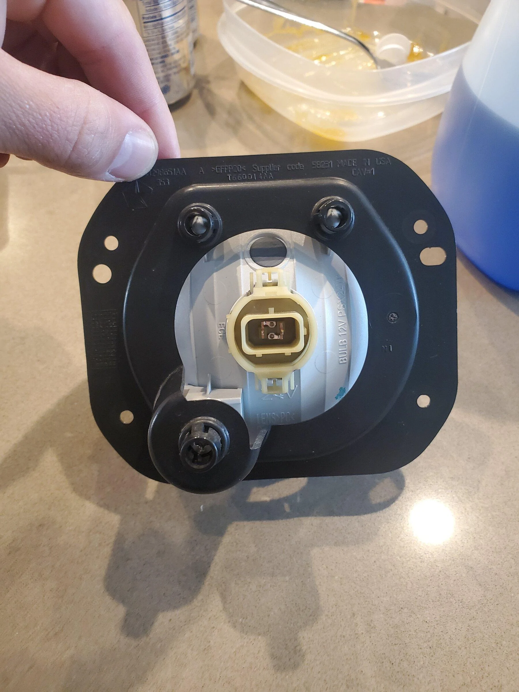

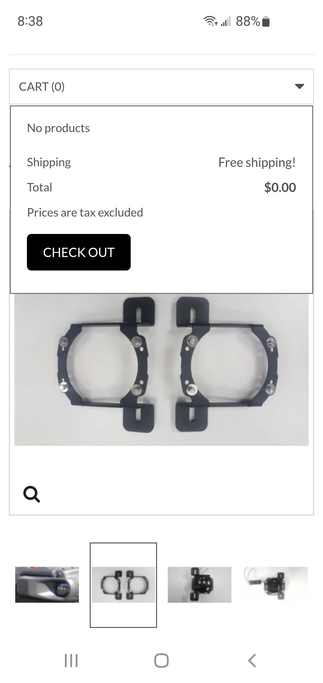

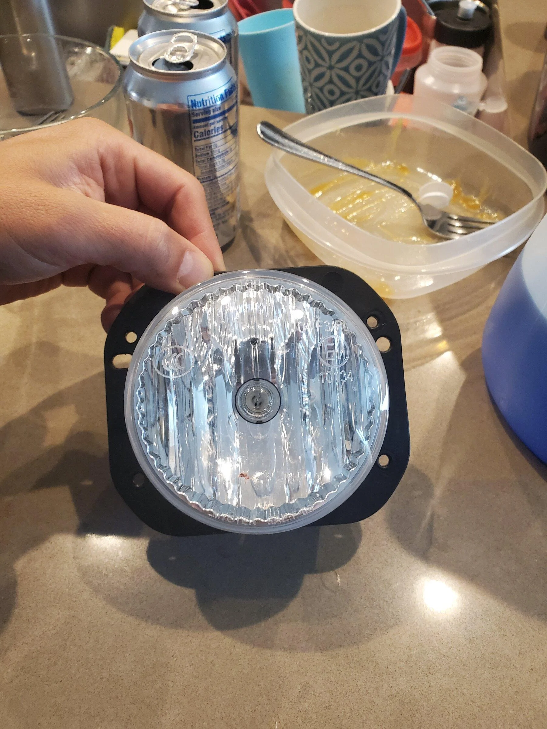

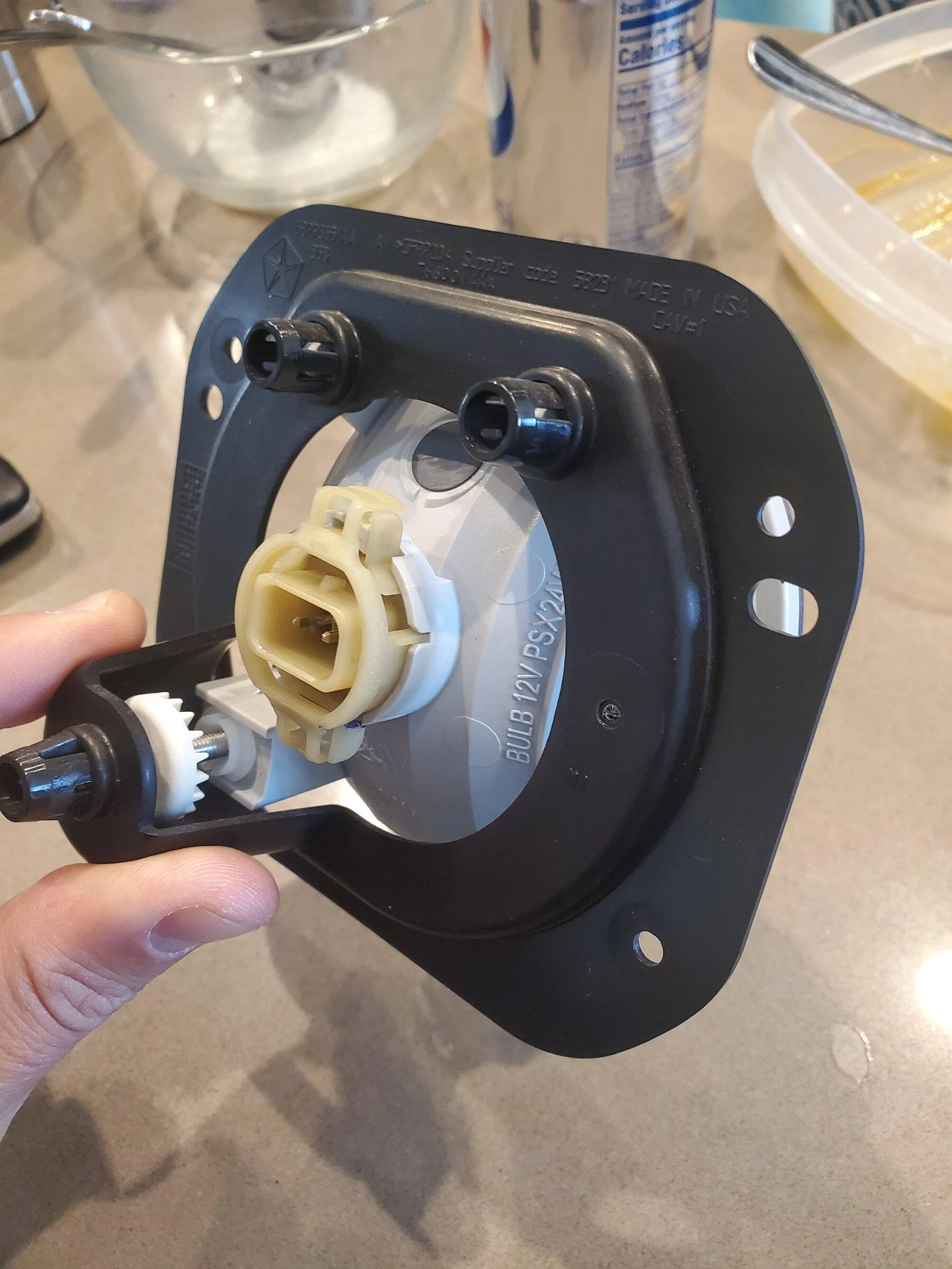

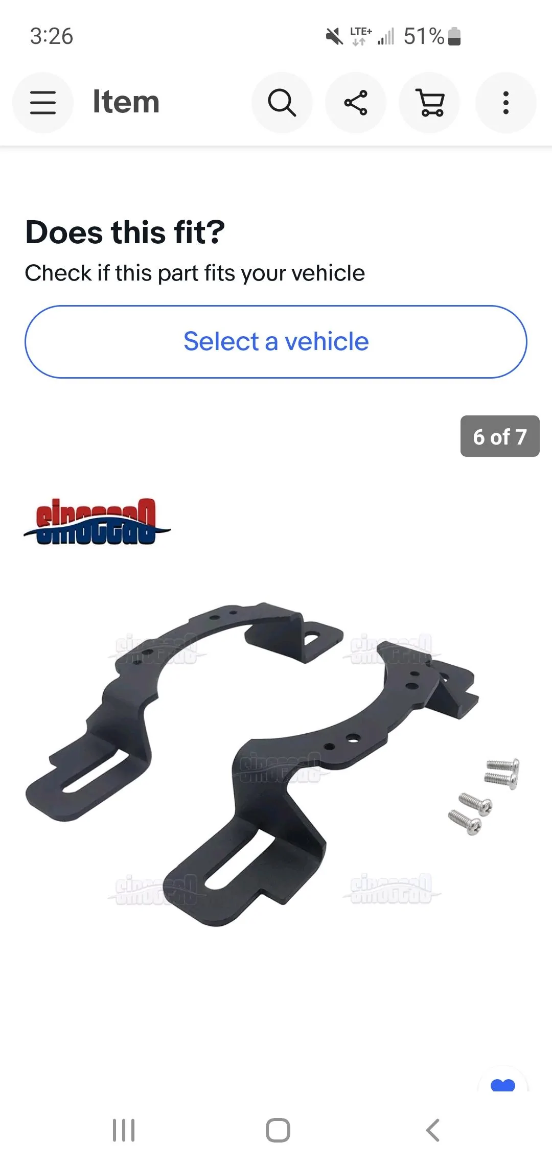

Sorry to revive and old thread but did those brackets work to fit those fogs into a mopar 3 piece steel bumper or the knock off version? I have the same fogs and need to know what i need to have them fit into the steel bumper. See pics. I also ordered 2 sets of different brackets. See those pics.
