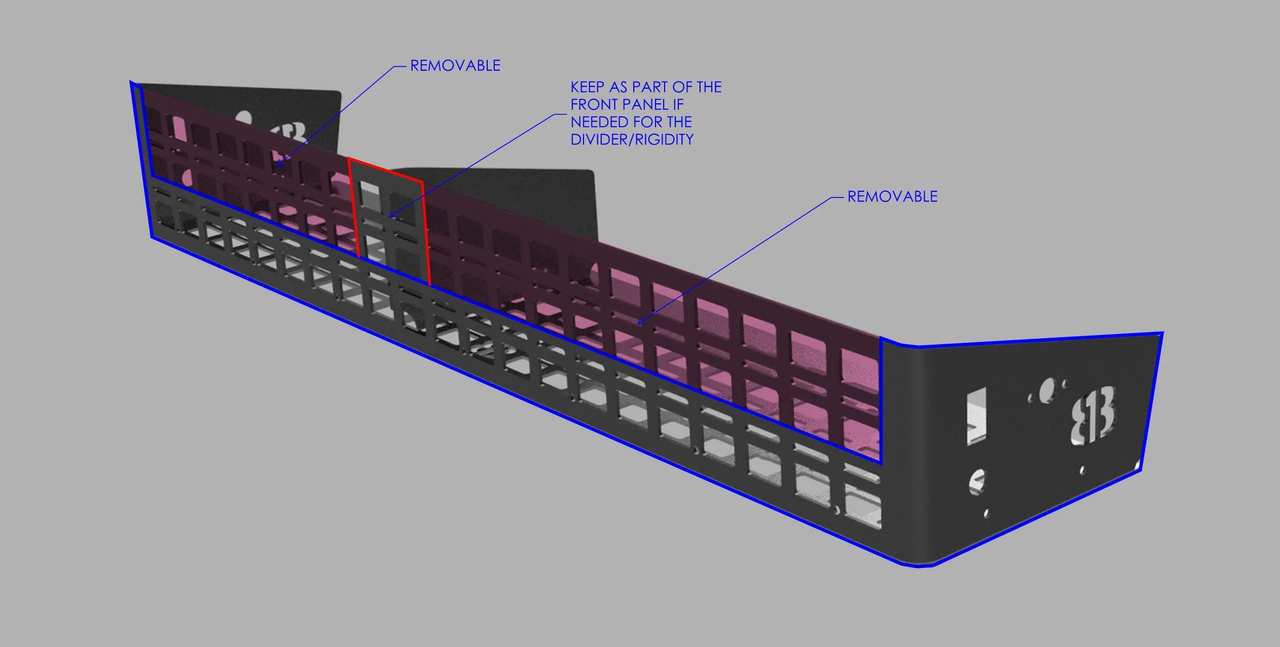

I was thinking of something like this. Keeps the same idea but allows for access to the cubbies. Even if another 1 or 2 molle squares needs to be added to the front for a location for a lock would work. I would be fine with the pink portion if it just completely comes off instead of being hinged. Just my 2 cents.
Great markup! Yes, it could feasibly be done with how you have it marked up. But, I believe with the front panel being changed to three pieces it would weaken significantly since it is only 1/8" alum. You would also be adding hinges. If using locks, there would need to be a lock on each side of each section (4 total) unless there was some sort of lock similar to a garage door to where it slides a bar on each side once the center lock is turned. But you would still need at least two locks. Add on the two locks that are holding down the seats and you would then have 4 to 6 locks on the bin. Having that many locks in my opinion makes for a poor user experience. But, the biggest issue I can see with having two panels loose on the front of the bin is noise. I think it would rattle like a 1965 farm truck :-D

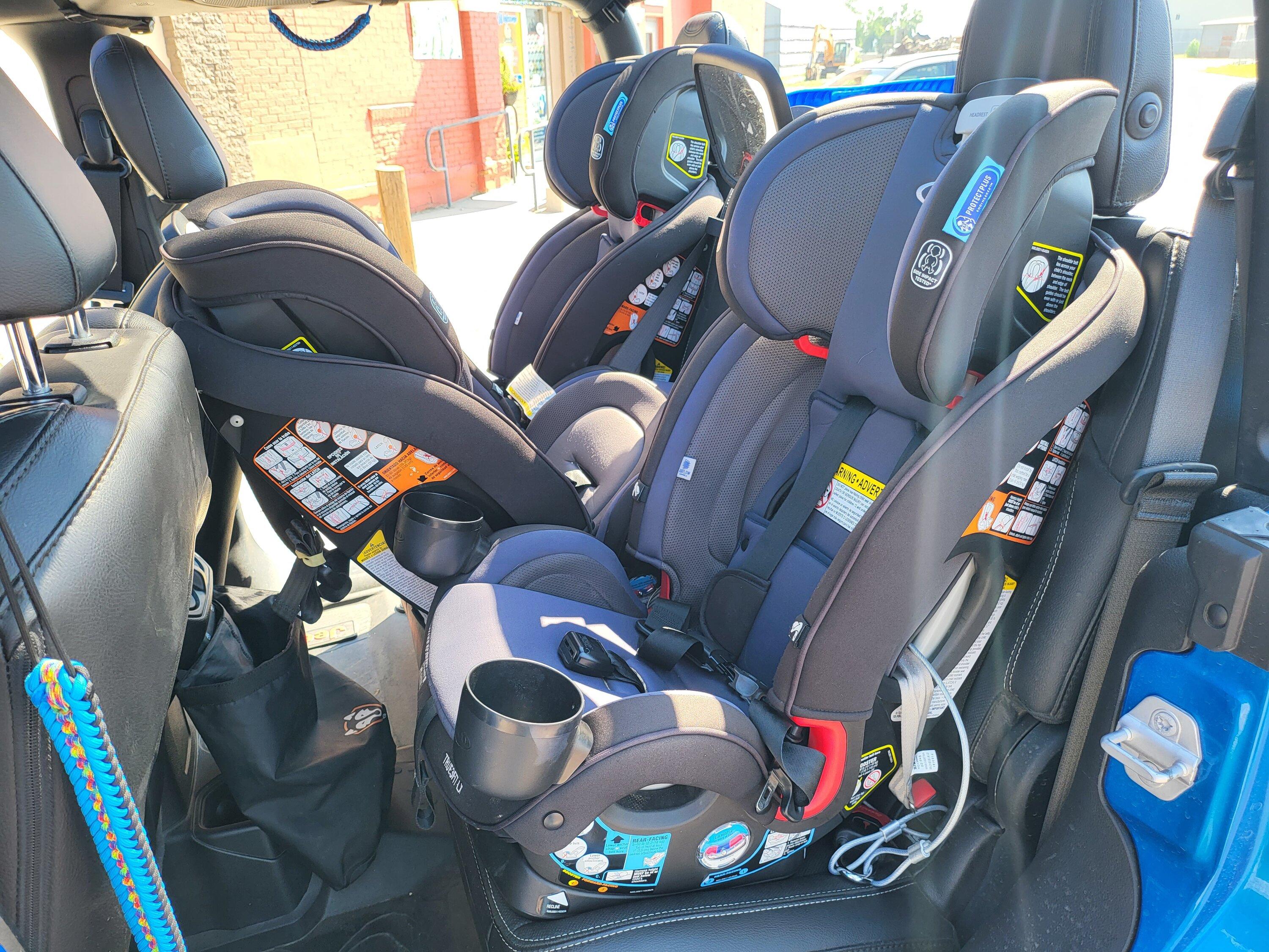

Off topic, but criminy, have car seats changed since my younglings were little. Those look like mini NASCAR racing seats!
