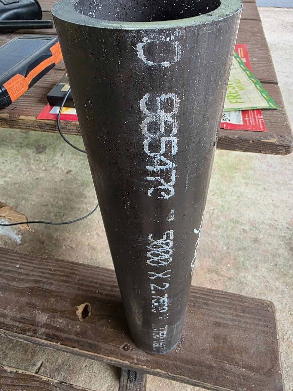

I was looking at that to
3.5 dom 3/8 wall might be the ticket
If i can find a broken axle to tinker with i might give it a try

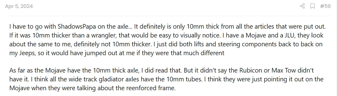

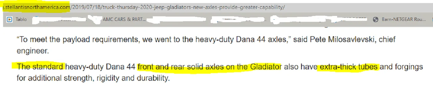

Kind of off topic but related. The OEM started listing wall thickness in mm with the new axles, are they actually thicker than the nearest standard measurements? The 10mm tubes would be .394" vs a 3/8" tube at .375" . The 7mm tubes in JLs would be .276" vs .25". Are they thicker than the 1/4" or 3/8" tubes in reality or is it semantics with some rounding up to sound bigger? I still think simply trussing the axle would do much more for strength than the retube with far less work.

I only need a broken assy to give it a try. I will make a holding and alignment fixture on a large beam of steel
Jeep Gladiator Front axle retube longside 20250926_162937
