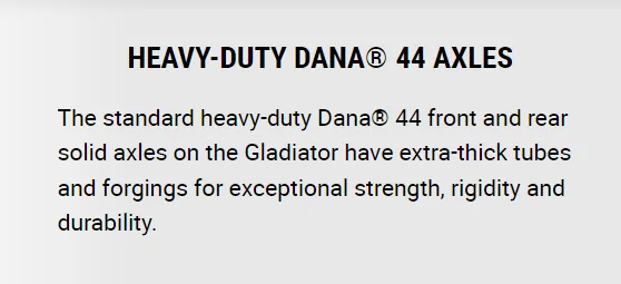

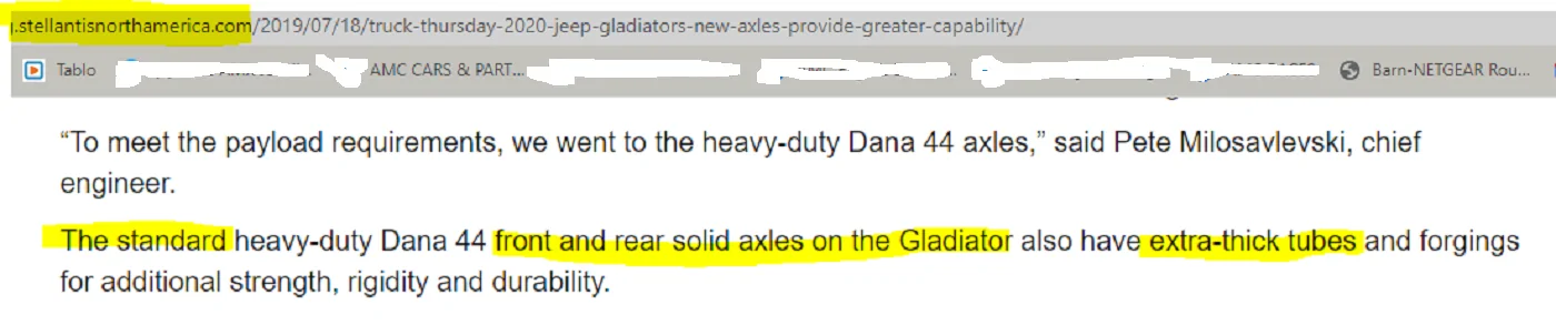

The JL's have 7mm and 10mm, based on which diff size and axle housing.
No, not until the 35" tire version was released. Go dig into the JL side of things. It's even on build sheets - you can read the build sheets and see the differences.
Wrangler never had 10mm until the 35" option. It's a big deal in certain threads on other Jeep sites.
For the JT, the 10mm was introduced and mentioned in many articles where Jeep themselves said "The all new gladiator will have..............." However, at least one of them was focused on the Rubicon and that's where it was assumed - oh, the Rubicon gets it. Actually it was all.
This is old stuff, dating back years, and talked about at great length.
I didn't say this was always the case. But the extra weight of the Diesel engine and Hemi 392 have just justified the need. And yes, the 35's are also driving it. As far as digging into the JL side, I am in that Forum every day and have been for many years.
I'm not sure that you and I can ever agree. So let's agree to dis-agree and call it a day.. :)

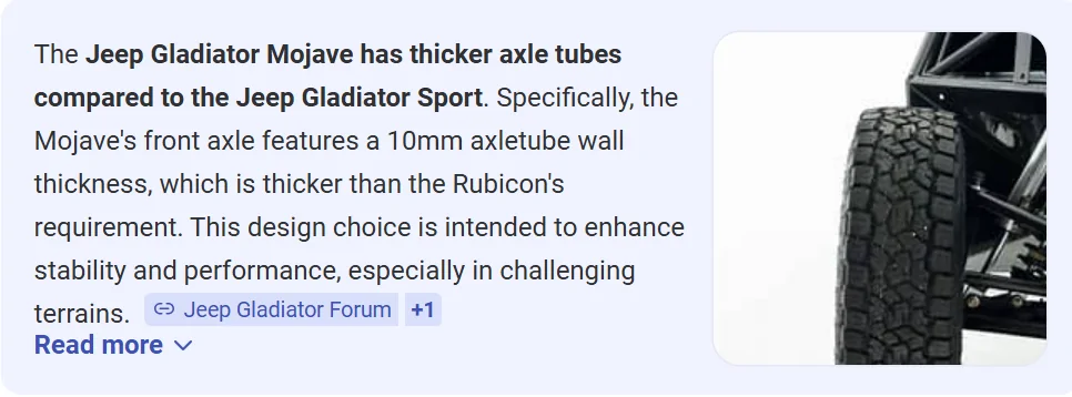

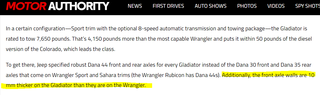

Take this one carefully - they aren't 10mm "thicker" - they are 10mm thick compared to Wrangler axle tubes -> (see how the media messes things up?!)

I suggest you just move on with your day and forgot about this worry until something breaks. The Ruby axle is already a thick walled axle tube (10mm). If you aren't bouncing rocks your fears aren't justified. If you are worried about the FAD housing then get a artec truss and do the upgrades you discuss except the retube.

Somewhere, I have some snips of articles about the upcoming new Jeep Gladiator, from 2017 or 18. It was an engineer talking to some "journalist", the list of features was impressive! However, over 1/2 never came to be. It never happened.
The thing about engineers talking is that they might be talking about engines, but they are a suspension engineer, or an interior engineer and so on. Unless they were involved directly with the specific area in question at the time it was actually created, I'll have questions - like the article from 17 or 18, who knows what area they actually worked in, and, they weren't present and talking about the actually released product.
