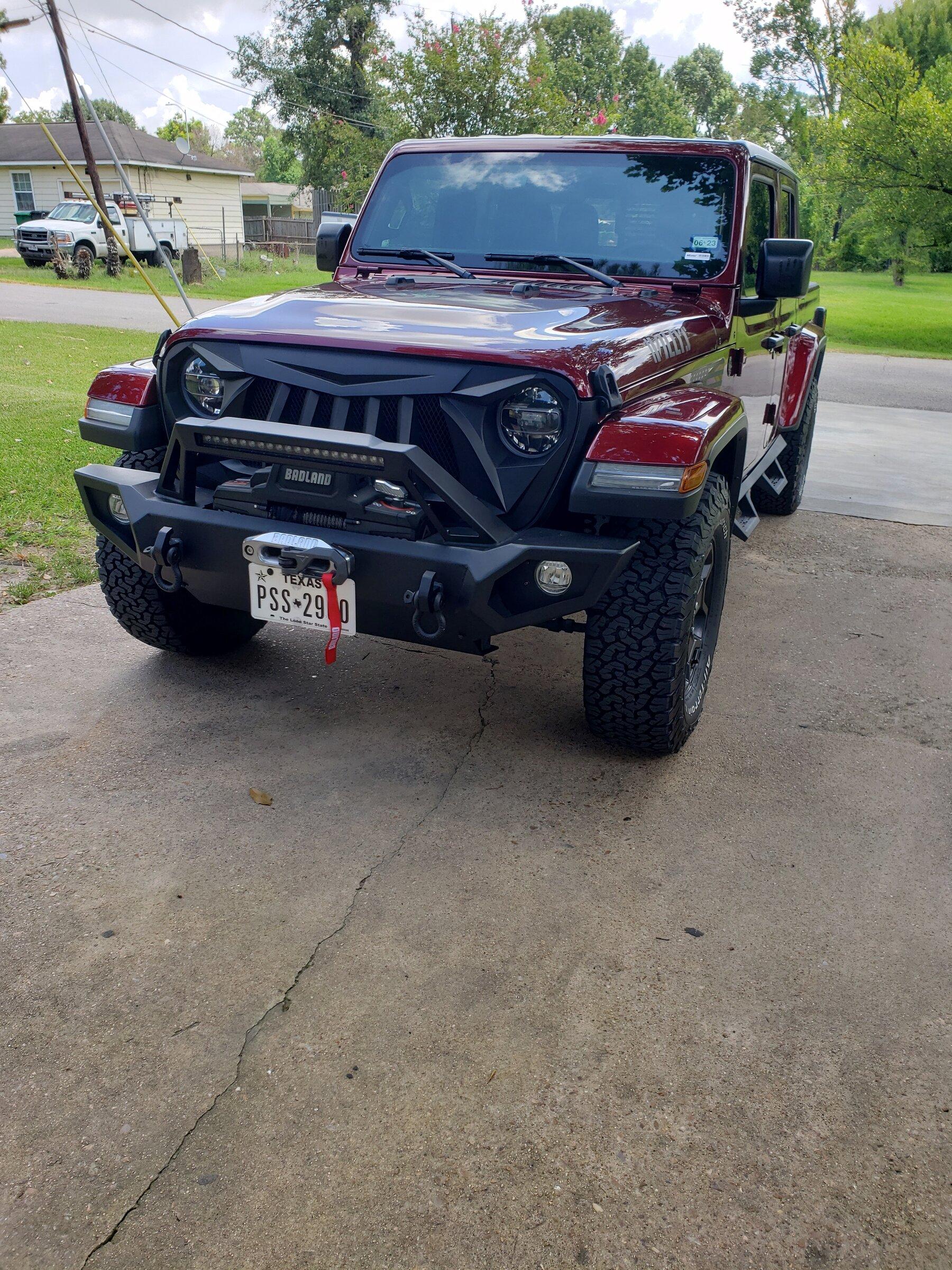

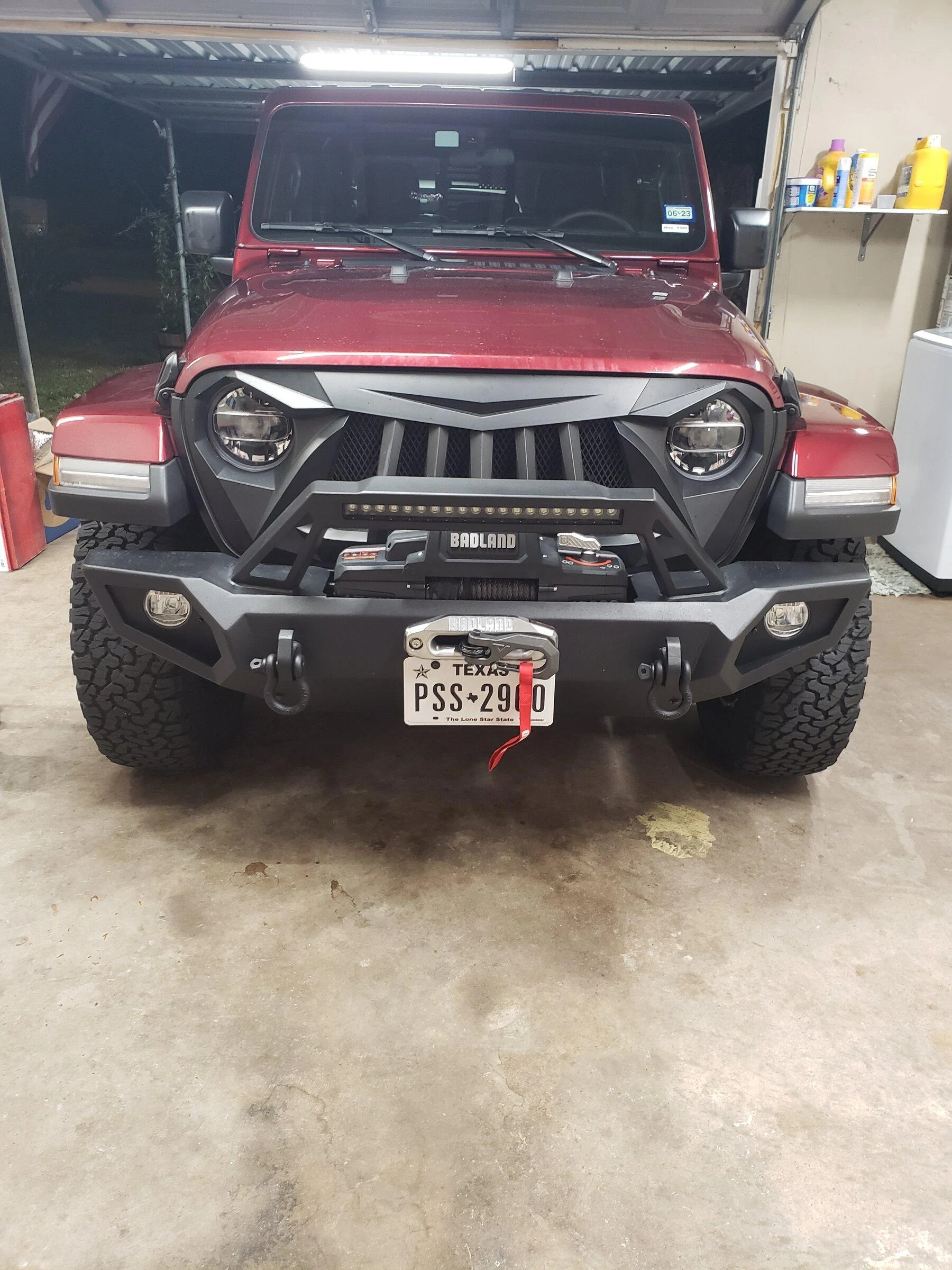

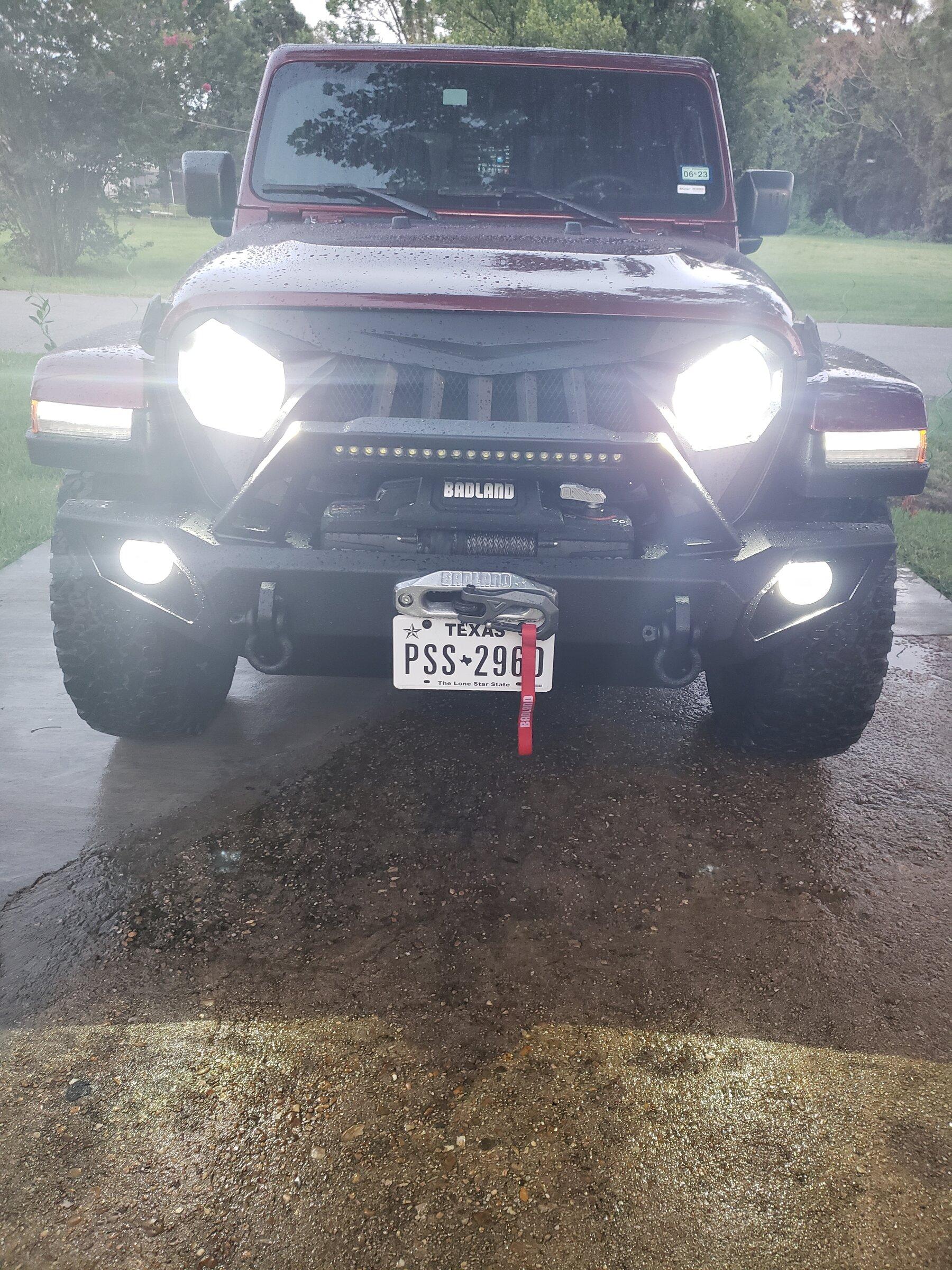

They just say that because one side of one fog is only bolted on by 2 bolts. I secured them good and haven't had any problems.
Awesome, that’s music to my ears. Other then just being held on by 2 bolts they fit really well? Did you secure them by any means beyond the 2 bolts?
No, just the 2 bolts. It is pretty sturdy. My wife told me to just make and weld a bracket but I vetoed that. No need.

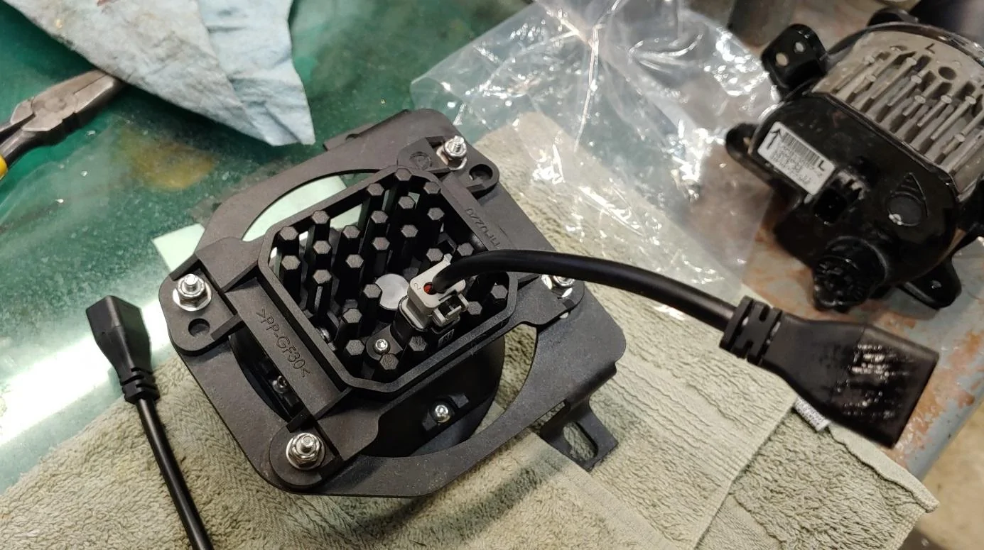

The stock MOPAR steel bumper holds the fog lights in place with two bolts. Can't be too much difference, can it?
You can see the mounting tabs (slightly slotted) in this pic. The fog light bolts to the bracket, the bracket bolts to the bumper with two screws.
The factory MOPAR fog lights for the steel bumper bolt the same way but without this adapter bracket. It's pretty stout, IMO
