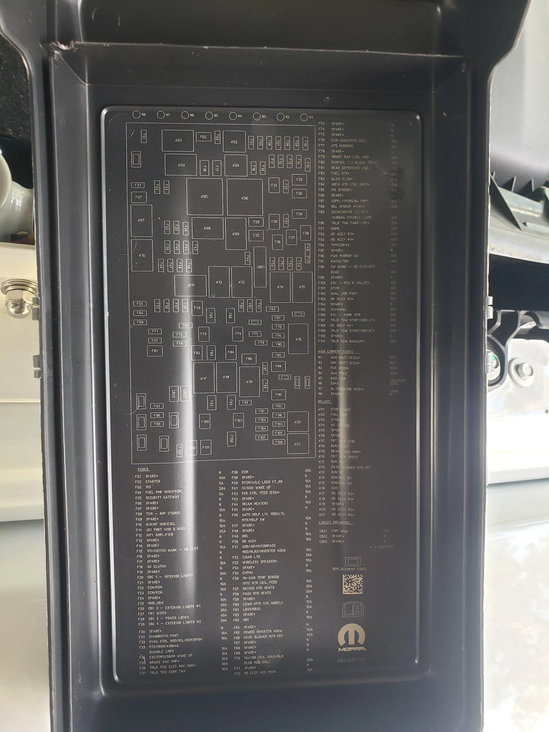

Hi I'm looking to install a kill switch to cut power to the fuel pump relay. I had a look online to see where in the fuse box it is but it isnt very clear. Anyone able to point me to it?

The one under the hood, behind the battery? Take the lid off and see which relay it is K02 is where mine is located.
Jeep Gladiator Fuel pump relay location? 20220527_091427
Jeep Gladiator Fuel pump relay location? 20220527_091435
