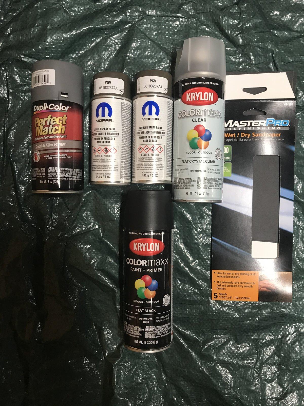

Then I came across this posting where MAustin re-painted his red instrument panel in Gator and you can see that is the correct code and part number, What is disturbing is most (all?) Mopar sites are still listing the description as both "Gator" and "Deep Beryl Green Pearl."
This is the rattle can special. I sanded everything with some 800 grit sandpaper, then two coats of primer, three coats of Mopar Gator touch up spray paint that I found online, and finally two coats of a flat clear coat. I painted all the chrome around the instrument panel and vents black.

The dealerships have PGV (gator) available in the spray paint, but they haven’t come out with the touch up pen yet. The last time I checked was last week. I honestly haven’t looked at any other places because I was worried about getting the beryl green. I tripled checked with the website I got the paint from before I ordered since the dealers didn’t have it in stock yet at the time.
