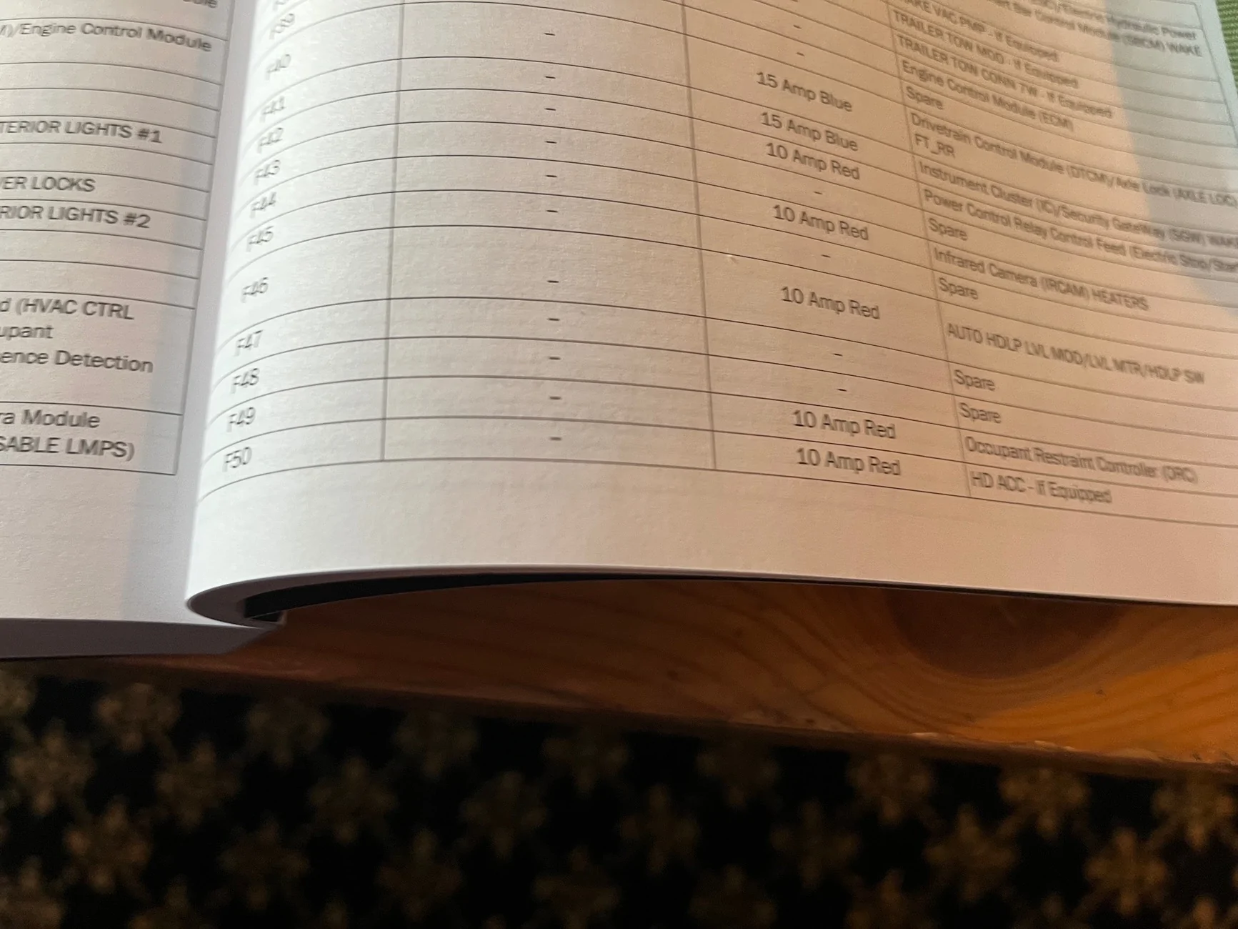

If I pull fuse F50 will that disable ACC and nothing else?
thanks!
250
40,606
54,302
Hi all
thanks!
Why would you want to disable adaptive cruise control?
Simply - don't use it.
If you are looking at the fuse panel key - there's likely no fuse there anyway, it's for a heavy-duty accessory, thus the HD ACC* and the N in the fuse value column

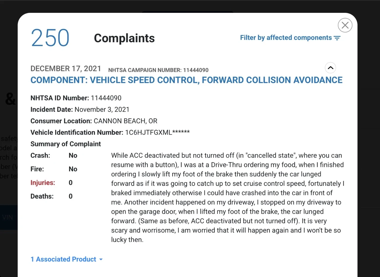

Because I watched (from the backseat) my daughter have the sudden acceleration experience listed in a few NHTSI reports for my year of Gladiator
hereā€˜s what my owners manual shows
I’m guessing emergency braking would also be disabled
Yes, HD ACC, not adaptive cruise control. ACCESSORY.
Mine has ACC but there is no fuse in the 50 spot because I don't have a heavy-duty ACCessory.
That's not for Adaptive Cruise Control-see below - I DO have ACC but my 50 spot is empty because I don't have a HD ACCessory.

I guess I've not seen a reported issues with sudden acceleration. Is there a TSB or recall or is it that the complaints on the web site don't understand that after you pull around that slow semi, it's going to accelerate again?
Some of the complaints on NHTSA are hilarious. But if this is real, it's not one I'm familiar with.
