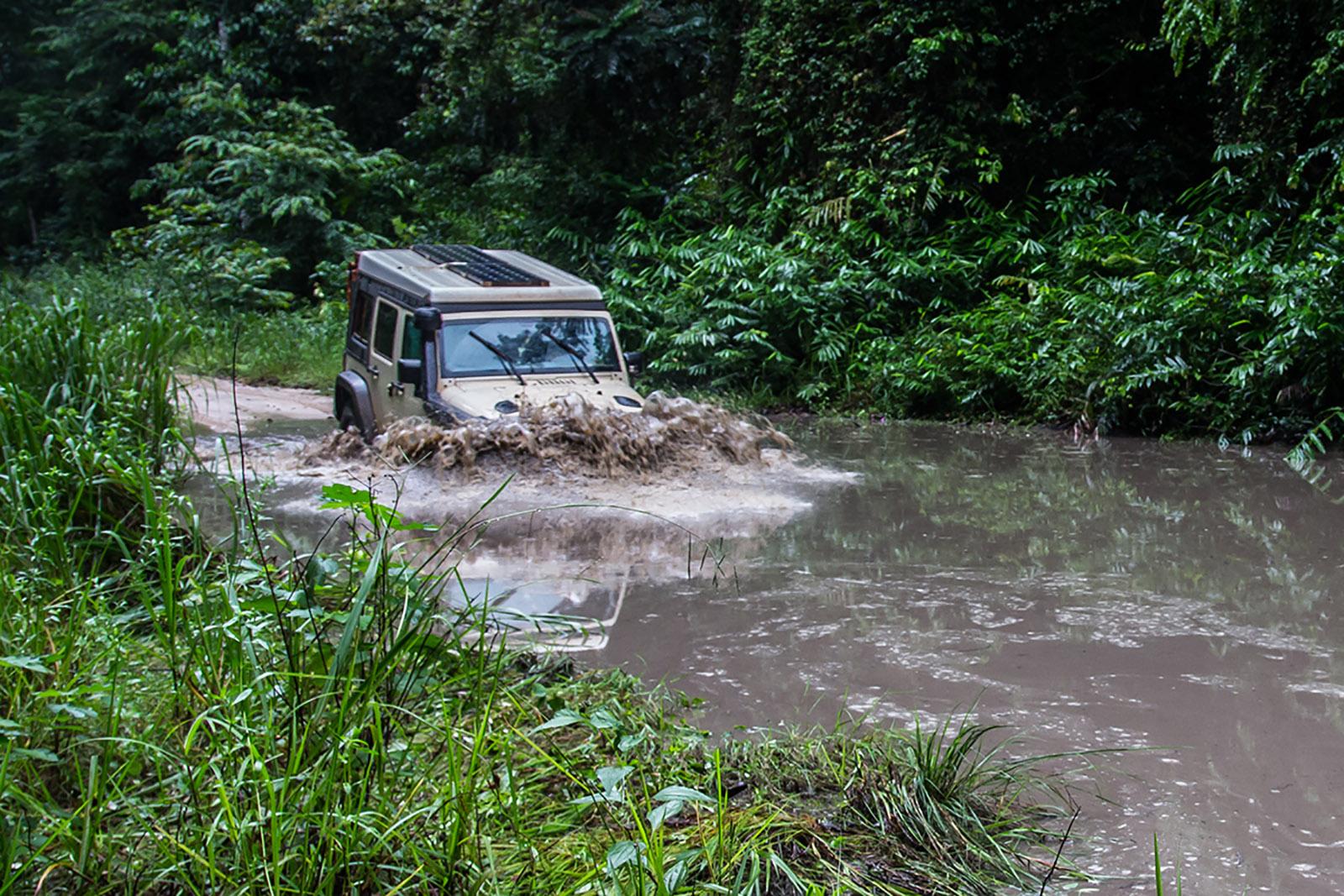

Hi all,
I don't set out aiming to drive through deep water, though sometimes it's completely unavoidable.
Jeep Gladiator Gladiator Build & Adventure - 18 months around Australia with The Road Chose Me gabon-jeep-river-crossing-loango-np-med
The snorkel looks cool, though there is another job that needs to be done to prepare your vehicle for deep water - extending the breather hoses on the axles, transfer case and transmission.
This is another "Essential build" item you won't see discussed in magazines or shown off at SEMA, but it will go a long way to avoiding problems when you're in the remote corners of the world.
In the video I run through the why, the what and the how, showing exactly how I did it on my Gladiator.
-Dan

... extending the breather hoses on the axles, transfer case and transmission.
-Dan
On of the first things I've been doing since my '01 Tacoma sucked in water while doing a crossing in Anza Borrego on the Coyote Canyon trail when the water was deep. The Toyota's breathers were right on the diff with no extension from the factory at all. I guess the rapid cooling of the diff allowed the breather to suck in water and that was that.
It's not sexy or a talking point but it's a good essential modification to do when "preparing for the worst". Great video as always!
