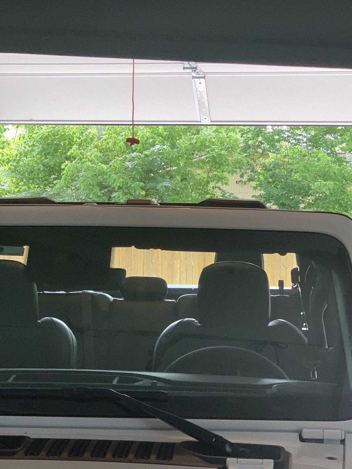

Question: with 37's and a 4 inch lift, will your gladiator still fit in the garage?
I've been trying to find (with no luck so far) a picture of a gladiator in a garage from a perspective where I could see the height from the top of the glad to the garage door. Looking at a roof top tent and want to check clearance.

Current height w/the 37's is 75" to the top of the roof. My garage door opening is 92" so it should fit comfortably. I have uploaded a pic looking from the front to the back with the door open. Hope this helps.

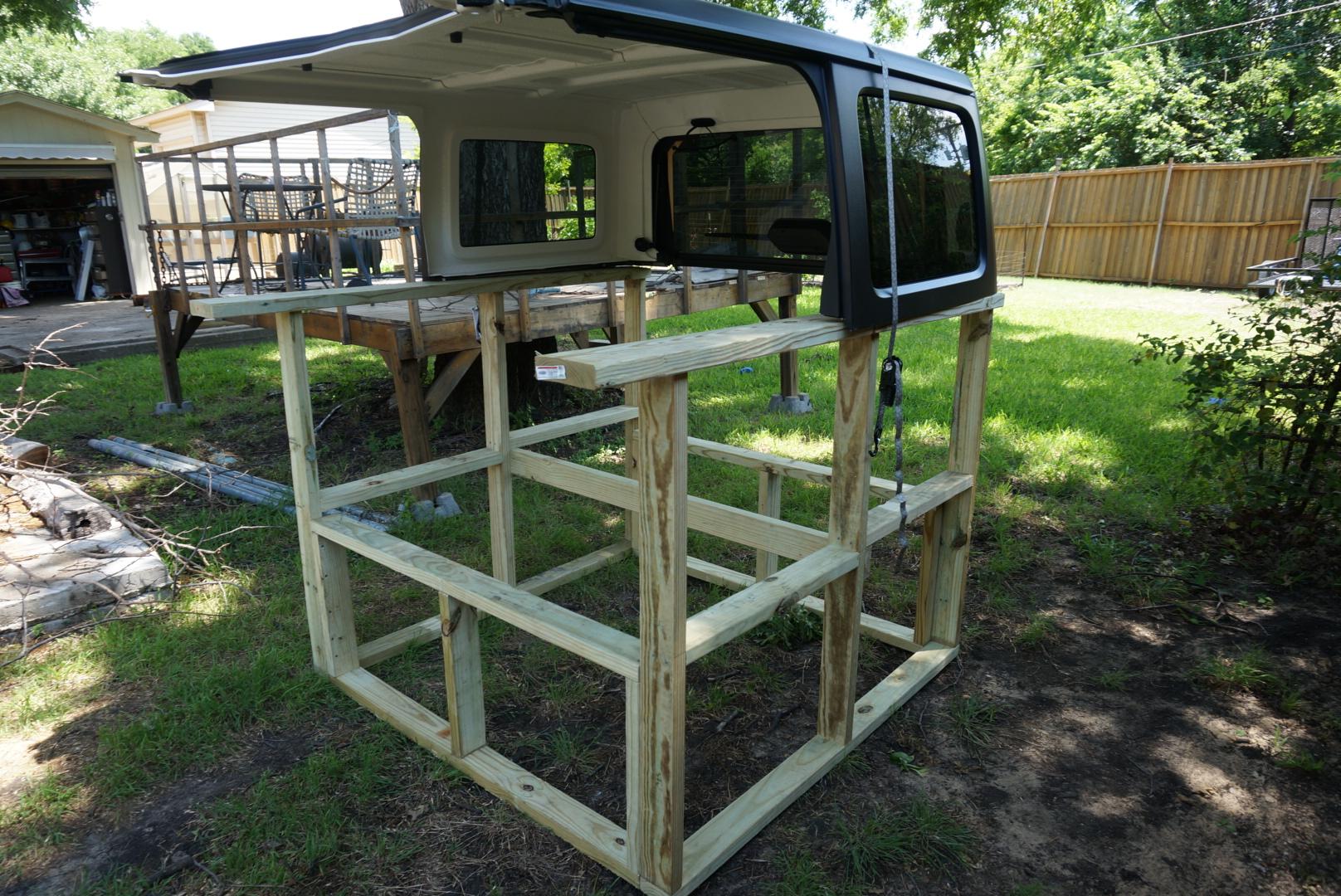

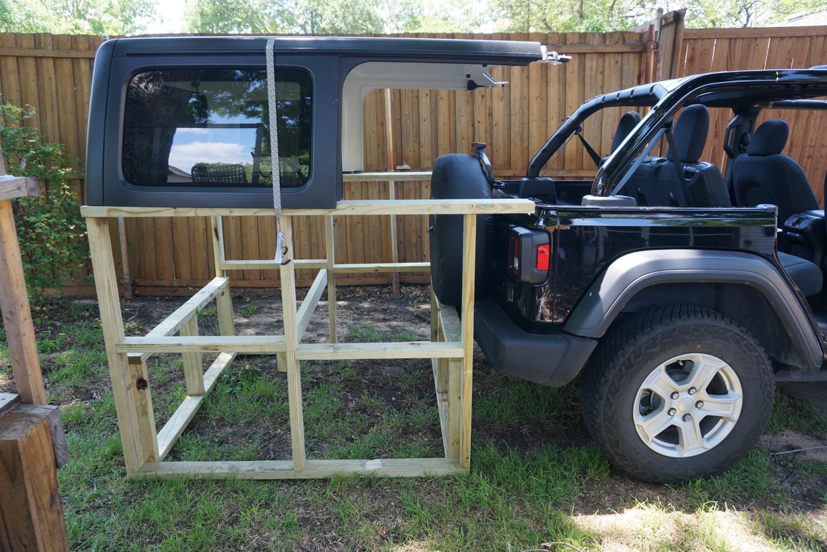

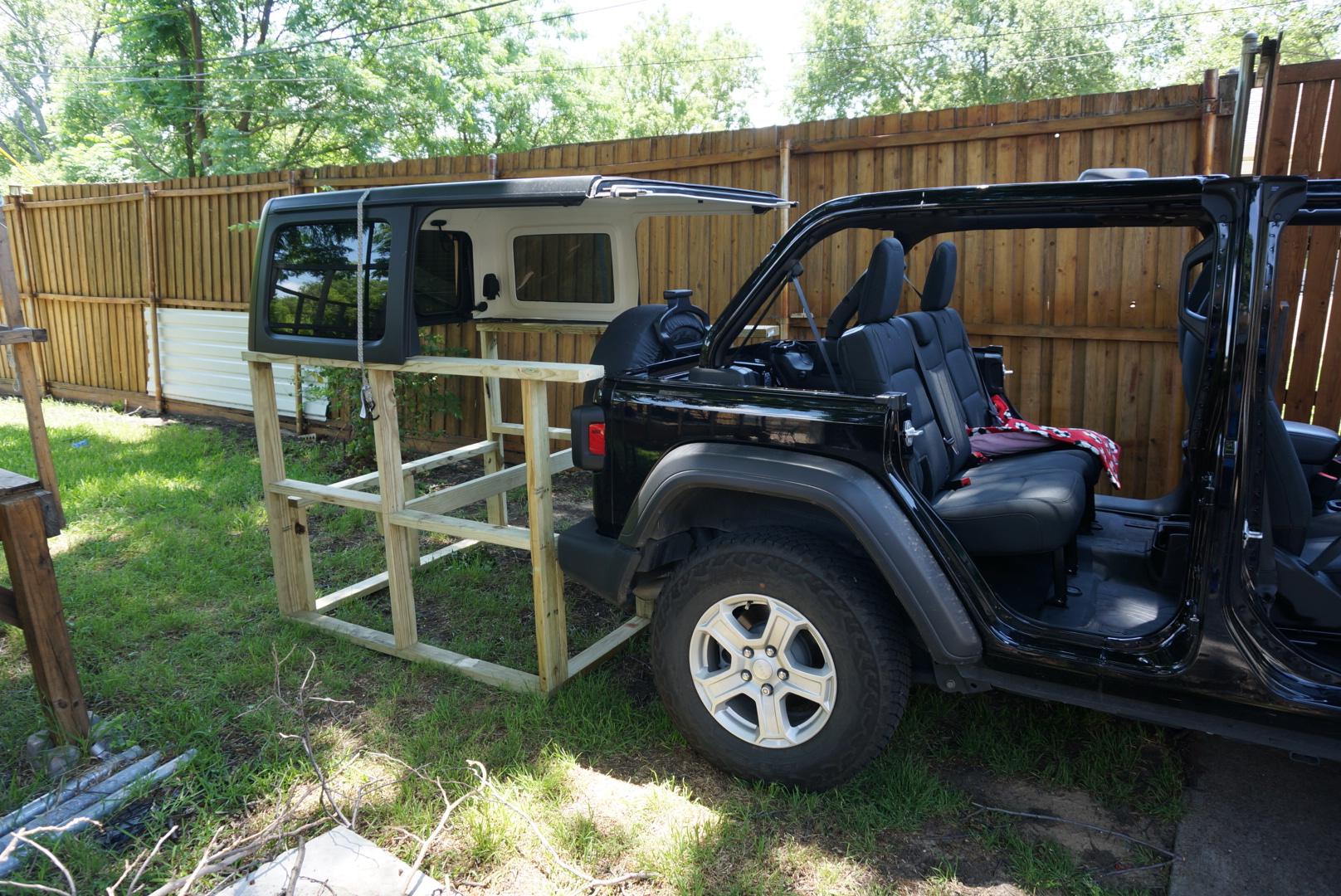

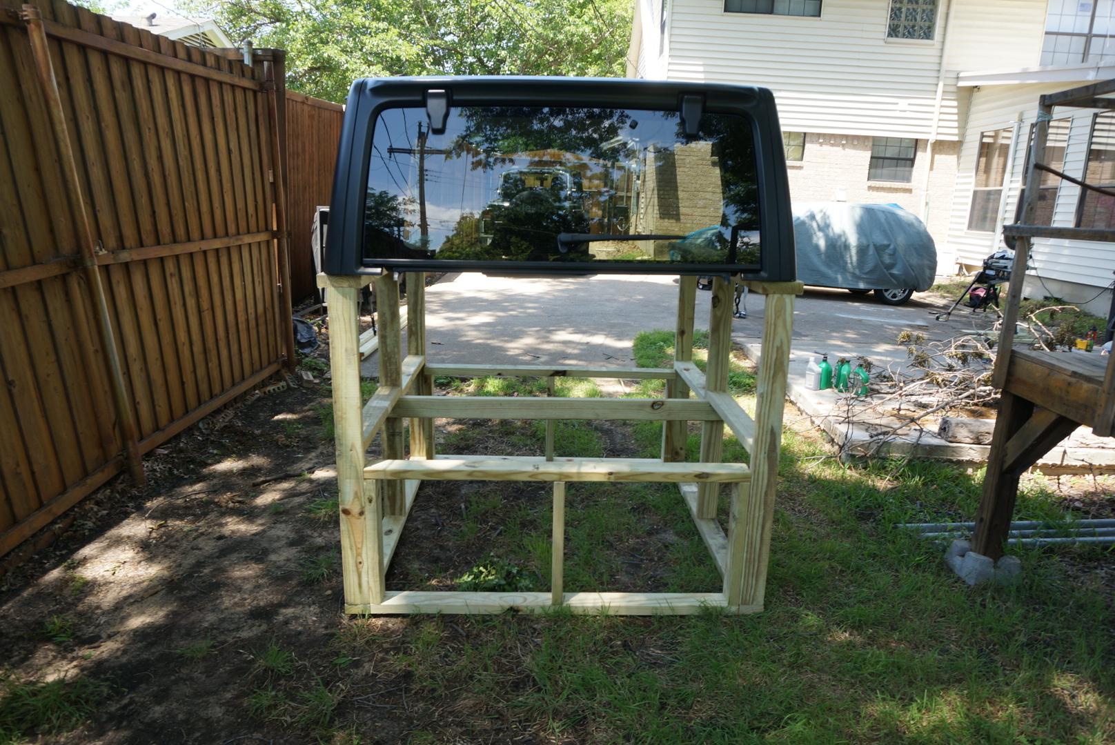

Hello - I'm a new member but have been following since November.
I have been searching for and waiting for a hoist to become available for the Gladiator Hardtop. I got tired of waiting and repurposed my 4 point Harken hoist used or my 2012 Wrangler. It was quite simple actually..I thought I would share.
1. moved the front drop points to be in line with the front-center of the hardtop
2. moved the rear drop points to even with the rear of the hardtop
3. removed the rear latches that were provided and attached some multi-purpose garage hooks (4.5") that I found on Amazon.
4. Raised top
5. Checked for stability - top is fairly light but this works like a charm.
some pics attached
