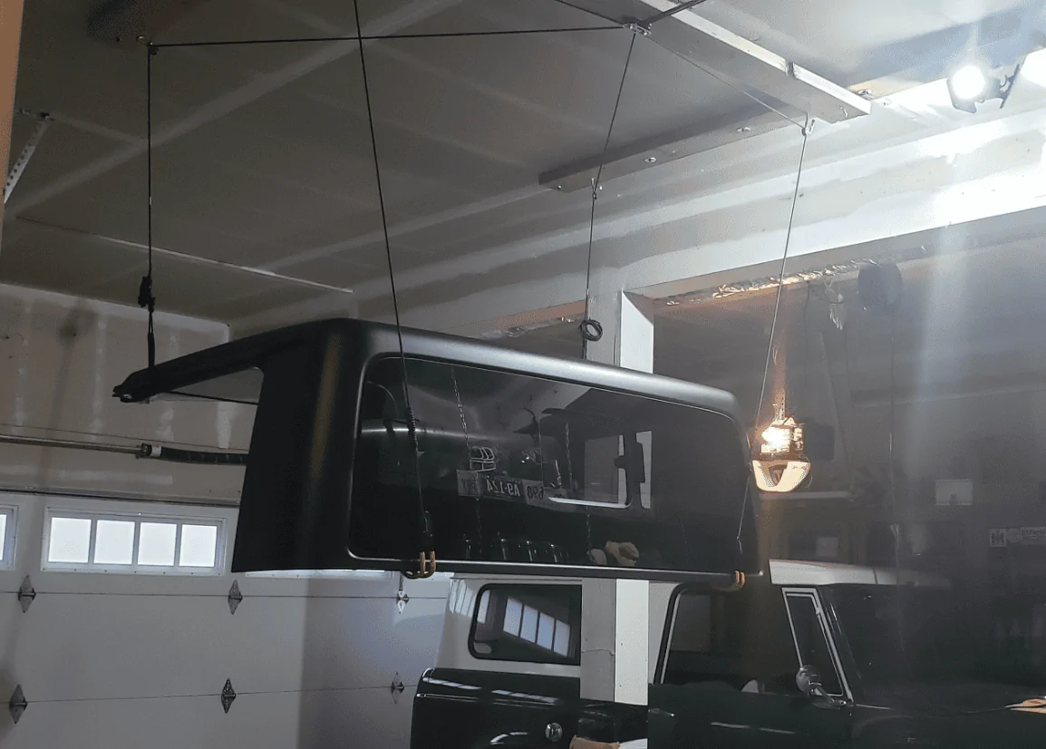

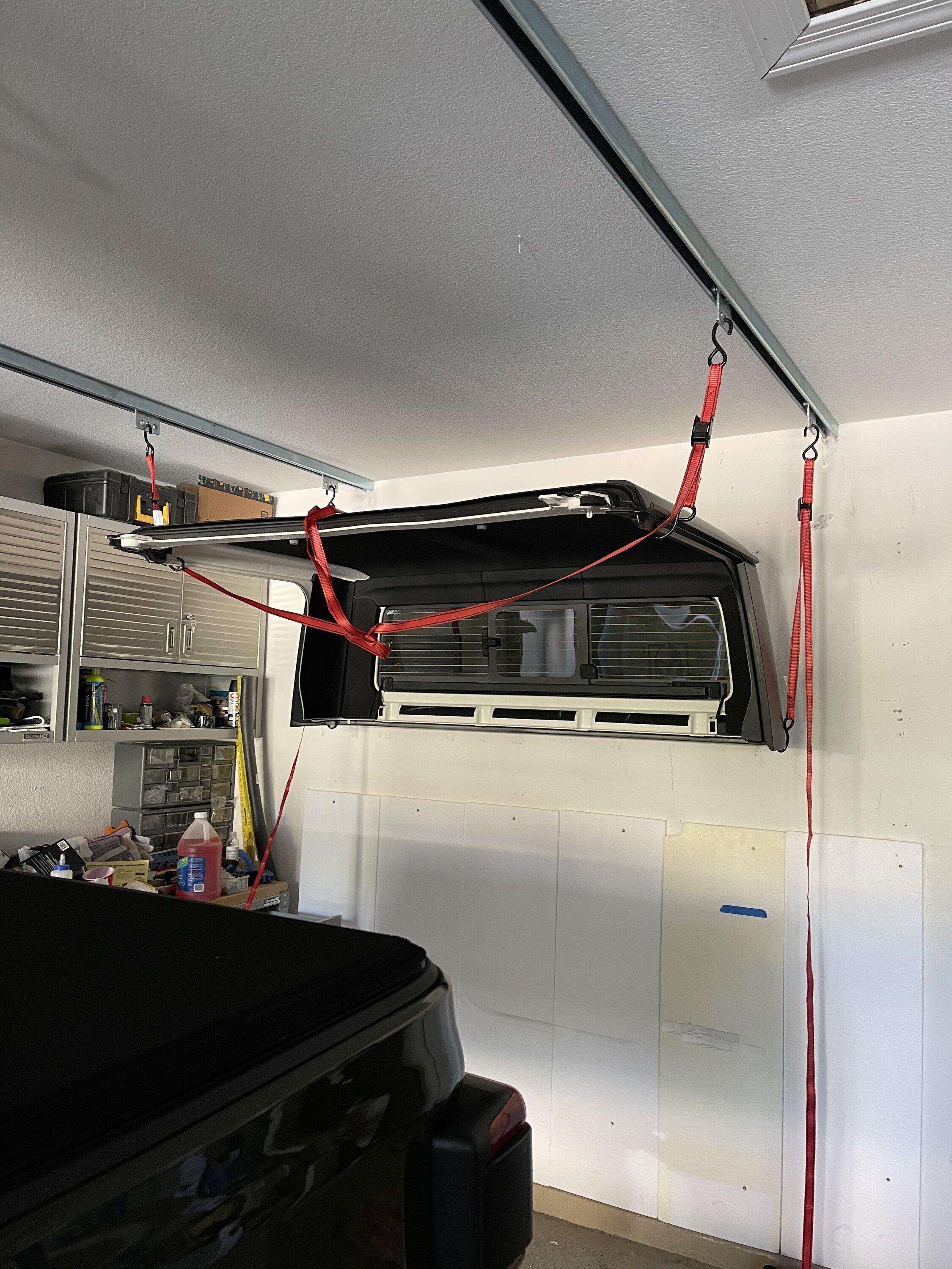

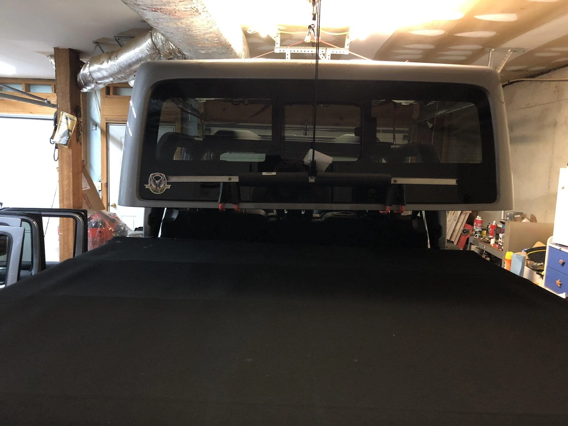

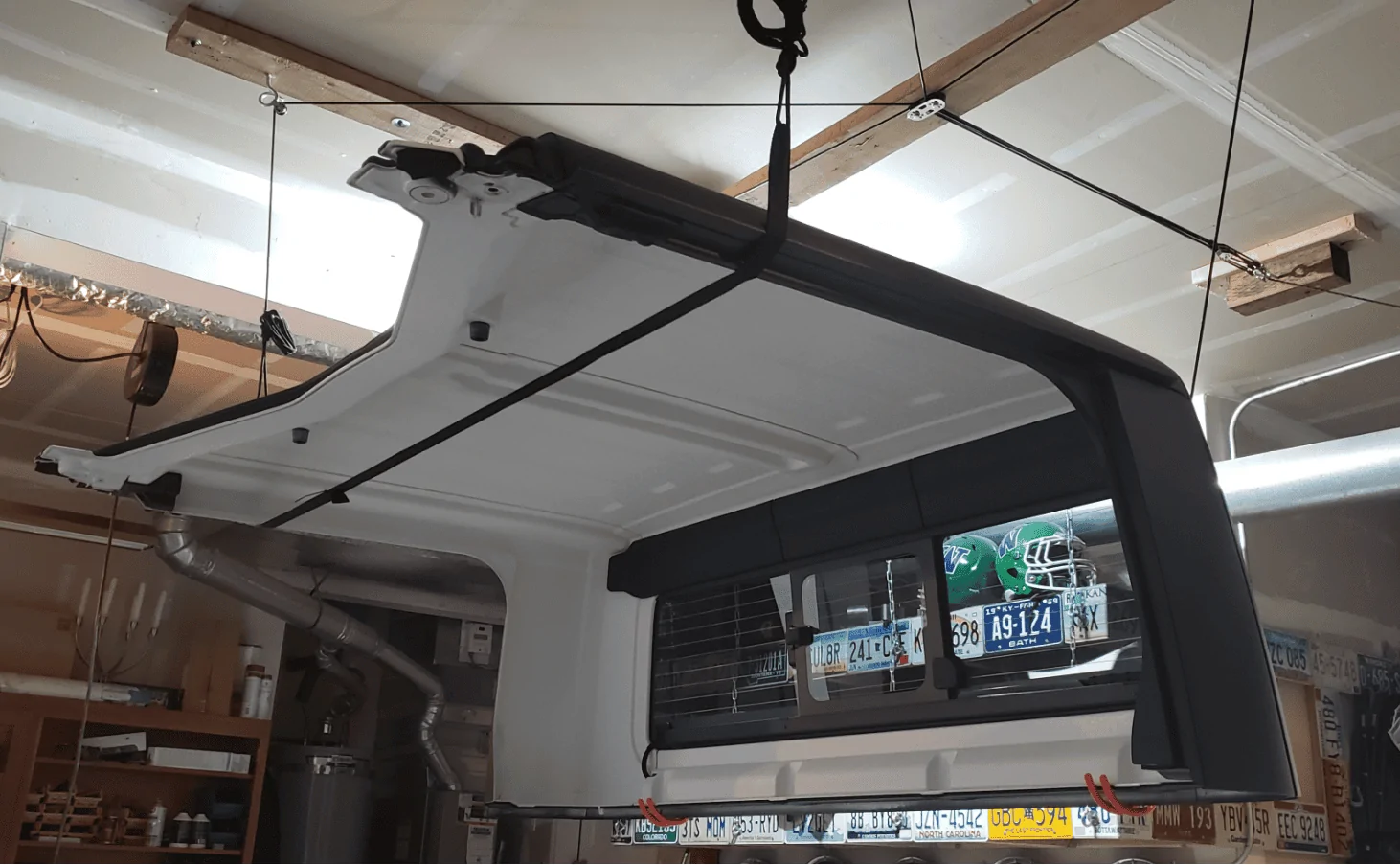

I repurposed a Harken Hoist that I used on my previous JKU.
Jeep Gladiator Gladiator Hardtop Hoist 1620834486376
Jeep Gladiator Gladiator Hardtop Hoist 1620834551155

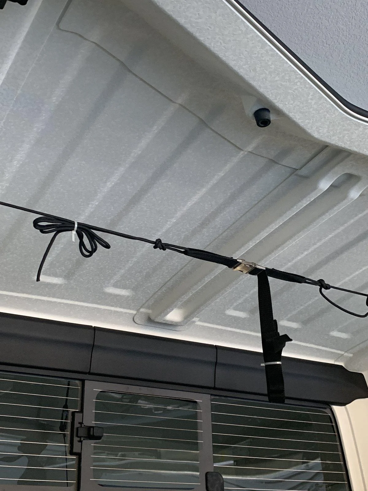

I was able to keep all the same mounting points on the ceiling, just changed the configuration of the straps. My JKU straps went front to back and out the rear hatch. My JT has the front strap running from driver side to passenger side to support the front. I then went to Home Depot and got some hooks to attach to the 2 rear mounting points and removed the strap for the rear.

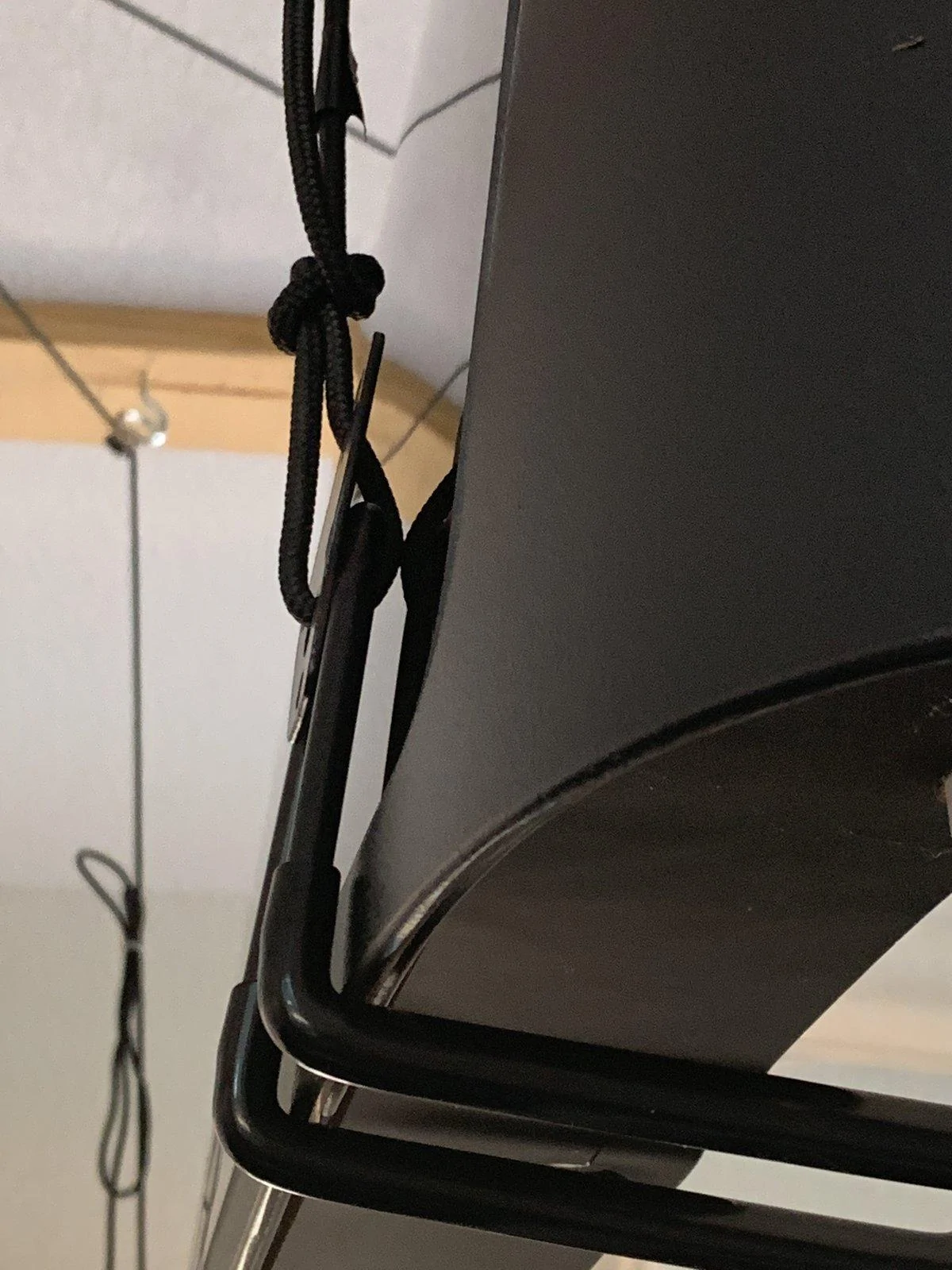

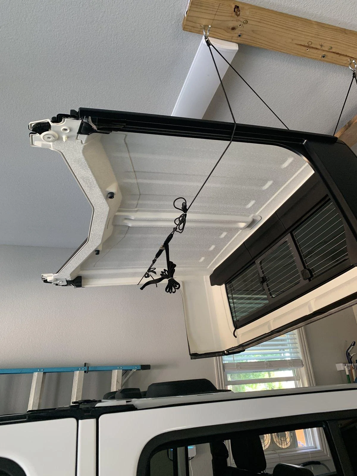

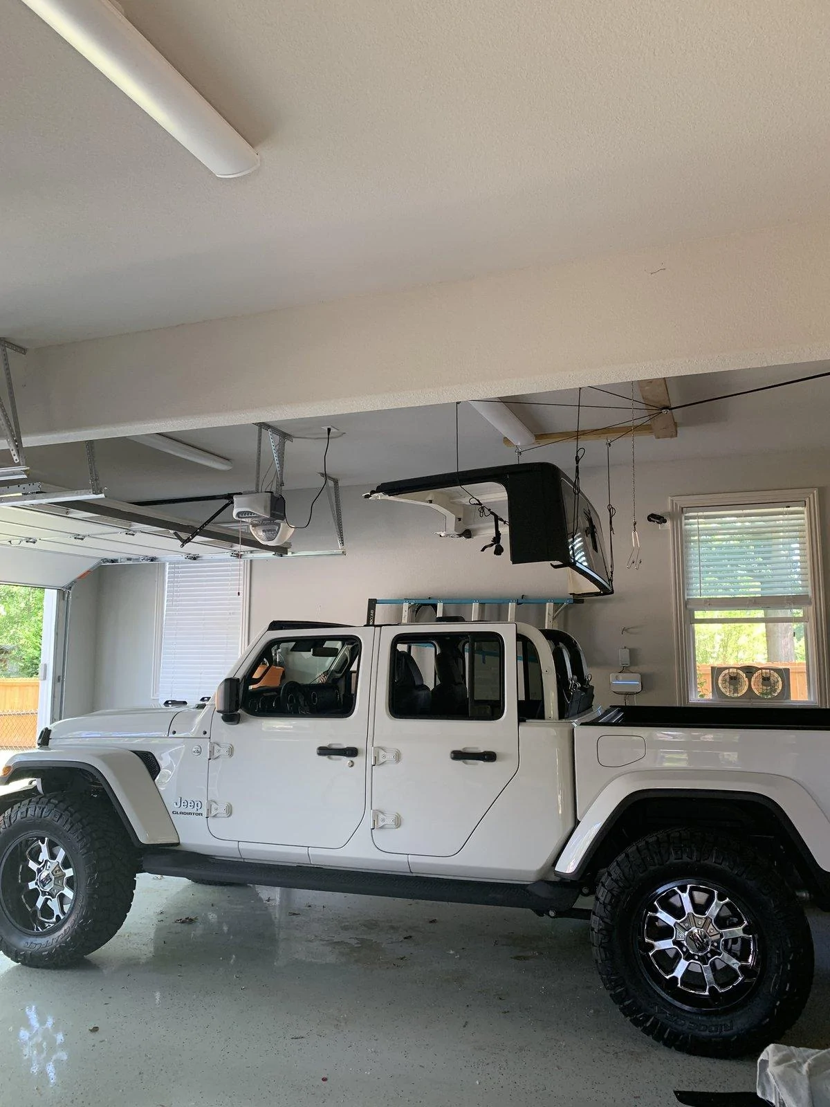

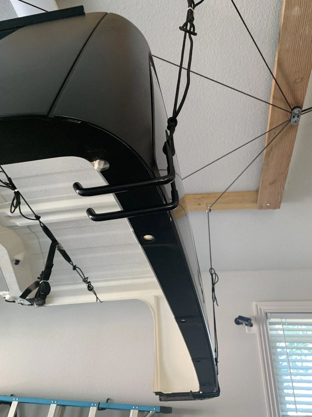

I have been searching for and waiting for a hoist to become available for the Gladiator Hardtop. I got tired of waiting and repurposed my 4 point Harken hoist used or my 2012 Wrangler. It was quite simple actually..I thought I would share.
1. moved the front drop points to be in line with the front-center of the hardtop
2. moved the rear drop points to even with the rear of the hardtop
3. removed the rear latches that were provided and attached some multi-purpose garage hooks (4.5") that I found on Amazon.
4. Raised top
5. Checked for stability - top is fairly light but this works like a charm.
some pics attached

Yes, it used to drop very easy on my JKU. I now jump in the bed and lower it from the tab/brake on the ceiling. I used part 7803.

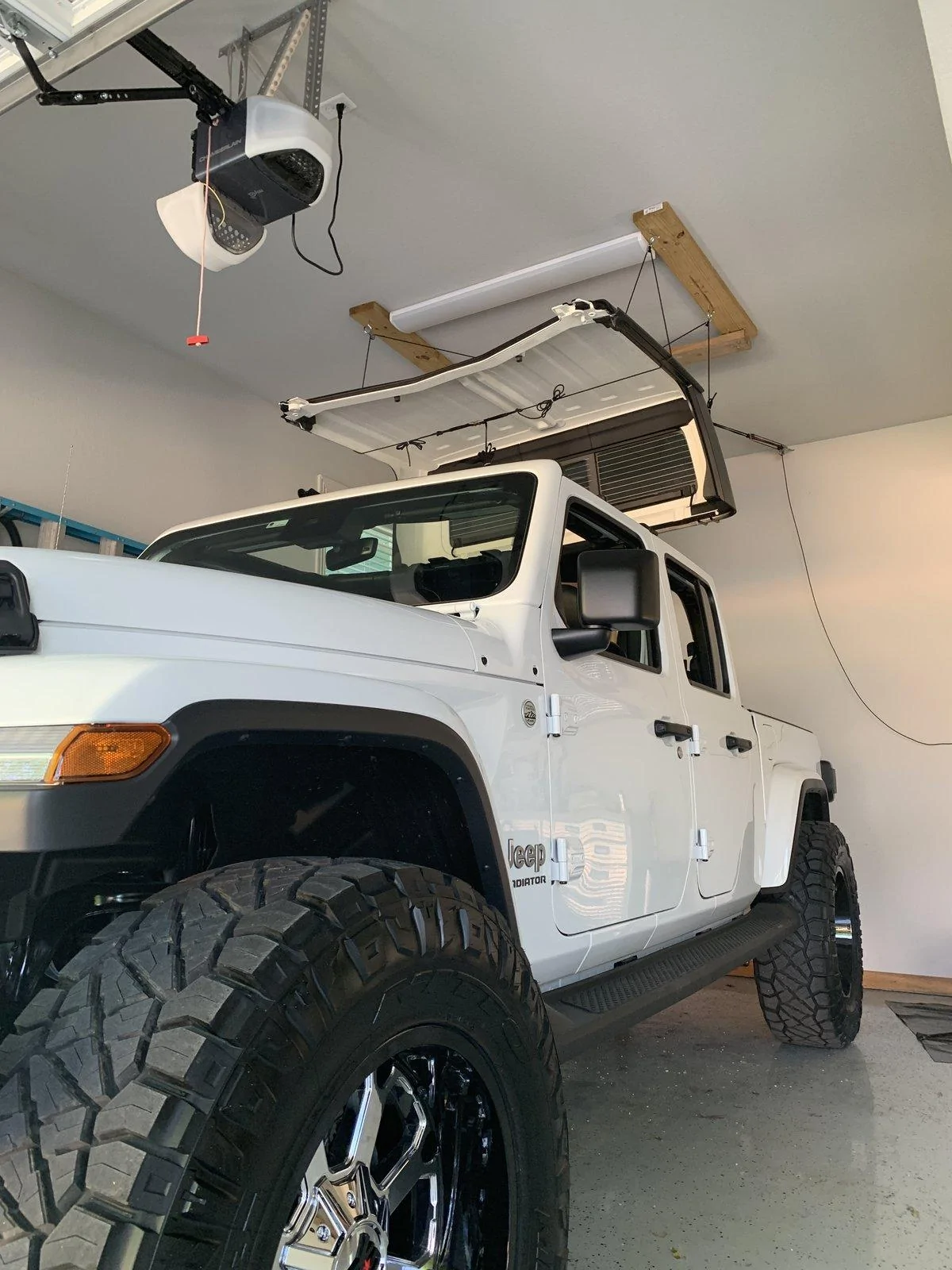

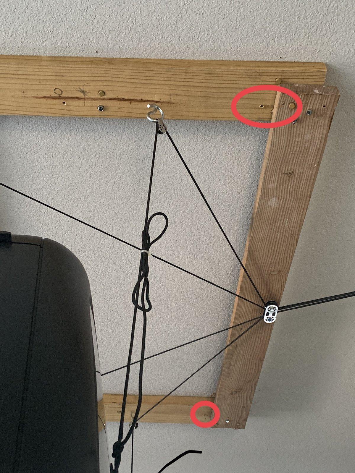

I have limited space between the garage door opener and the roof when it’s parked. I mounted two pieces of unistrut with two trolleys each. Once the roof is off, I can slide it back and raise it.
THIS IS AWESOME!
No way I would have thought of this myself. I am totally going to mimic this design for my Alu-Cab.
Best part is I'll be able to push it back into an alcove of my garage where the stud walls are pretty close (left & right), thus way less stress on my long span ceiling joists in the middle of my garage.

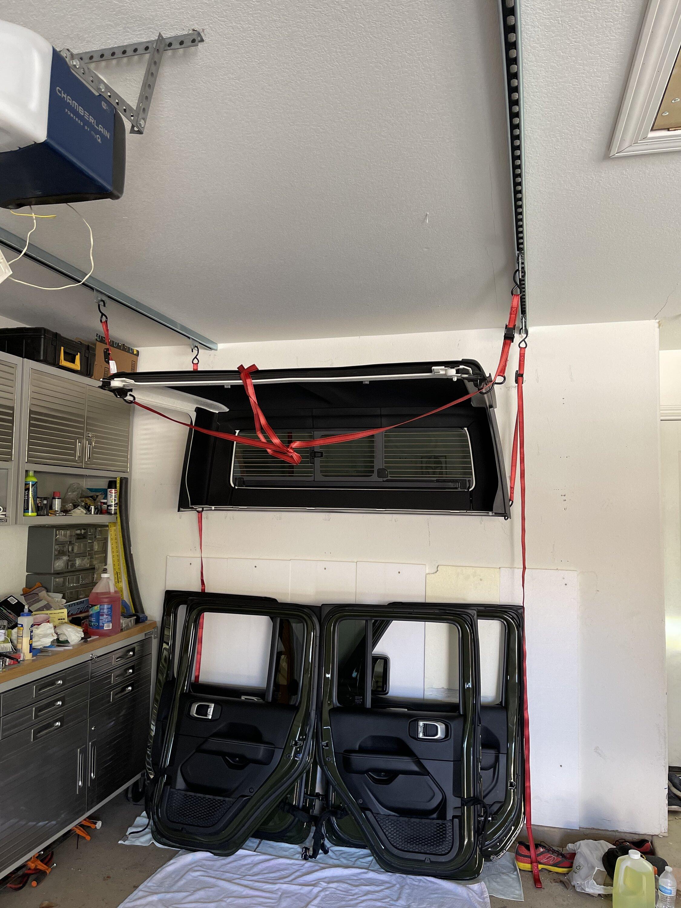

Has anyone just ran the harken hoist straps through the rear sliding window? I have a hoist I use for my Tj and the straps runs front to back.
