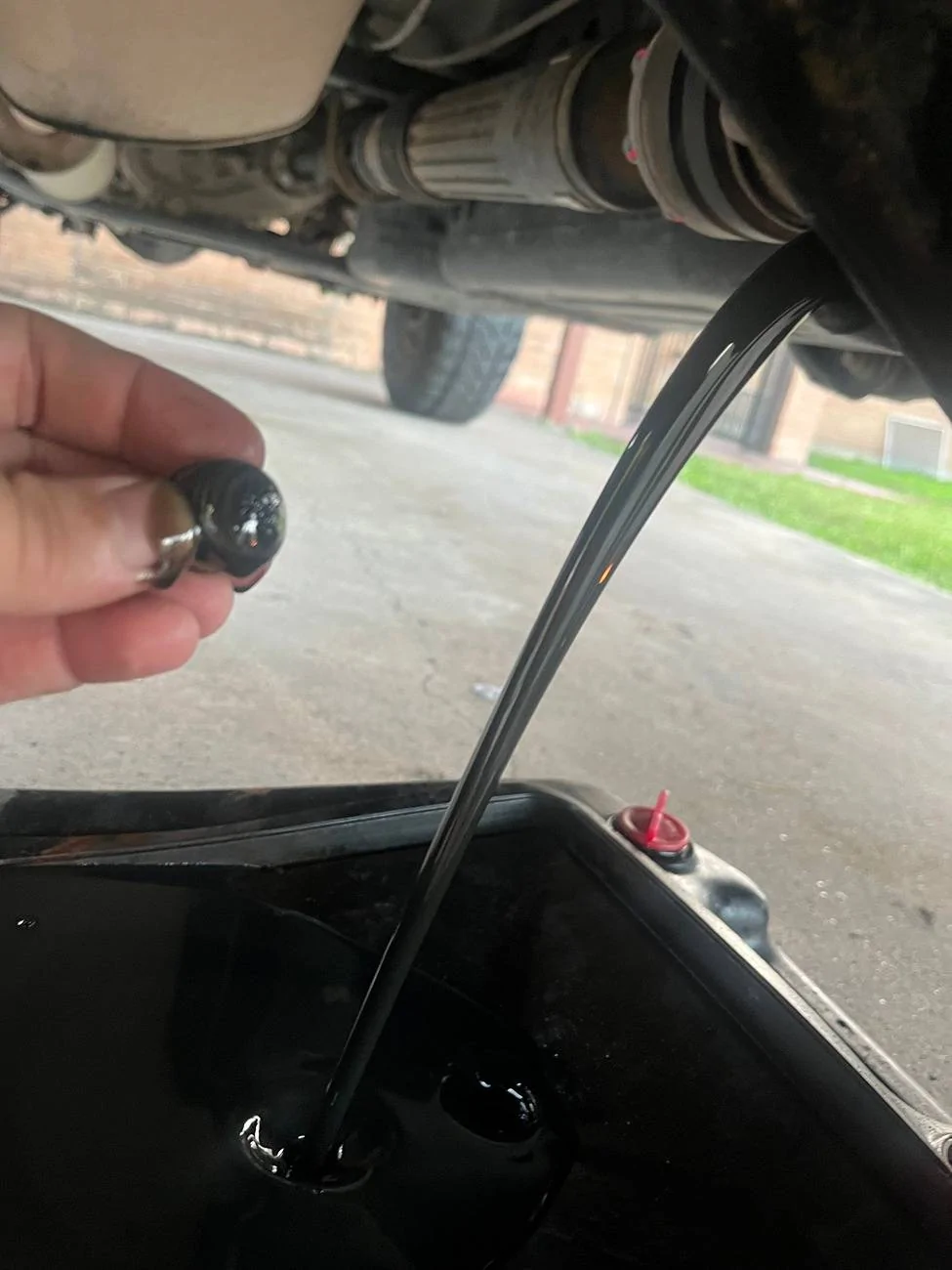

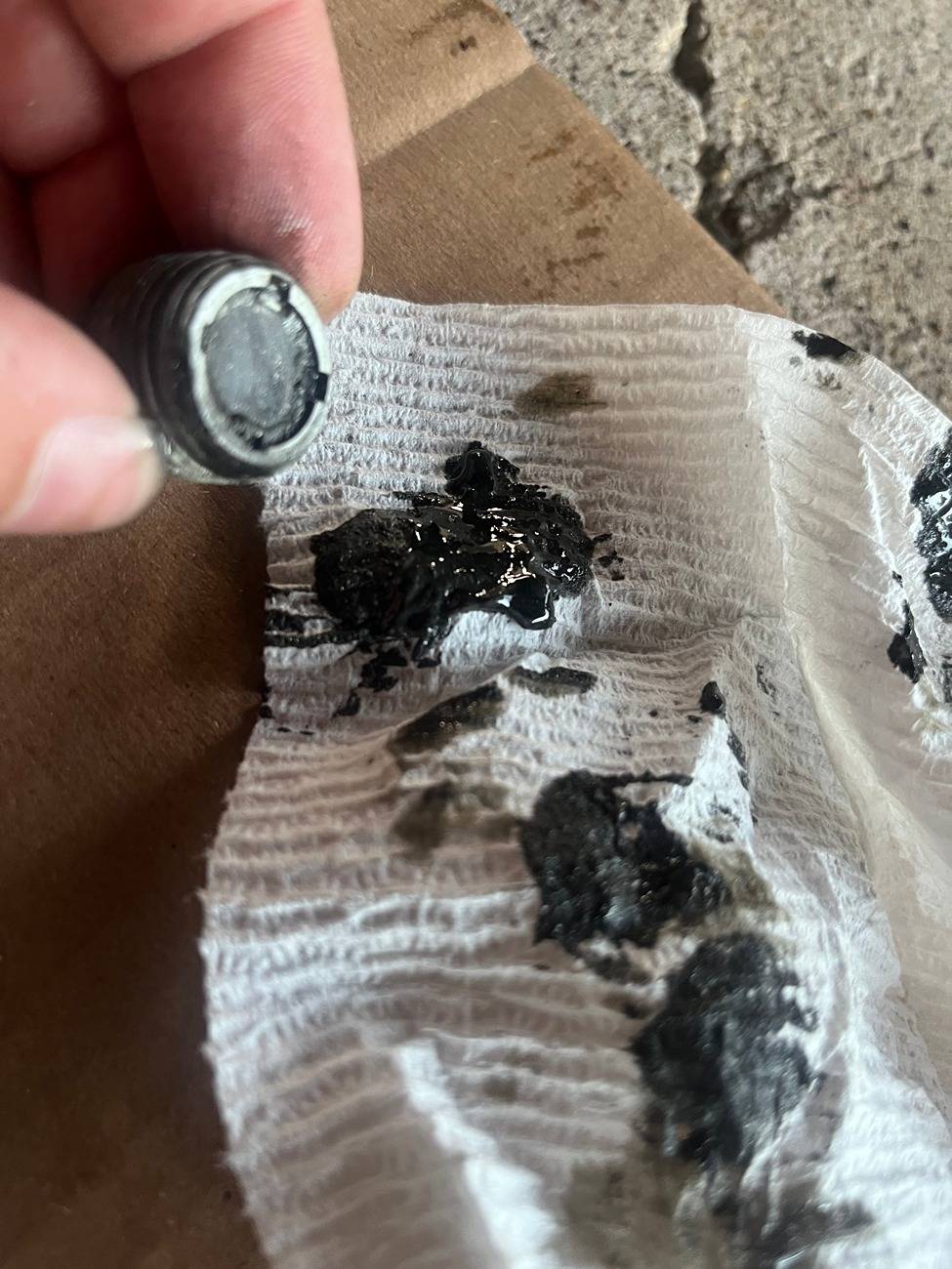

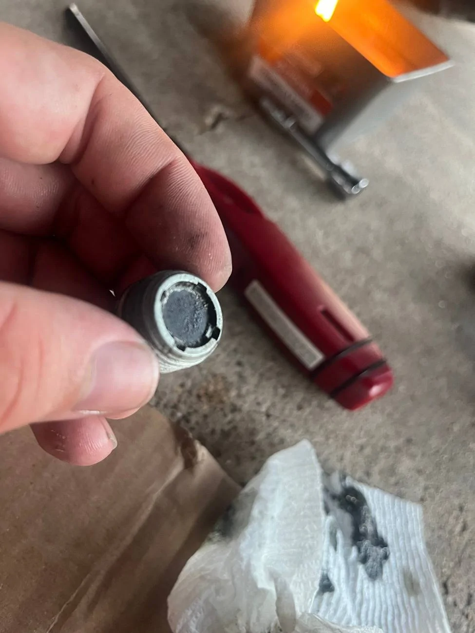

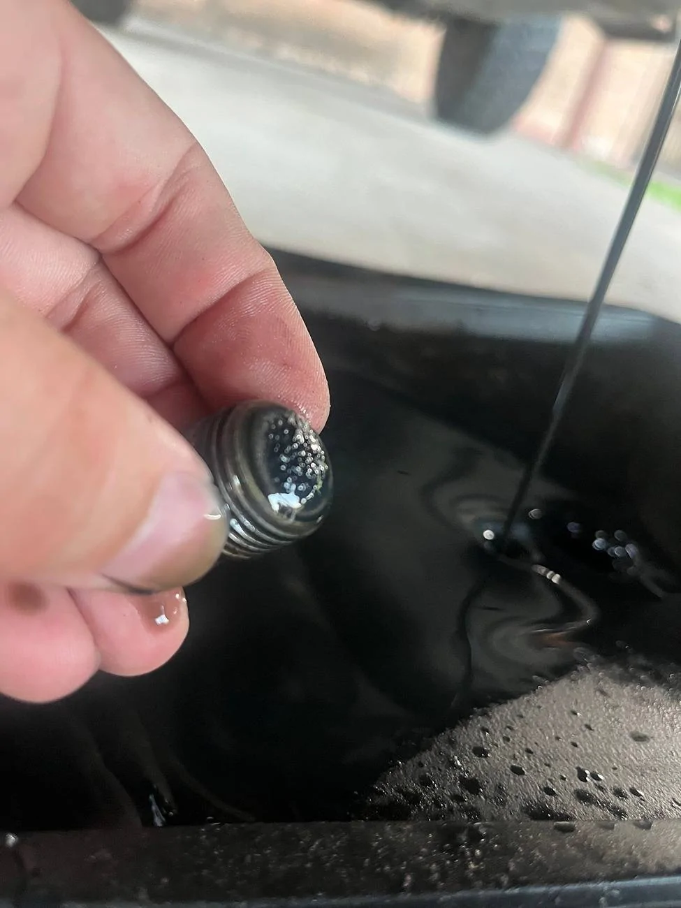

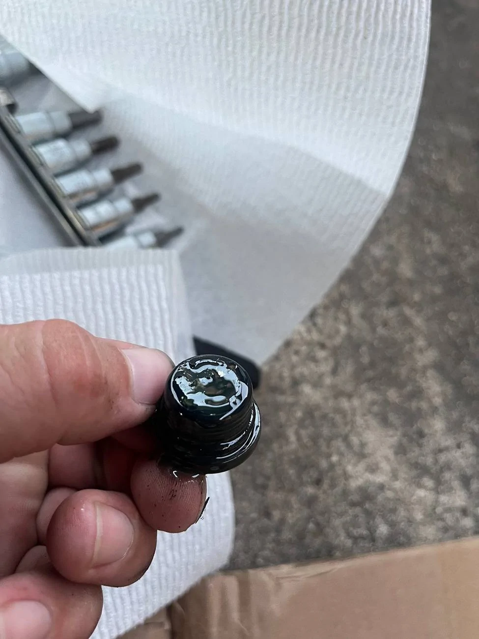

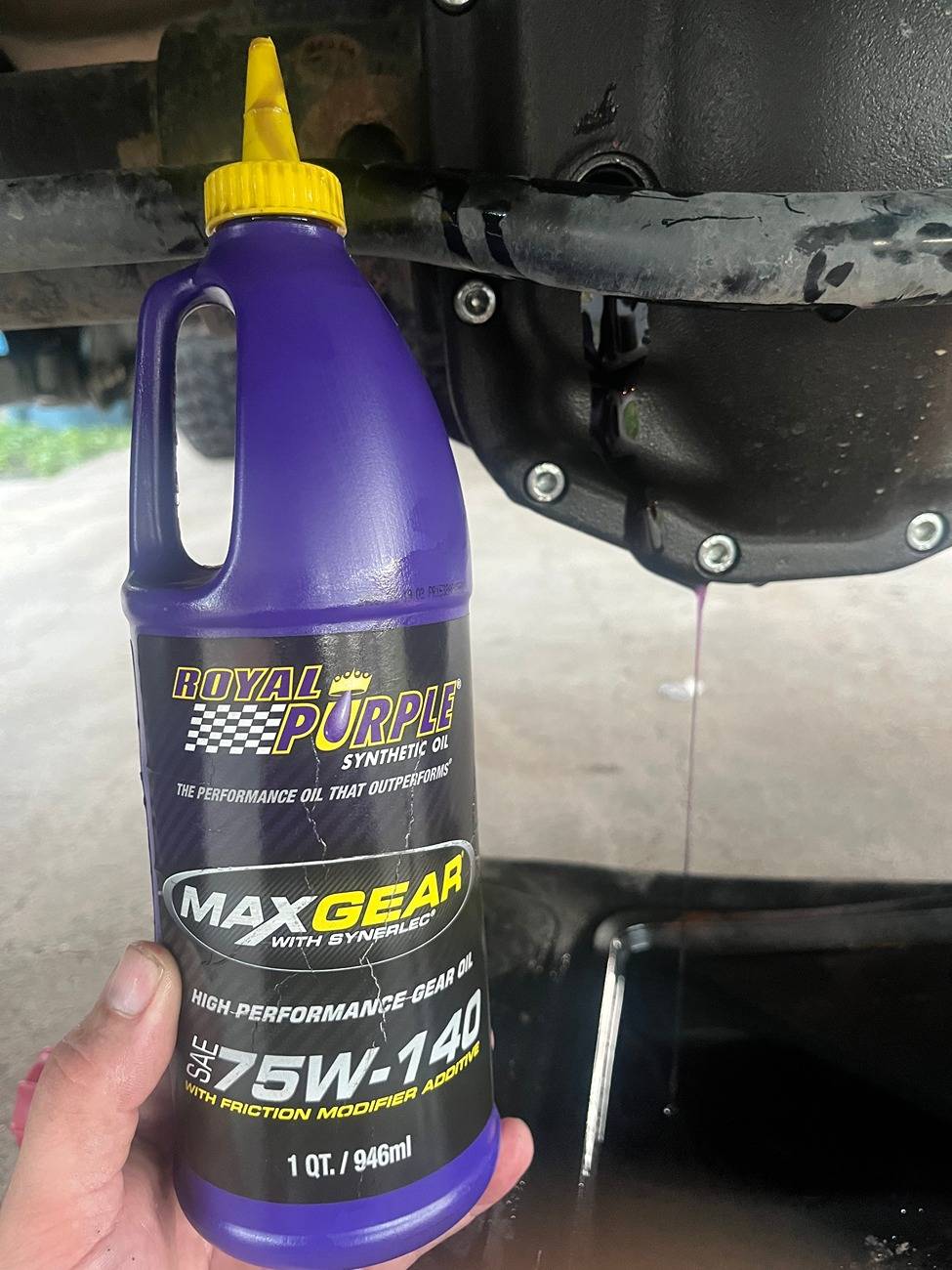

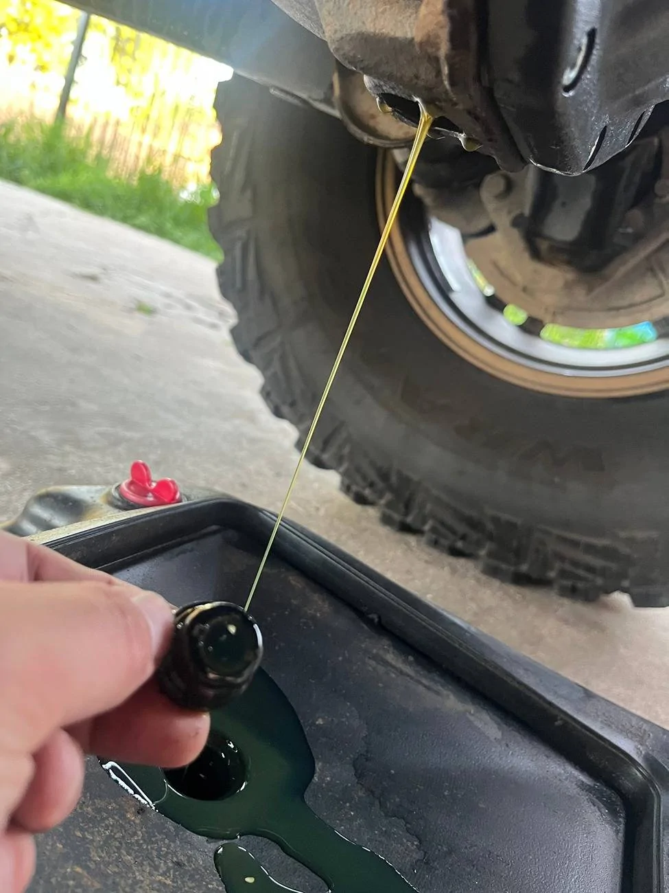

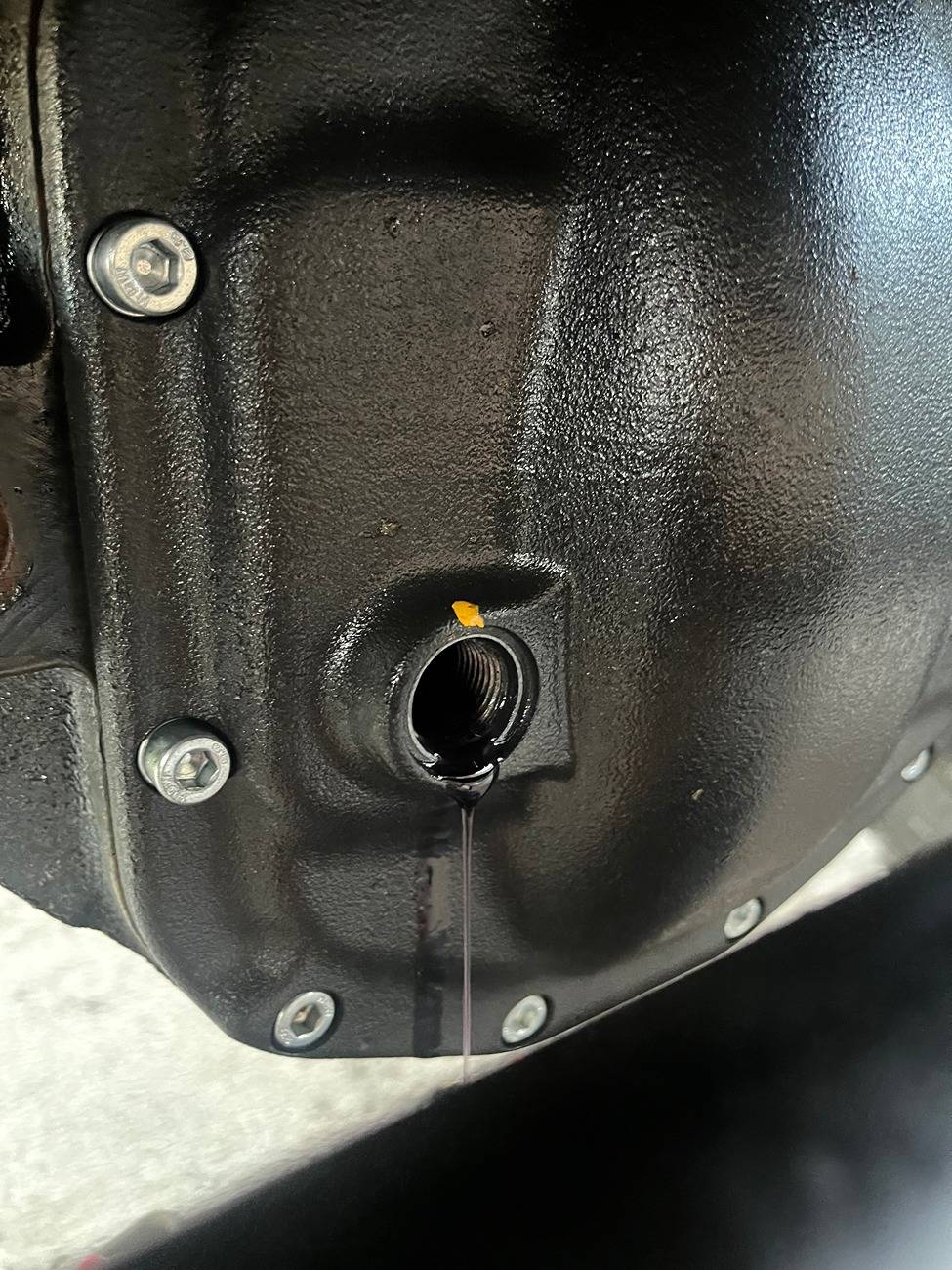

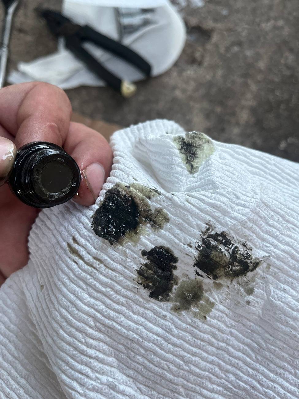

Did the break in oil change today. I used Royal Purple, I don't necessarily think its worth it for this application, but I've always used it and it was on sale anyways. Emailed in the pictures to Exodus to maintain my warranty with them.

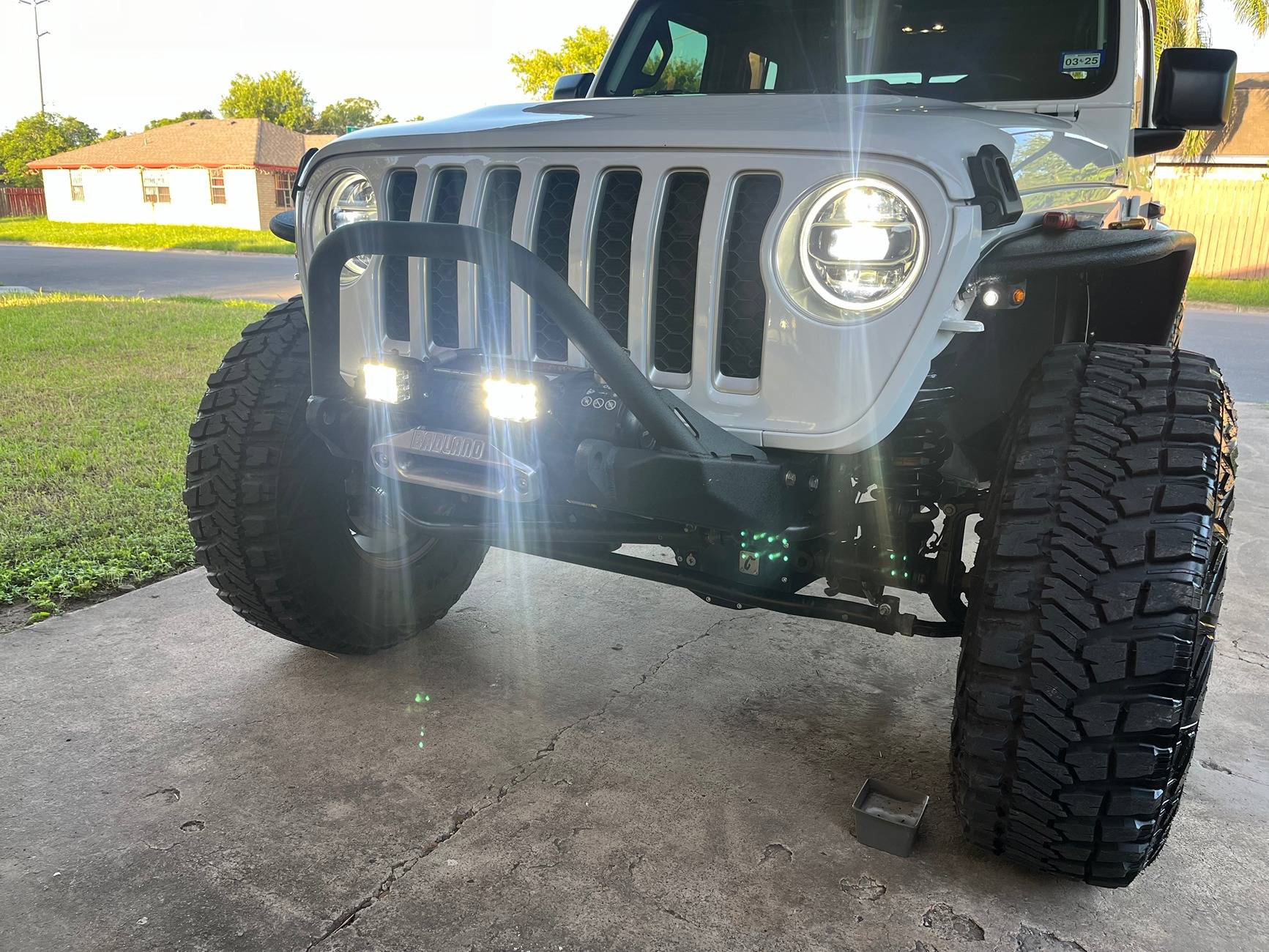

Also got some Harbor Freight lights hooked up. I personally don't mind HF. Don't get me wrong they were trash ten years ago, but their products have really been getting a lot better! I don't care to support Warn, as I've mentioned I have friends that are either work there or did previously and its just not a company I care to give my money to... And honestly I've never seen a Harbor Freight winch fail, if its good enough for Matts Offroad Recovery then its good enough for me. As far as these lights I would also have to say good enough for me. Time will tell if they last, but for sure they help a lot on these Texas highways with no lighting! I of course wont be using them when anyone else is on the road, not sure on the legalities of that here but in Oregon its a pretty hefty ticket.
I wired them into the factory fog light harness. The button already being there is super convenient and the wires are the same gauge so I'm assuming the amperage is sufficient for the lights. Surely we all know what they say about assuming, but if it causes me any issues I'll just re wire them into my auxiliary panel. I have seen a few others do the same wiring wise, I am definitely not the first so it should be fine.

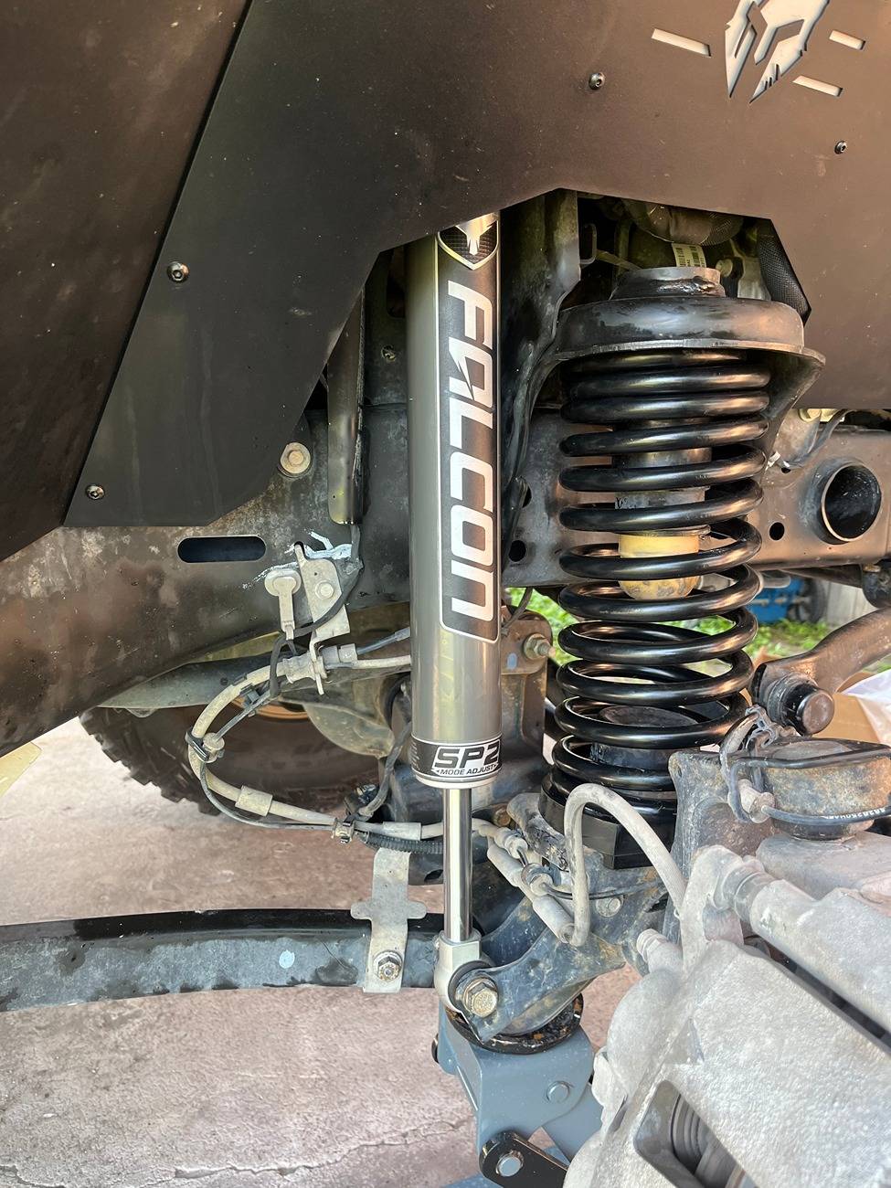

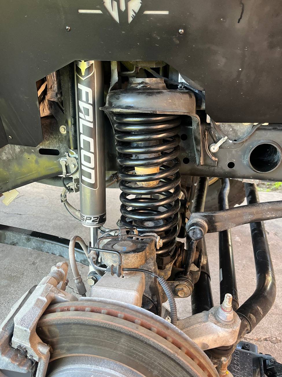

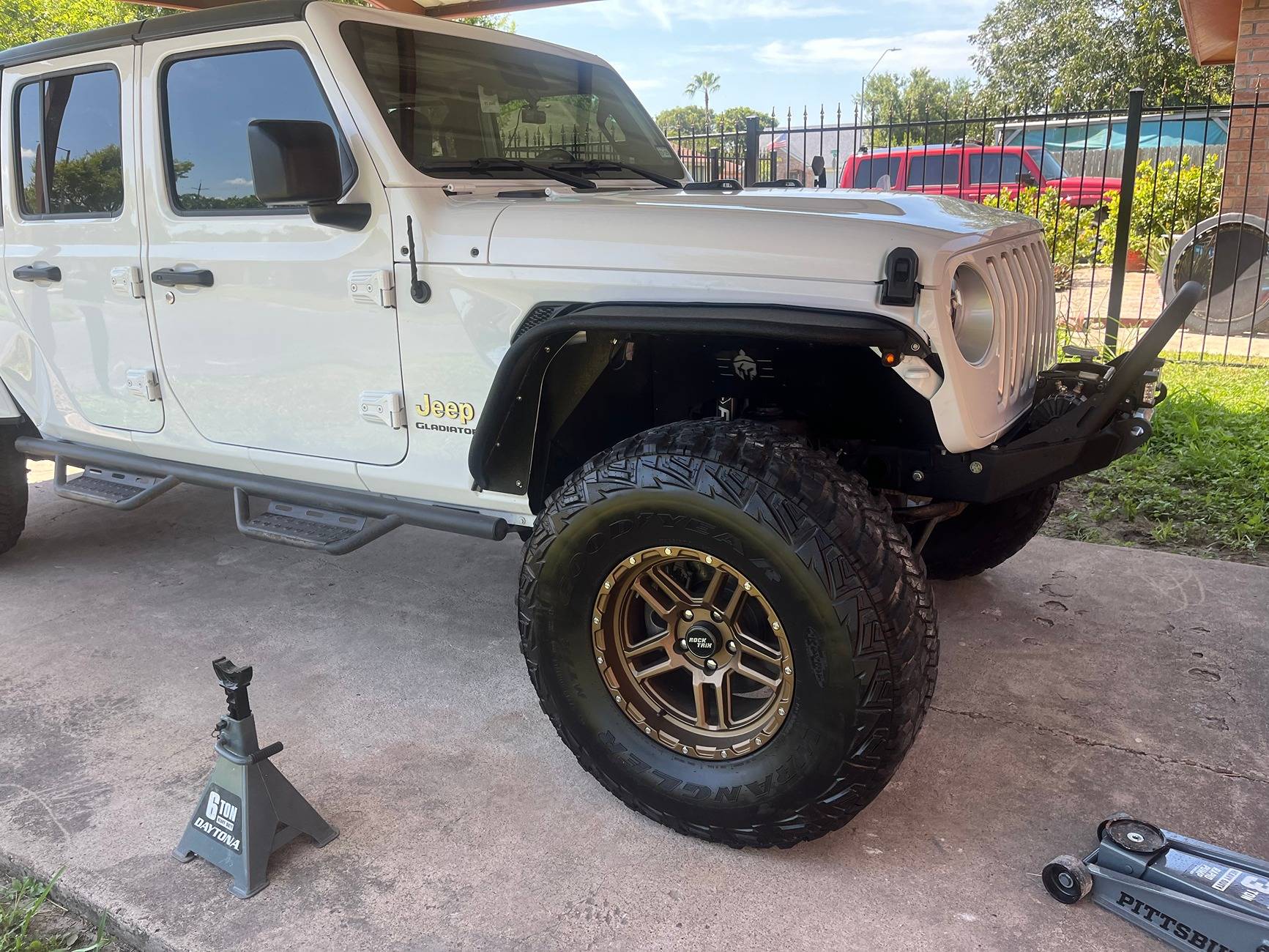

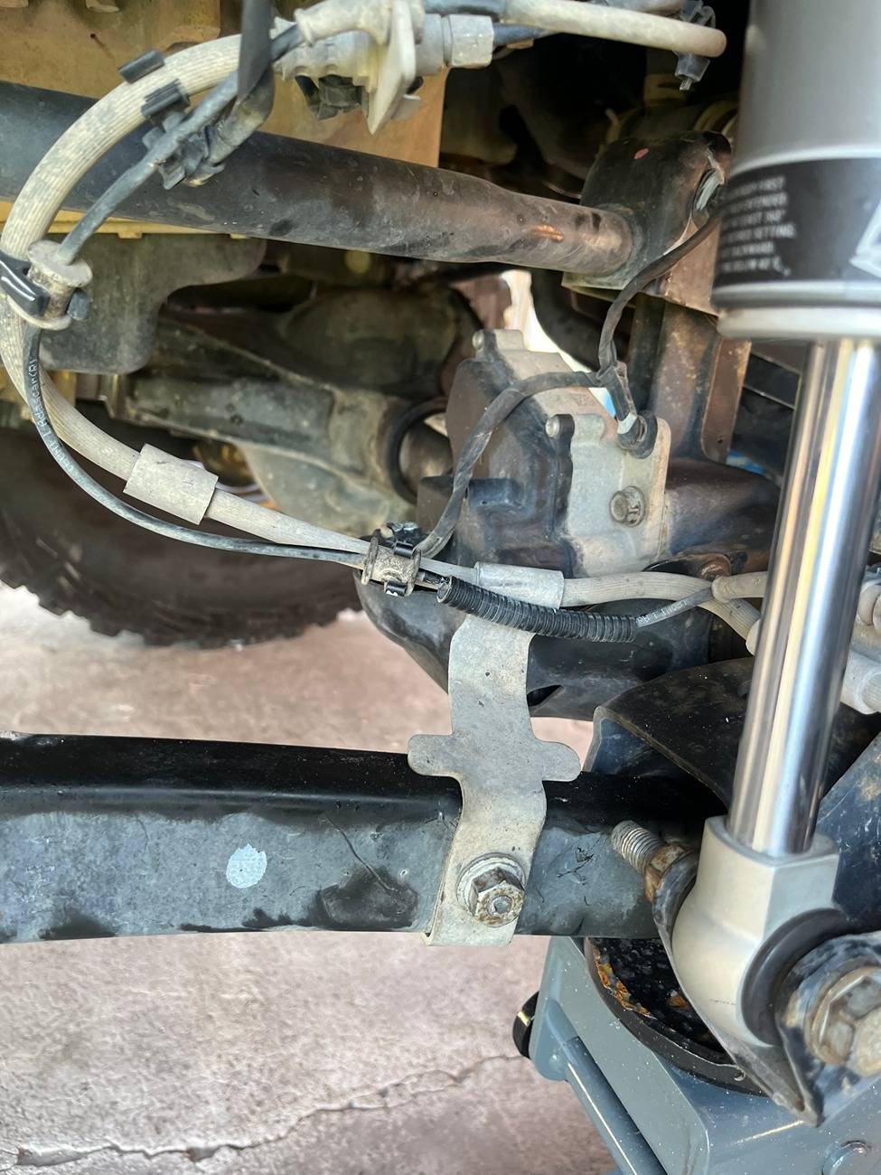

Got my RK 1.5" coils in on Saturday and finally had a chance to swap them out today. These replaced my terraflex levelling kit and I am definitely much happier with them. The only downside for the coils on my end is that they lifted the truck way more then what RK labels them as. I ended up with 3" of lift when I was only wanting 2-2.5" at the most. I'm hoping they will settle... Also got the new Falcon SP2.0 shocks installed. I am running them on the softest setting which still feels kinda stiff, but it does drive very nice on the road. The bracket that mounts to the LCA I bent up a bit so that at full droop the brake lines and wire have a bit of slack in them. I may end up doing a 1" spacer on the rear coils.. Which I really really dont want to do.. I guess Ill decide throughout the next week. If the front end settles down to 2.5" Ill be happy but that could take a long time in my experience.
