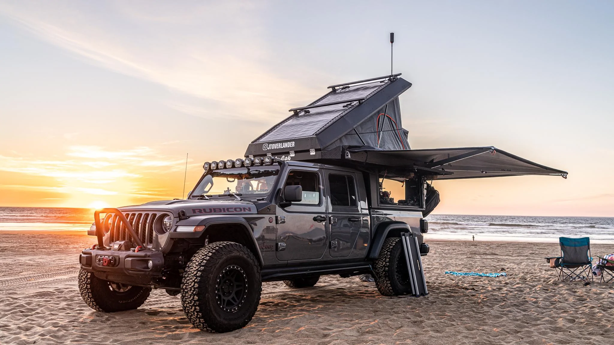

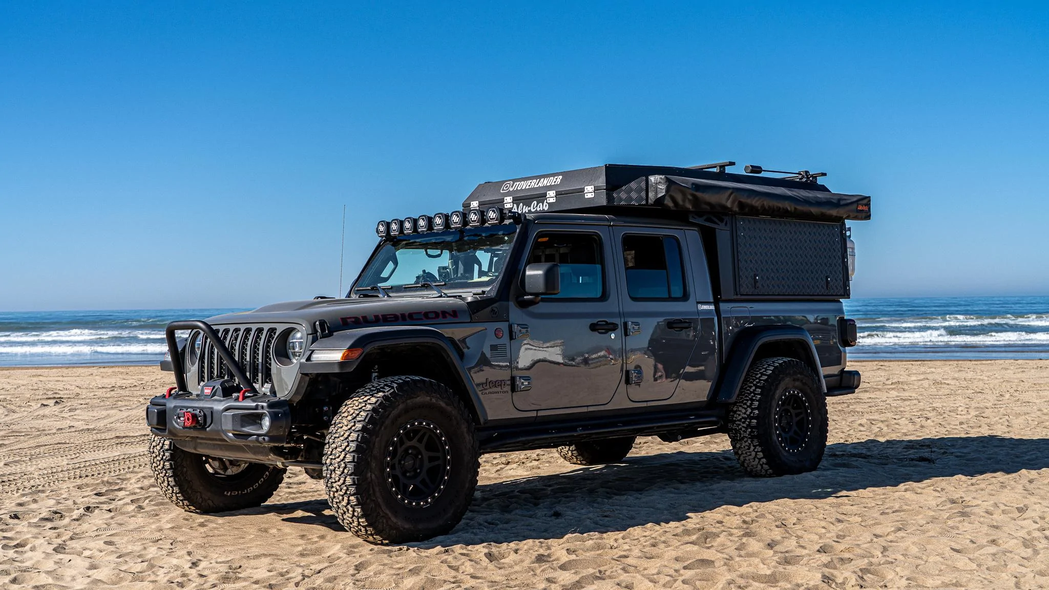

Hi, my name is Colton. I Ordered my Gladiator in August 2020, and took delivery late October 2020.
Here is my Build
- 2021 Jeep Gladiator Rubicon (Stingray color)
- 37"x12.5" BFG KO2s
- Method 312s Matte Black <17"x 8.5" 5x5 0/4.75">
- AEV 2.5"/3" DualSport RT with High Capacity Coils
- PowerBrakes Billet 6 Piston Off-Road Calipers
- Long Range America 17gal Aux tank
- Yukon 4.88 Gears
- Hellwig rear sway bar
- Synergy tie rod & steering correction kit
- Fox ATS 2.0 steering stabilizer (relocated with Synergy Bracket)
- Rock Krawler Front & Rear Track Bar
- Warn 12K Synthetic & Factor 55 closed shackle
- Ace Engineering Rock Sliders
- Factory steel bumper with Warn high bull bar
- Baja Designs 8XL
- ARB dual compressor on 813 Fabrications hood mount
- Invictus roof panels front & rear
- Dirty Dog Cargo net separator
- Midland MXT275 with 6dB Gain Antenna
- Molle Platform Solutions JT Rear Overhead Panel / Tray
- Vantop Front & Rear Dashcam Mirrior
- Cover Maximus-3 Satellite Antenna relocation mount
- Speedflate 4 Tire System
- Garmin Tread Overland 8" Navigation
- Bulletpoint Mounting Solutions for Phone & Garmin
- Alu-Cab Canopy Camper
- Goose Gear 100% rear seat delete, bed plate, bulkhead 4x utility cabinets & sleep decks
- GP Factor rear molle plates, drop tables & 1 falcon door molle plate
- Blue Ridge Overland Velcro Pouches on ceiling
- Snomaster LP65
- Weboost cell booster.
- 2X Sunflare 126w solar panels
- 100Ah Battleborn Battery
- Redarc BCDC 1250D
- Victron BMV 712
- Dickinson Fireplace with GP Factor Fitment kit
- Alu-Cab 270 Awning
- Alu-Cab 13 gallon water tank
- 2x MaxTrax mounted to Alu-Cab load bar with GP Factor mounts
- Krazy Beaver Shovel w Rhino Rack shovel mount.
