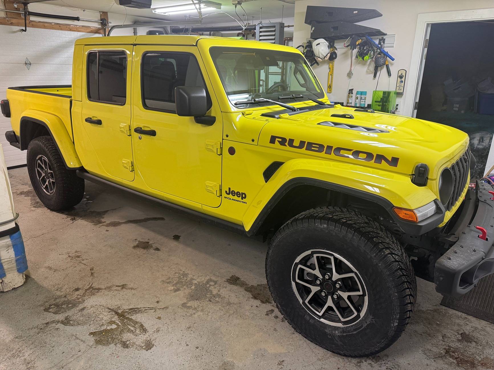

Picked up and installed a set of Nokian Hakkapelitta studded tires, as I was sliding all over the place with the stock 33s.
Upgraded to 35s on the stock set up and they fit great. Huge ice/snow driving upgrade jumping over to the Nokians.

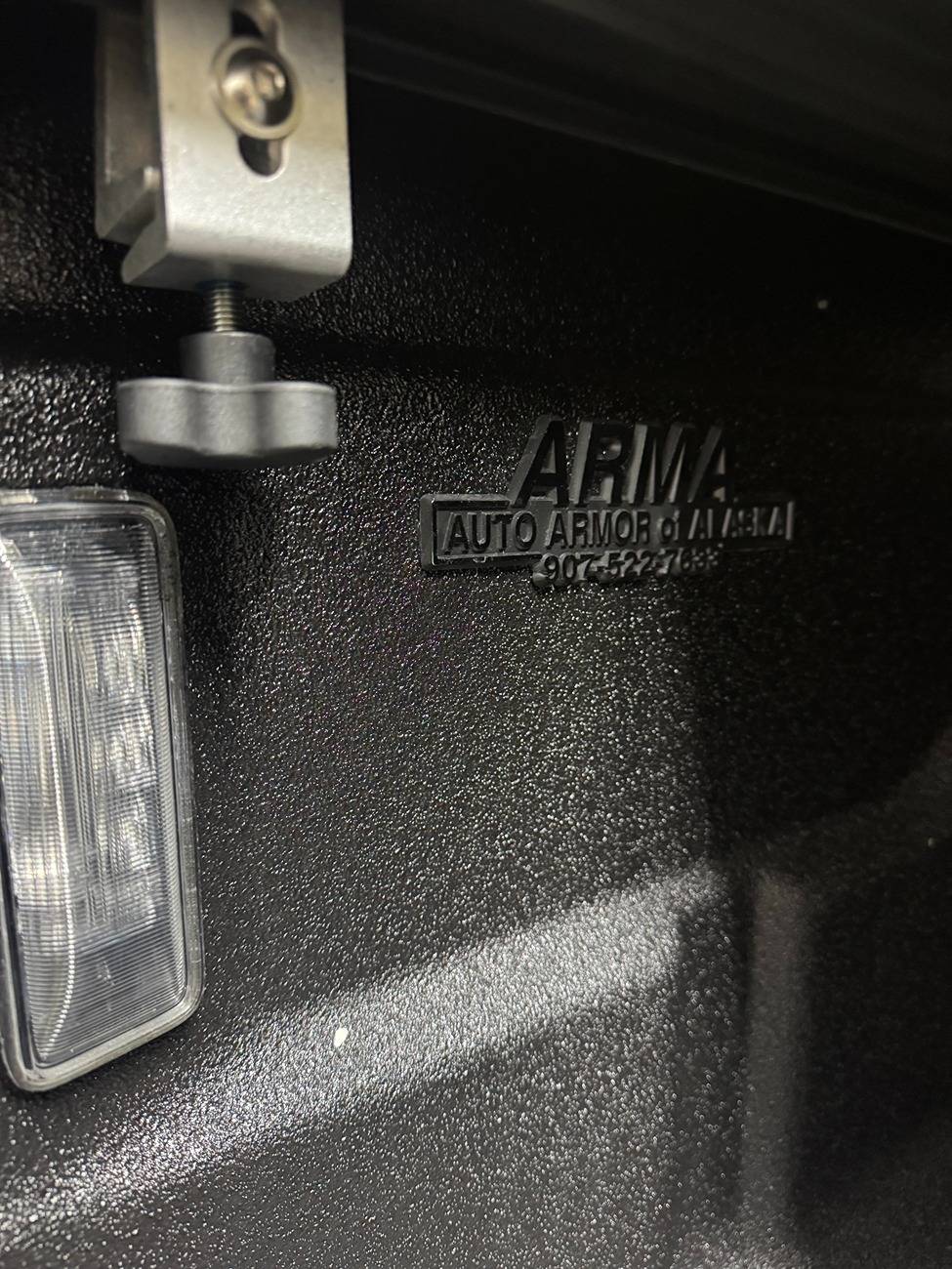

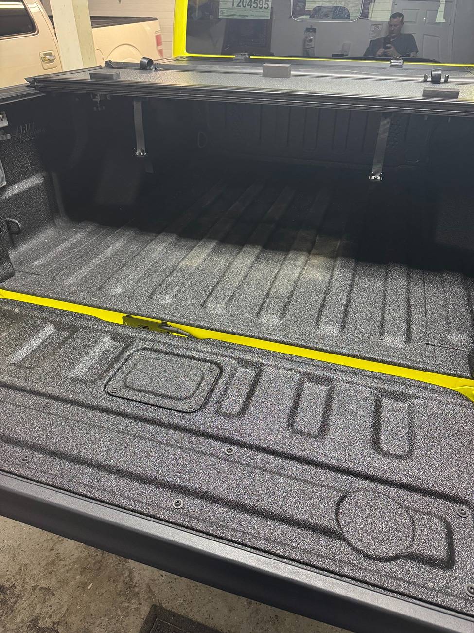

Had a spray in bed liner put in by Auto Armor of Alaska. Looks like they did a pretty damn good job, I'll see how it holds up over time.

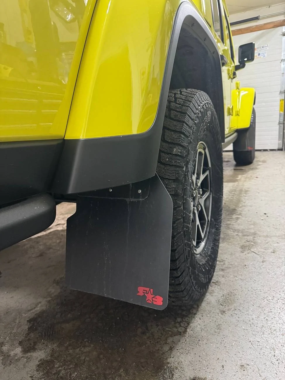

Installed Rokblox XL mudflaps in the front and back. Front tires were kicking up a ton of dirt/rocks all over the door hinges, door handles, and rear fenders. Needed to do something here before this was all destroyed.

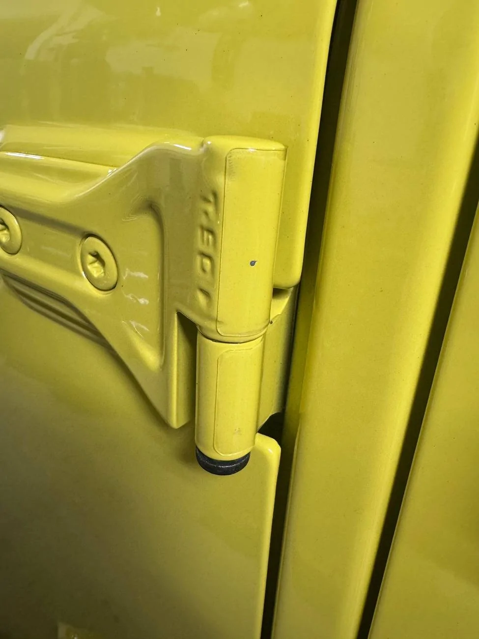

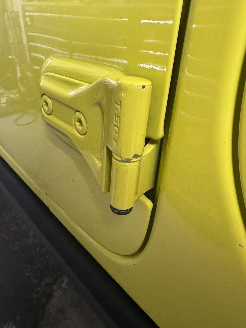

Installed Rock Stopperz Paint Protection Film over the door hinges..... This should really come from the factory or another solution from the factory. I can't believe how chipped up my door hinges got in a week. I'll order some touch up paint and do my best to fix the chips, then either reapply this or some other solution over the hinges.

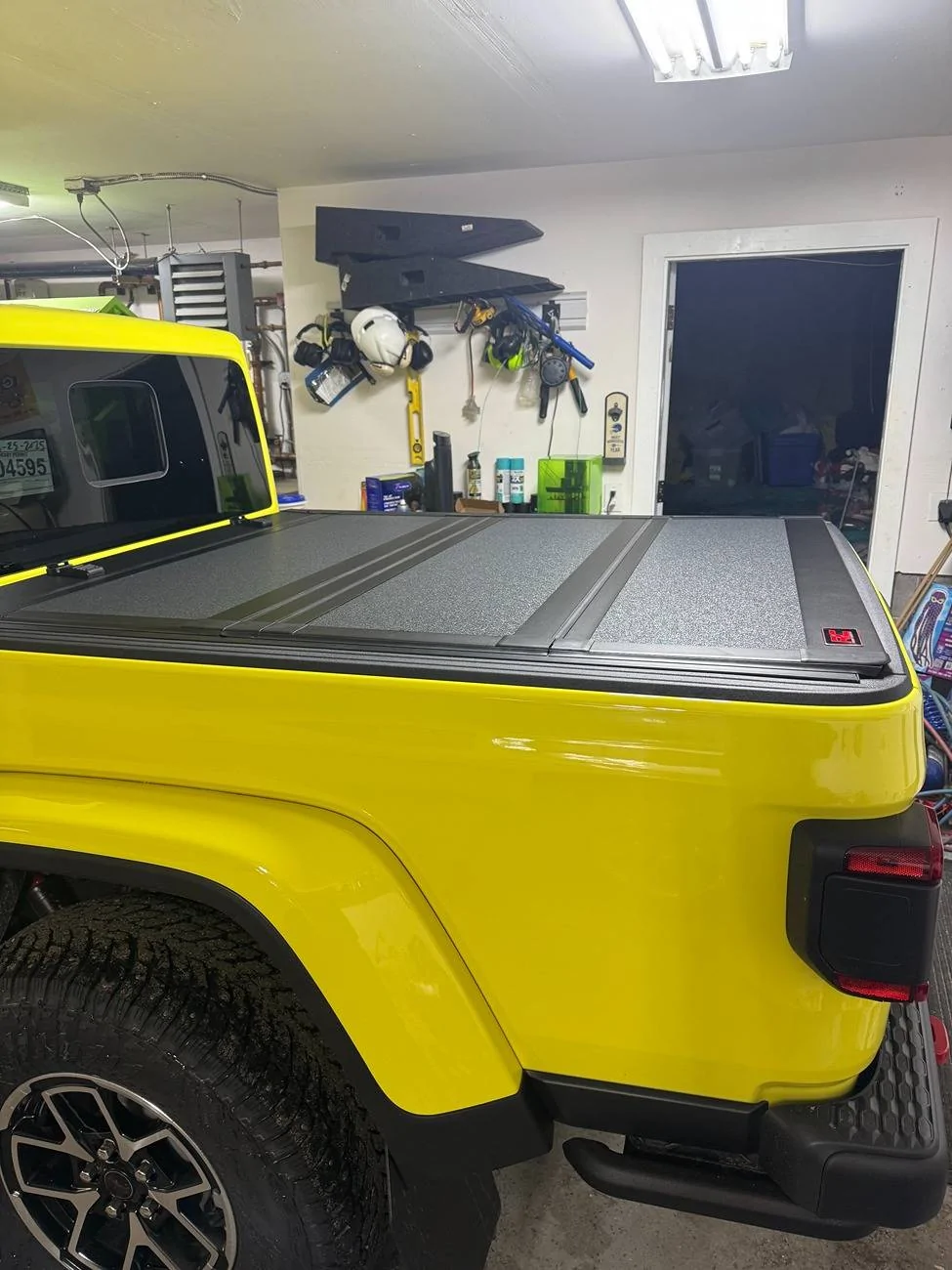

Installed a Rough Country Tri-Fold Tonneau Cover. Pretty impressed with the build quality of the tonneau cover for the price and I am comparing this with BAK brand I have on my other truck. I'll see how this holds up over time, but I would recommend it to folks looking for a hard tri-fold tonneau. Eventually I want to do something different over the bed, maybe a Smartcap, but I can't make up my mind just yet.

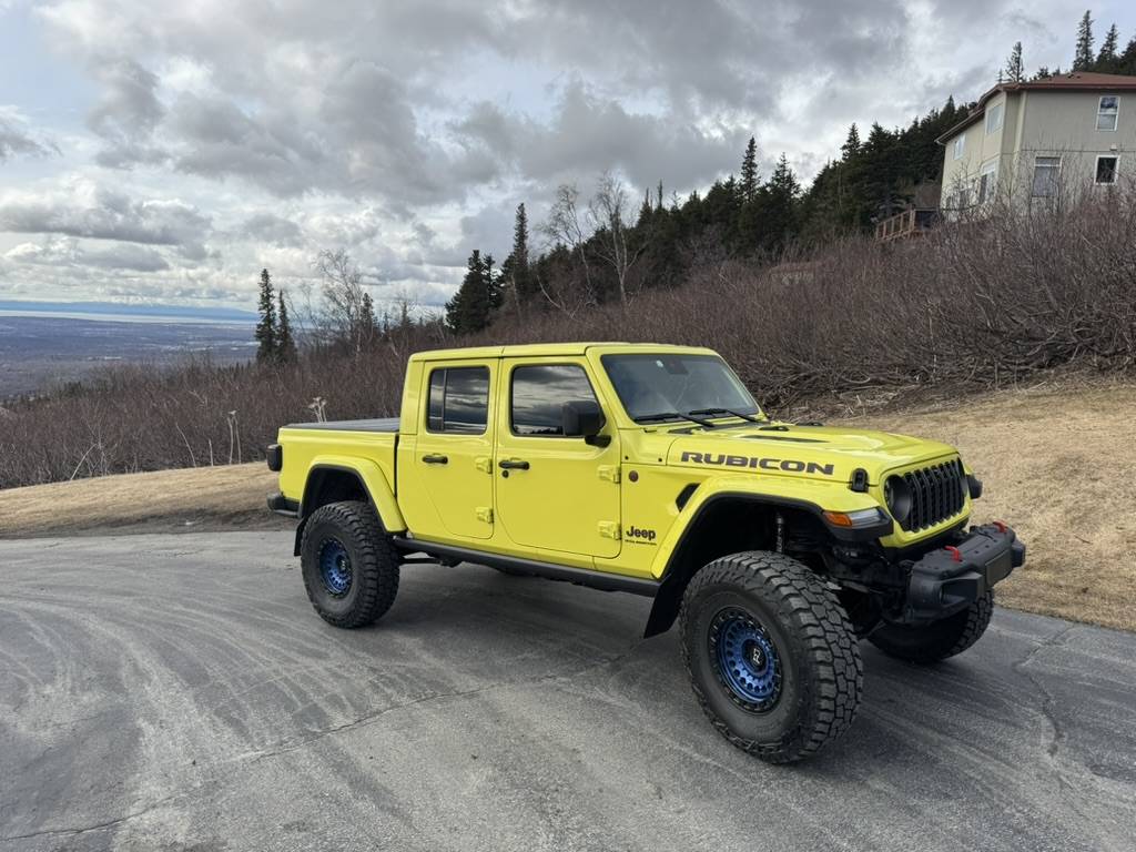

BIG WEEKEND FOR THE GLADIATOR!!!

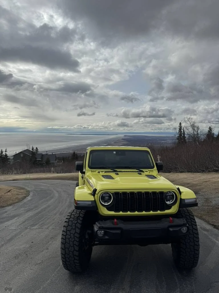

Installed the 4" ReadyLIFT Terrain Flex Max 4-Arm Kit with Falcon 2.1 Shocks https://www.readylift.com/2020-2023...lex-max-4-arm-kit-with-falcon-2-1-shocks.html
I highly underestimated how long it would take to install the lift kit, as it took me almost two full days working off of jack stands. How I wish I had a lift in my garage!!! Install was pretty easy overall and I was able to complete it by myself, except for when I needed someone to stand on the rotor to put the new coil springs in. The kit came with all new Falcon shocks which ride pretty firm, but I don't have much body roll at all with this kit.
Installed a Falcon 2.1 Steering stabilizer at the same time as installing the lift kit:
https://teraflex.com/jl-jt-falcon-nexus-ef-2-1-steering-stabilizer-stock-tie-rod.html?gQT=2
Installed an Adams Front Drive Shaft:
https://www.adamsdriveshaftoffroad....iveshaft-oem-flange-style-extreme-duty-series
Both the steering stabilizer and front drive shaft were extremely easy to install.

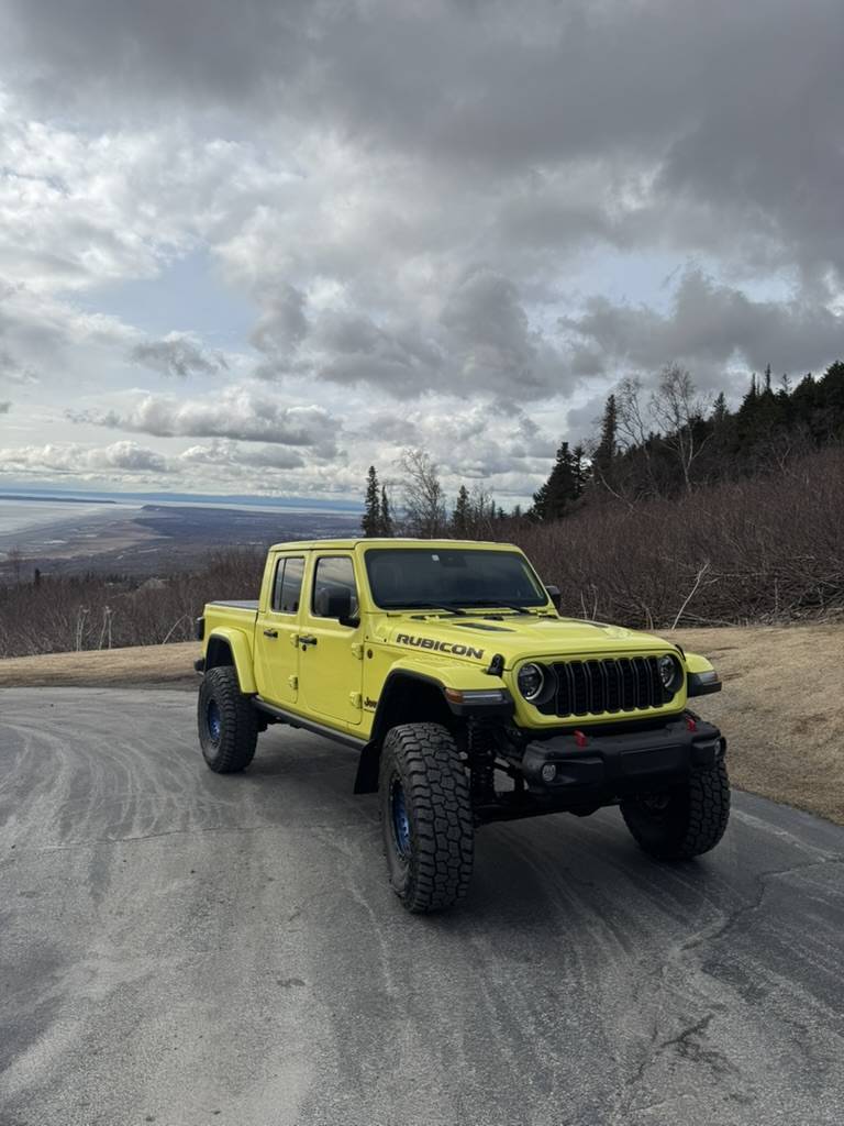

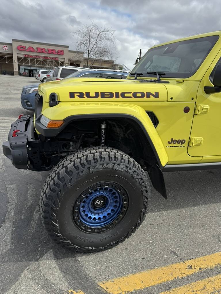

Threw on a new set of 37" Mickey Thompson Baja Boss A/T tires, with Black Rhino Sentinel Wheels this weekend as well.
I think that just about covers the weekend...... I bought a 5th 37" tire for a spare and I need to mount that under the bed and hopefully get it to fit, as I have seen it is doable on the forums here.

Add on to the last post.....
Also installed a Tazer Mini and the extension cables from the computer under the dash.
Everyone should buy one of these and definitely get the extension cables, as it was a giant pain in the ass fitting my hands under the dash to pull out the wiring!
Photo of the new wheels below:
Jeep Gladiator WesleyPipes' Build Thread 1745453122730-dy

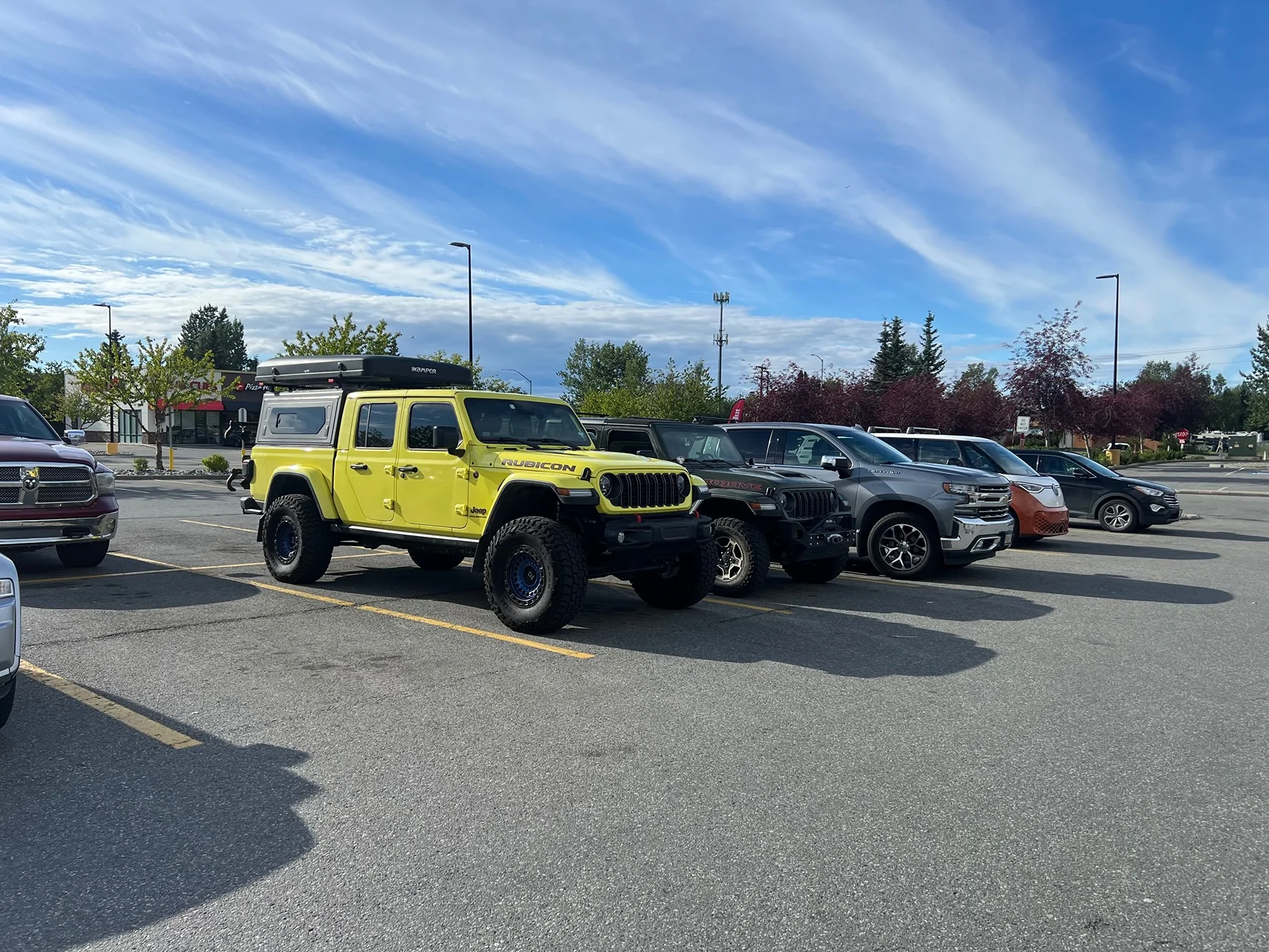

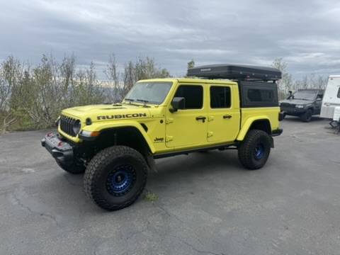

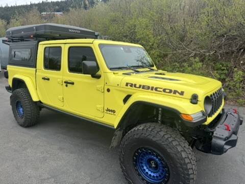

Added an Alu-Cab Contour Canopy Topper to the bed of the Gladiator and took off the Rough Country Tonneau Cover a few weeks ago.
Put the Alu-Cab Contour on myself at the house and it was quite a bit of work to get it moved on there. Just large and awkward.
Also installed my iKamper rooftop tent over the top of the Alu-Cab. Had to move this over from the roof of my Land Cruiser for the install.

I still have to wire up the lights for the Alu-Cab, so I have to do a little searching on the forums for good spots to tie in the lights.
