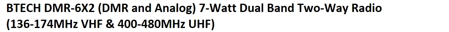

How do these compare with MURS or HAM radios? I want them for family communications in an emergency situation. I'm leaning toward a HAM radio such as the BTECH DMR-6X2 (DMR and Analog) VHF and UHF. I want a handheld unit so I'm not tied to the JT. I would give simpler HAM radios to my family with chargers and instructions, perhaps the Mengshen Baofeng or similar.
I'm just starting the learning process and want maximum range. Your advice would be appreciated!

To give units to your family all members must have a ham license.

MURS is limited to 2 watts and 5 channels.
GMRS handhelds have upto 5 watts and 22 - 30 channels (including repeater inputs.)
For your use I wouldn't recommend ham radios. GMRS would be better and a single license covers your immediate family. You can get both handheld and mobile radios, with mobile radios being capable of up to 50 watts. GMRS is close to the 70cm ham band and with up to 50 watts and repeaters it has very much the same performance and requires little to no programming.
"maximum range" isn't going to come from a handheld radio. You will need a mobile radio with a high gain antenna mounted up high.
