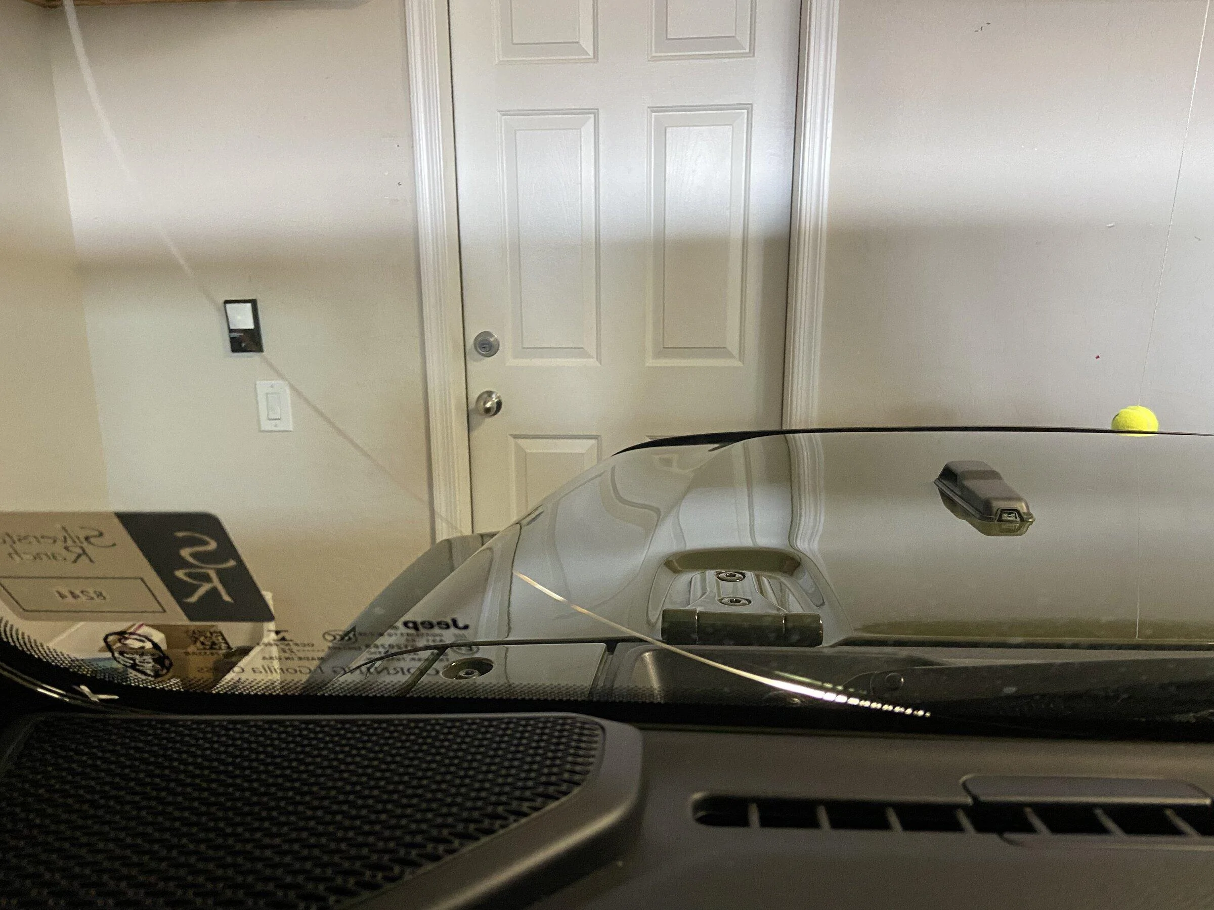

Brand new jeep 8 weeks old, no rock hits on the windshield when driving, No dings, No chips in it. Sits in a garage at work and a garage at home.
Sitting in garage the ENTIRE GG windshield silently cracked ALL the way around in a giant circle. Did not even know it happened until I looked across the windshield. Sent pic to my sales guy and he said he never saw a circle crack like that before. I called the service department and they said to bring it in for pictures to send to FCA for warranty review. We will see if they deny it because the crack is like oohhh the entire diameter of the windshield in length. It seems to be a defect in this case. The entire crack is smooth and you never hit a point where your fingernail catches for a starting point.
HEre is a pic and attached short video of crack

Remind me to never attach anything to the glass.
I'm going to guess that flat panels may flex more than anything with curves or compound curves.
The outer layer is still normal soda lime glass.
But the shape is weird...........
The handle should have nothing to do with it. The windshield can fold forward - totally independent of the handle screwed to the grab handle.
I've seen people push too hard when "gluing" the mirror brackets back onto the windshield years ago. I saw a guy crack one when removing the trim. (before the modern trimless installs)

Went over to Jeep dealer and they took pictures. they ran their fingers over entire circle etc and said they could not feel one rough spot where a rock would hit and noone of the crack touched out to the windshield edge. They said they had never seen anything like it. Guess we will see what FCA says and if they say it is a defect. Hoping so cause then it can be replaced as GG under warranty. Will see,

Got the call today. FCA approved the replacement of the GG windshield under warranty!!! My dealer has been awesome to work with in taking a billion pictures checking every part of the crack and filing a full report to FCA. Guess I got a defective windshield. Dealer said it will be like a week or so for it to come in and then I can go to dealer to get it replaced or they can send someone to me :) Totally happy!
